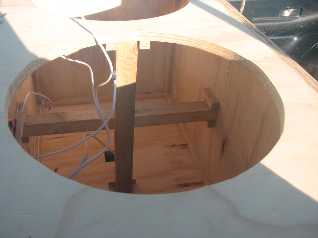

Hi Ricky,
I like to use blind fasteners so I use full cleats on my butt joints versus screws on the outside (except the rear of course). Never had much luck covering screws. When I did do that, I usually pulled the screws and filled the holes after it dried. Far too slow of a process IMHO.
A brad nailer and a couple bar clamps are my friends. Here's the inside of a plywood party speaker I did recently.
Cheers.
MJL21193 said:Excellent tip. I usually fire an inconspicuous brad in here or there.
Yup, that works too. 😉

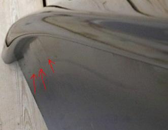

I have used screws, with the correct size pilot hole, and had them telegraph not only through the front, but also the side. Comes through as a bump, the same length as the screw.
This is hard to discribe, and I tried to get a picture of it, but as usual my camera won't capture it. REALLY shows on a gloss finish.
For me, if glue won't hold it, I'm not doing it.
Here's a pic might show what I'm talking about:

MJL21193 said:...Comes through as a bump, the same length as the screw.
This is hard to discribe, and I tried to get a picture of it, but as usual my camera won't capture it. REALLY shows on a gloss finish....
Yea, MDF is very prone to splitting or showing screws if they're anywhere near the edge. If I absolutely need to use screws I'll try to clamp two flat pieces of material either side of the panel being screwed (parallel to the screw path). This sometimes helps.
