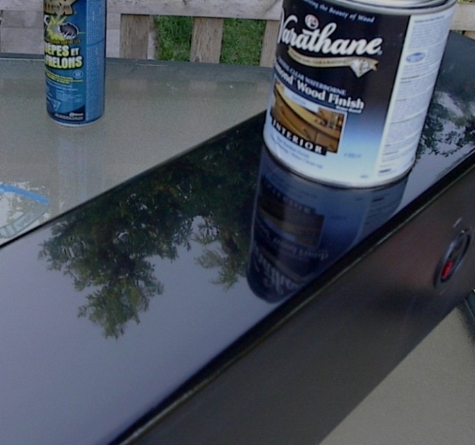

Last night, like an impatient child, I went out out and sprayed some onto the orginal surround speaker box pictured in the thread I posted.
Admittedly, this is not my finest work (box is made from cheap plywood). It's original finish is 10+ coats of flat alkyd paint - it looked ok.
I sanded this as smooth as I could with 2000, then sprayed on a single coat of the water based poly. In the can, it looks milky. On black, it looks purple-blue. In my haste, I didn't strain, and there was a little crud that spat out. Overall though, a very even thickish coat.
It doesn't dry as fast as I remembered when sprayed. I left it alone to dry.
tonight I have looked to see that it's dry and looks ok. I take a chance and decide to try to polish it. Remember, it's only one coat. Sanding is once again long, it's hard after only 24 hours.
It polishes very well, not long at all to clear all of the scratches.
My concerns about it's ability to "liquify" the surface are justified - from a distance,it looks wet and glossy, very reflective. But under close examination, the paint underneath appears dull, not deep black. The paint is flat to begin with though. Maybe if applied over a gloss finish, results would improve.

That looks good to me John. We're always are own biggest critiques so I'll take your bad points with a pinch of salt. 😀
At least in the photo's the Varithane doesn't quite have that same contrasty wet look as my current clear. If your able to sand after just 24 hours then that's certainly faster drying than the 1k clear I use.
When you lifted the paint can up that you've got in the shots, did you have any tiny depressions in the paint? I'm just trying to assess just how quickly it hardens. I note that you only did a single coat and multiple coats will slow down this process.
Does getting water on the finish tarnish it anyway? I'm thinking along the lines of if you spill thinner on a celly finish then you'd have a problem.

Hi Ant,
The can made no dents. It's very hard - harder than one coat of solvent poly would be after 24 hours. It took a lot of sanding to flatten, and didn't come close to cutting through.
It's not affected by water after it's dry. A wet glass will not make a white ring on it.
The first time I used the waterbased Varathane was on an oak bookcase that I built in 1987. The finish still looks great after 20 years of use.
I think it has great potential, just need to overcome the base prep problem. Maybe a complete polish on the base before the clear? double the work, but could be worth it.
Another possibility is if it can be coloured instead of clear. I'll have to look for that.
