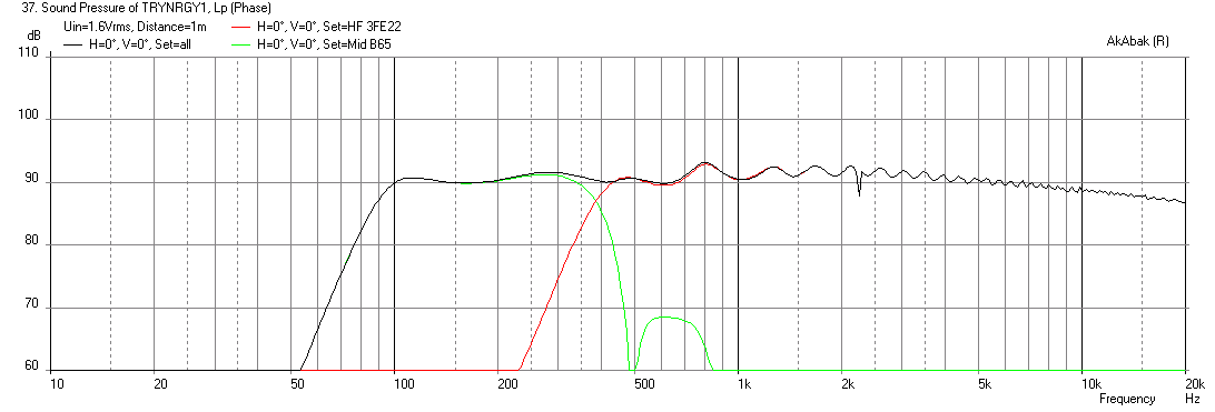

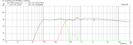

New Time Alignment
Thanks to Legis for pointing out that I had the mid woofers firing before the full range driver - I got the delay applied on the wrong driver. Anyhow, I did the usual play a tone at XO freq and adjusted delay on inverted phase of the fullrange until minimized, then flipped back. In this case, normal is inverted phase for the fullrange. The delay on the mid woofer ended up at 1.24ms. The step response is no longer negative and excess group delay ends up at 2.43ms at 100Hz. Measurement is at 5in from exit plane of horn and with -32dB fullscale amplitude in REW driving the miniDSP. Measurements on horn no. 2, no. 1 is very similar.
XO setting:
439530d1411271851-presenting-trynergy-full-range-tractrix-synergy-trynergy-no2-xo-24db-b.png

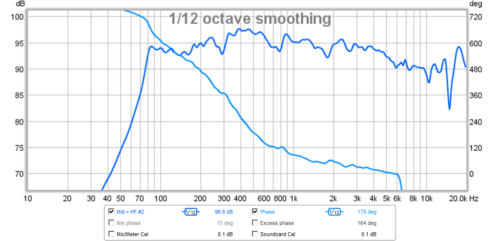

SPL & True Phase (unwrapped):

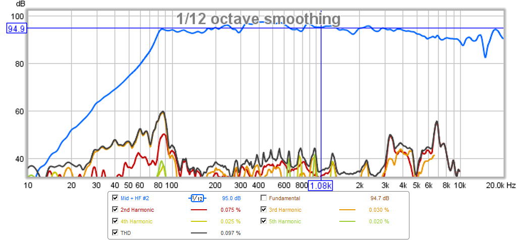

Harmonic Distortion (HD):
439532d1411271851-presenting-trynergy-full-range-tractrix-synergy-trynergy-no2-hd-b.png

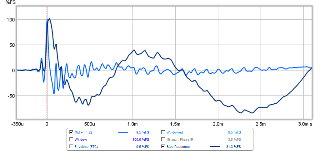

Impulse Response (IR) and Step Response (SR):

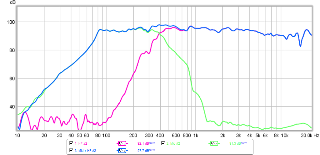

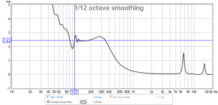

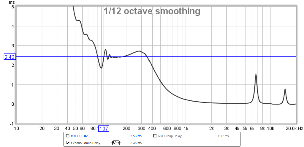

Excess Group Delay (EGD):
439534d1411271851-presenting-trynergy-full-range-tractrix-synergy-trynergy-no2-gd-b.png

I have 24dB (4th order) on the low pass of the woofer and high pass of the fullrange. The woofer has a 12dB (2nd order) on the high pass filter. Is it the EGD that I can get to be lower than 2.43ms at 100Hz if I switch to lower order and reduce overall phase shift? What is your phase shift from 100Hz to 10kHz range?

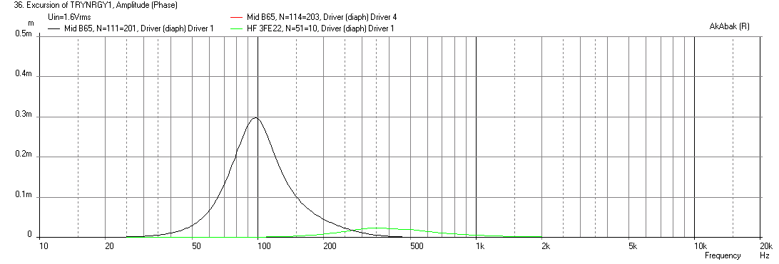

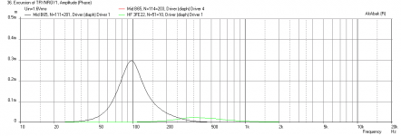

Here is the predicted cone displacement for both the woofer and the 3FE22 at 90dB. The displacement on the 3FE22 is only 23um!

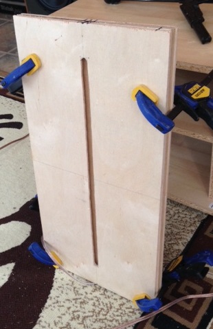

Ok, so I finally managed to get some time to work on the first Trynergy of mine today! Fortunately my oldest (nearly 3 years old) daughter wanted to spend time with me, in a way that I could still do stuff! I felt very fortunate!
I glued the top panel on around Tuesday of last week, so today I started to work on the ports. This is what I found:
If you are 3 inches (as xrk791 suggested) inside the front edge of the speaker, the corner of the port shape will be placed around 7.25". The other corner of the port shape appears to land at around 8.25". At some point I'm going to take the curve template xrk971 provided, and match the port to it graphically, and post the result here. That would allow for the top and bottom panels to be pre-cut, before gluing the curved sides, which makes it a lot more difficult in terms of cutting the ports.
Here are the ports cut out:
Earlier in this thread I incorrectly stated that the thickness of the plywood I'm using is 3/8". It's actually 1/8". So, to combine a layer of damping and to increase the 'chamber' thickness between the driver and the port, I made use of some 7/16" OSB that I had left over from the T18s I've built. Can you tell that I'm a person who likes form over function? 😉
Here is the OSB layer being glued on to one side (I ran out of clamps to do the second this evening). Note the 'seam' in the middle - I miscalculated the original spacing between the drivers, so I had to chop half an inch out of the board.
I hope to get the other side glued up tomorrow, and also fashion the mount for the mid-high frequency driver so I can see what it sounds like!
Hi X, I get 100Hz - >10kHz around 270deg phase shift total my my setting (only 2nd order high pass for the comp, no LPF or HPF for the mids). It does not change if I apply a 1st order LP filter for the mids.
Yes, lower order filters can//will generate less EGD and phase shift in general.

A word of caution for first sound so you don't get discouraged: it won't sound right without EQ.
It may sound unpleasant due to the very exaggerated mids of the 3FE25 having a sensitivity of around 108dB vs the 96dB sensitivity of the woofers in series-parallel. You will have to apply the following EQ at minimum to balance the sound: low shelf of -10dB @4kHz 0.5Q, high shelf +3dB @3kHz 0.5Q. The woofers don't need any EQ. I used a 24dB/oct @375Hz XO and a 12dB/oct @90Hz HPF on the woofers. You will need to experiment with time delays but I found that the fullrange will need about 1.24ms delay relative to woofers and the fullrange polarity needs to be reversed.
With the above basic settings it should sound close. The rest is just cutting any nasty peaks or filling gently some dips circa 700Hz and 3kHz if you find any.
It may be a bit different since you have a 3FE25 and I am using 3FE22 but they are similar.
That is amazing that you can get away with a single 2nd order high pass! I should try running the woofers full range and see what happens. I can also run the HF full range driver with a 12dB/oct high pass - I don't think excursion will be an issue. Right now the peak excursion at 90dB with 24dB high pass is 23 microns for 90dB SPL. Which which explains why they don't feel like they are moving at all. Are you using any PEQ's at all to balance the curves or cut peaks/etc? Sounds like to are not whereas I am using those too and I guess each PEQ adds another pole of delay?
I also think it is cool. If the unfiltered upper end response of the mids are ragged, then they might be better of with 1st or 2nd order filter.

Mids do not have eny PEQ filters, they are 100% "raw".
2446J has 5dB high shelf (0,5Q/6kHz) to bring up the HF to balanced sound. There is no resonances/peaks that need EQ'ing/notch'ing. I might try doing the filtering and HF boost with one stroke, using 1-2khz 1st order HPF, to bring down the MF. Then I could omit the PEQ HF boost/high shelf filter completely. With passive approach it would be very adviceable to do it that way, but with active, not so important imo. But to think, 2-way passive xo'ed synergy with only high pass condensator for the comp driver, how ridiculous! 😀
All in all, I think I got VERY lucky.

The OSB layer for the second side is now gluing up, so now I've just got to wait for that to cure! I'm hoping with the weather it'll be 4 hours, but the rain might have slowed things down a bit. Hopefully the randomness of the OSB will allow for some damping just by its nature.
The glue I'm using is Loctite PL Premium, as it's what I had left over from building the T18 subs, which cures as a hard material. It might be flexible, but given that it's a construction glue it probably isn't by much 😉
I haven't touched the curved sides yet, but I'm still planning on using braces and hopefully end up with a speaker cabinet that is a cube (hence why I was enquiring about the rear chambers, so that I could fit them into that design), which can sit in a corner and not bother anyone unless I tell them to 🙂
