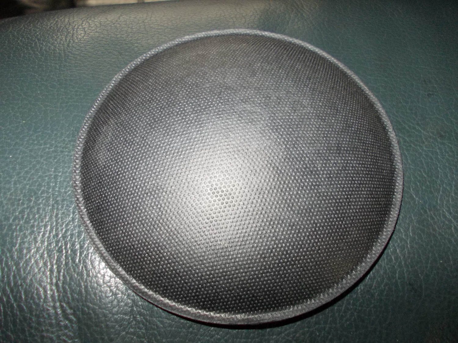

After some time I have now on sunday not so much to do, so I did think about the enclosed room before the bass speaker.
To make that room 50 procent smaller I did order dustcaps for the woofers, I do use fiber under the cap to fill room, and re-measure the woofer if my amp for that is ready.
I do not now what will happen.
regards
kees

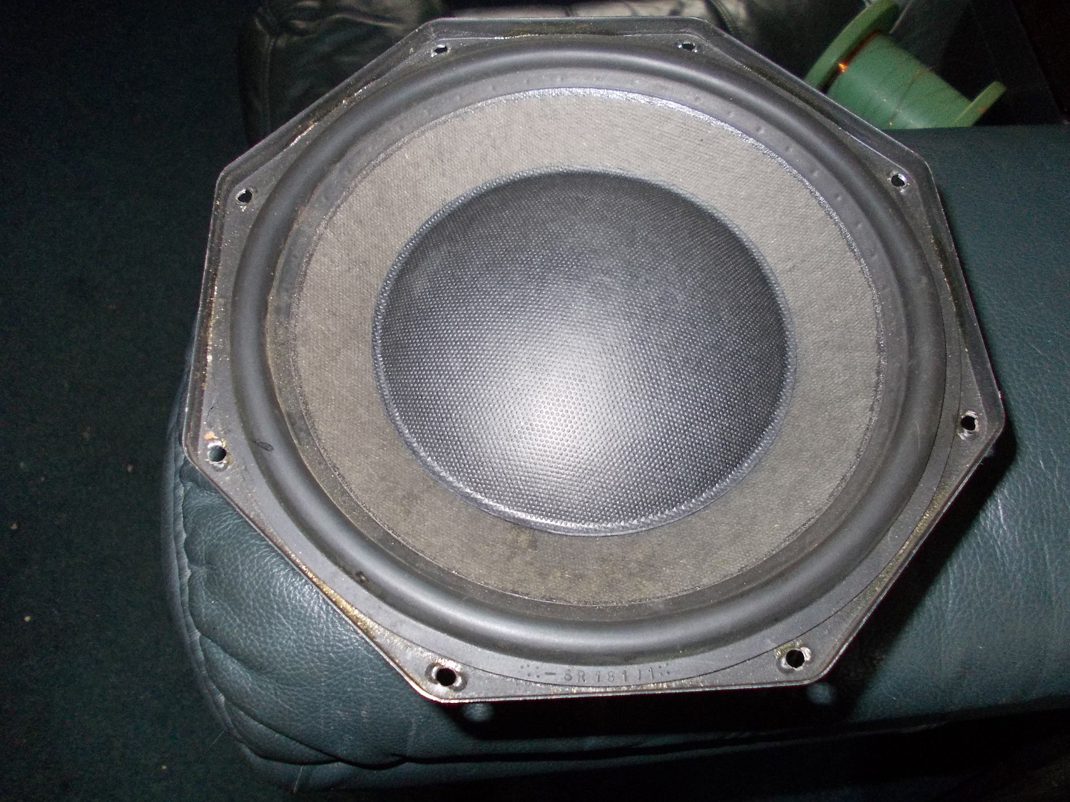

Kees,
I never thought about doing this with a dust cap. You are changing the TS params by adding mass though. We are running into a situation in this thread and may have to build an inverse cone form to take up volume. Right now volume of B&C 10CL51 is 850 CC and it needs to go down to 450 cc.

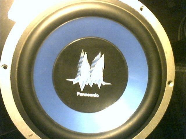

Indeed when you ad mass like the dust cone it will get higher qts, because of more mass, but the cones are very light and strong, remeasure the speaker will get more info, when a woofer with a big motor I think not much wil be changed.
just try it, the volume of cone is sometime a problem, there are woofers with inversed cones who are really flat because of that, like auto woofers.
A cone cap need to be strong a inverted one is more strong then what I have.
For yours problem, use a dustcone inverted? a big one just a cm below the rubber, like with much auto woofers. see example.

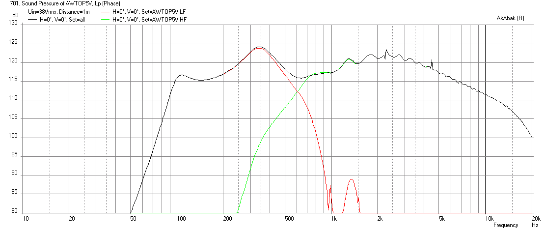

Over in the Synergy TripP 10in thread, I came up with a design using a conical horn with a pair of TB W5-876SE's and a FaitalPro 3FE22 for the full range. It appears to be a decent performer on paper with max SPL of 116dB. This may be of interest to folks who want a constant directivity horn that uses flat panels for standard plywood construction vs having to cut a curved tractrix panel.
More info here:
http://www.diyaudio.com/forums/multi-way/262838-synergy-tripp-10-a-13.html#post4083447
Here is the response at xmax (note that this will be subject to the native cone breakup of the full range driver around 9-12kHz):
