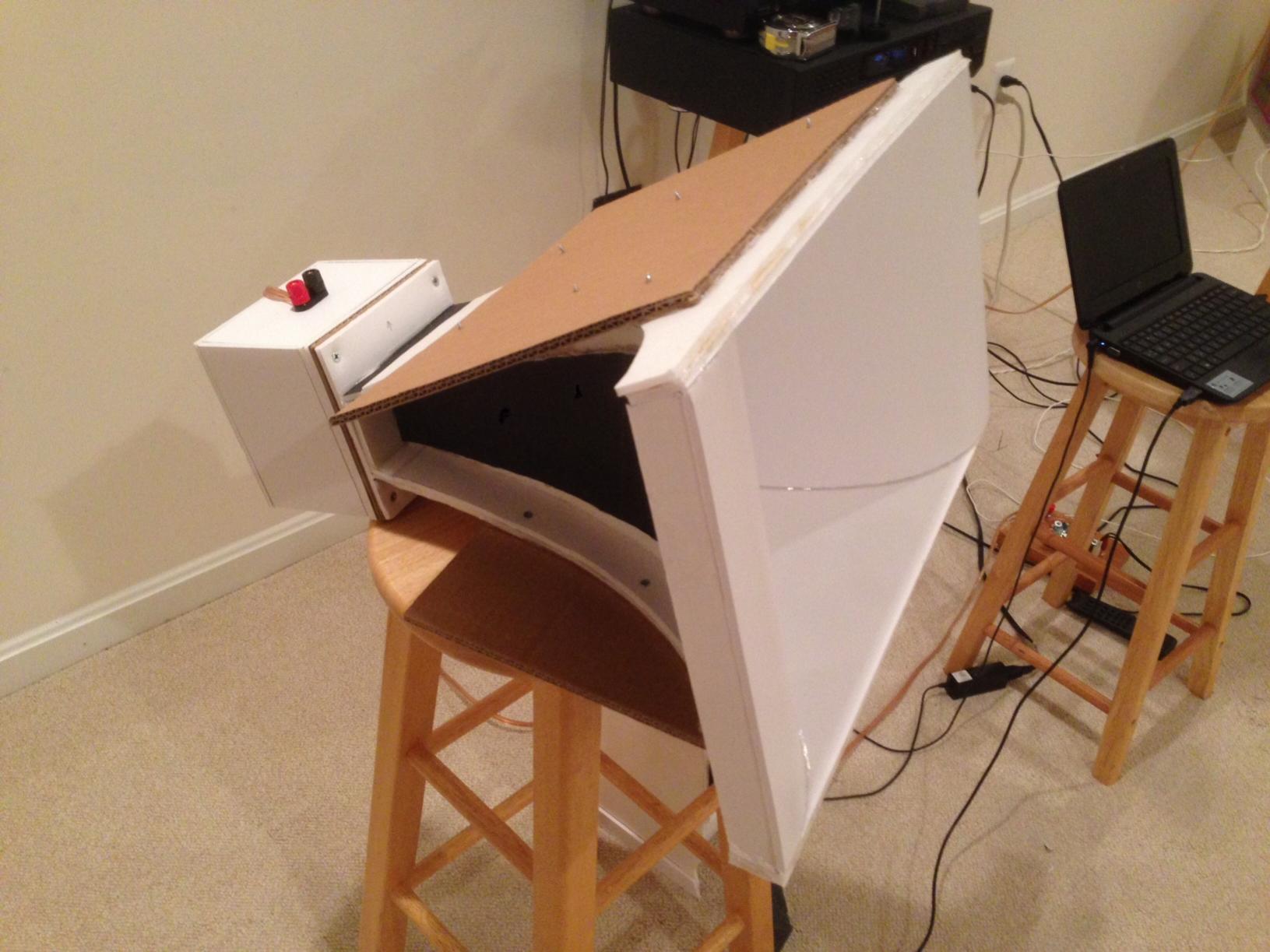

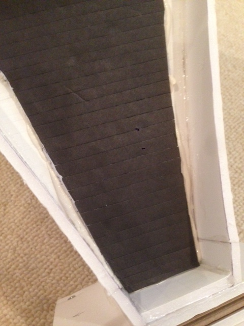

Installed CLD and woofer mounting plate

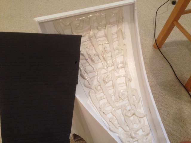

I found a non VOC liquid nails (latex based) and used that instead of caulking. Very important to use non VOC latex liquid nails as the fast drying VOC based one (flammable vapors) will melt the foam in between the paper faces. Now let the thing dry for a few days before cutting the port holes for the woofers.
Liberal dose of latex liquid nails:
Closeup of CLD top cover with thin cuts to follow curve:
Final horn with CLD and woofer mounting plate (triple layer corrugated cardboard) held on with latex liquid nails and screws:
I always listen to music through the horn as I apply the CLD and can notice that the sound gets cleaner and louder as it is applied. As the latex hardens it improves with hardening from liquid to flexible solid.

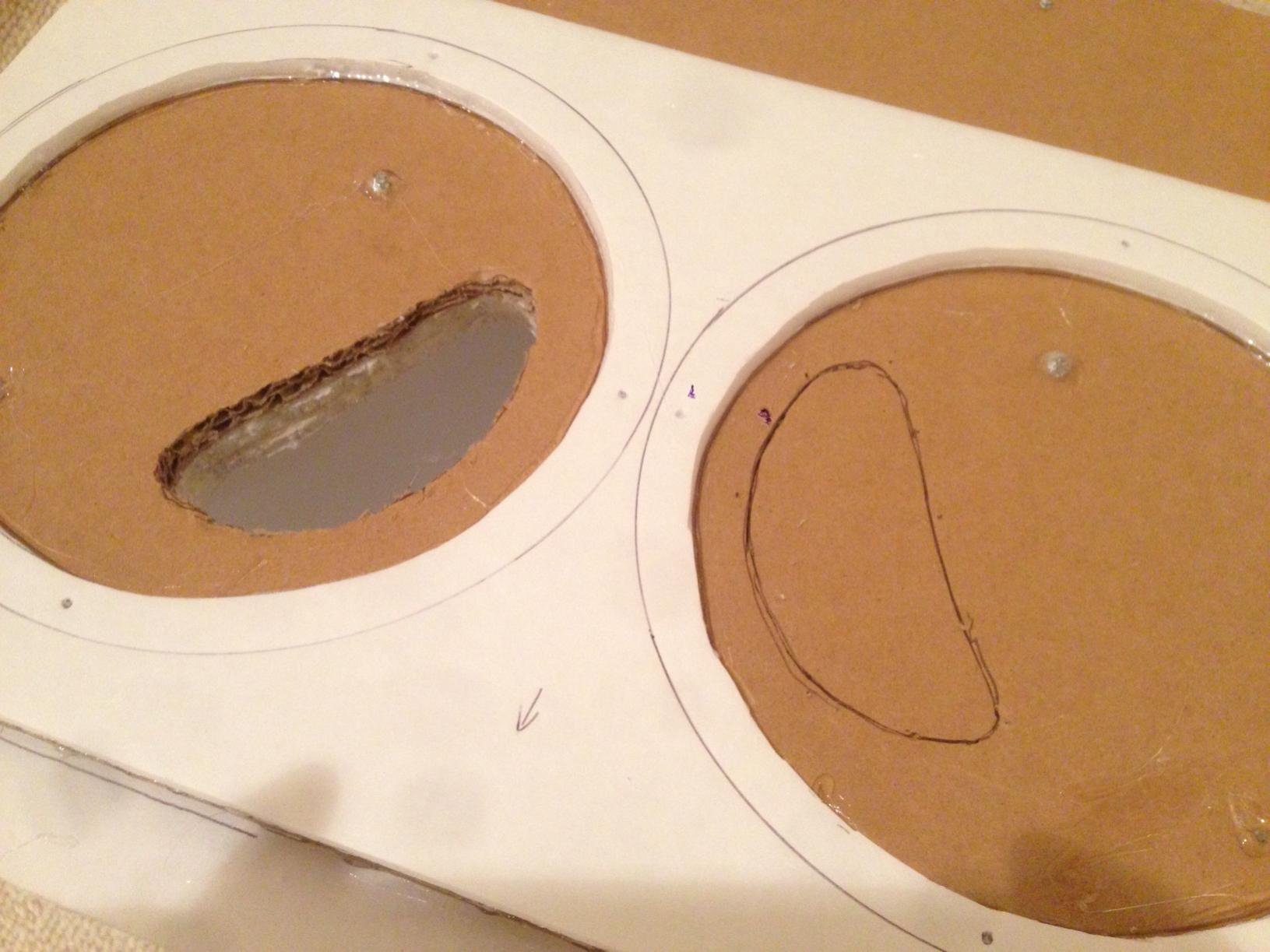

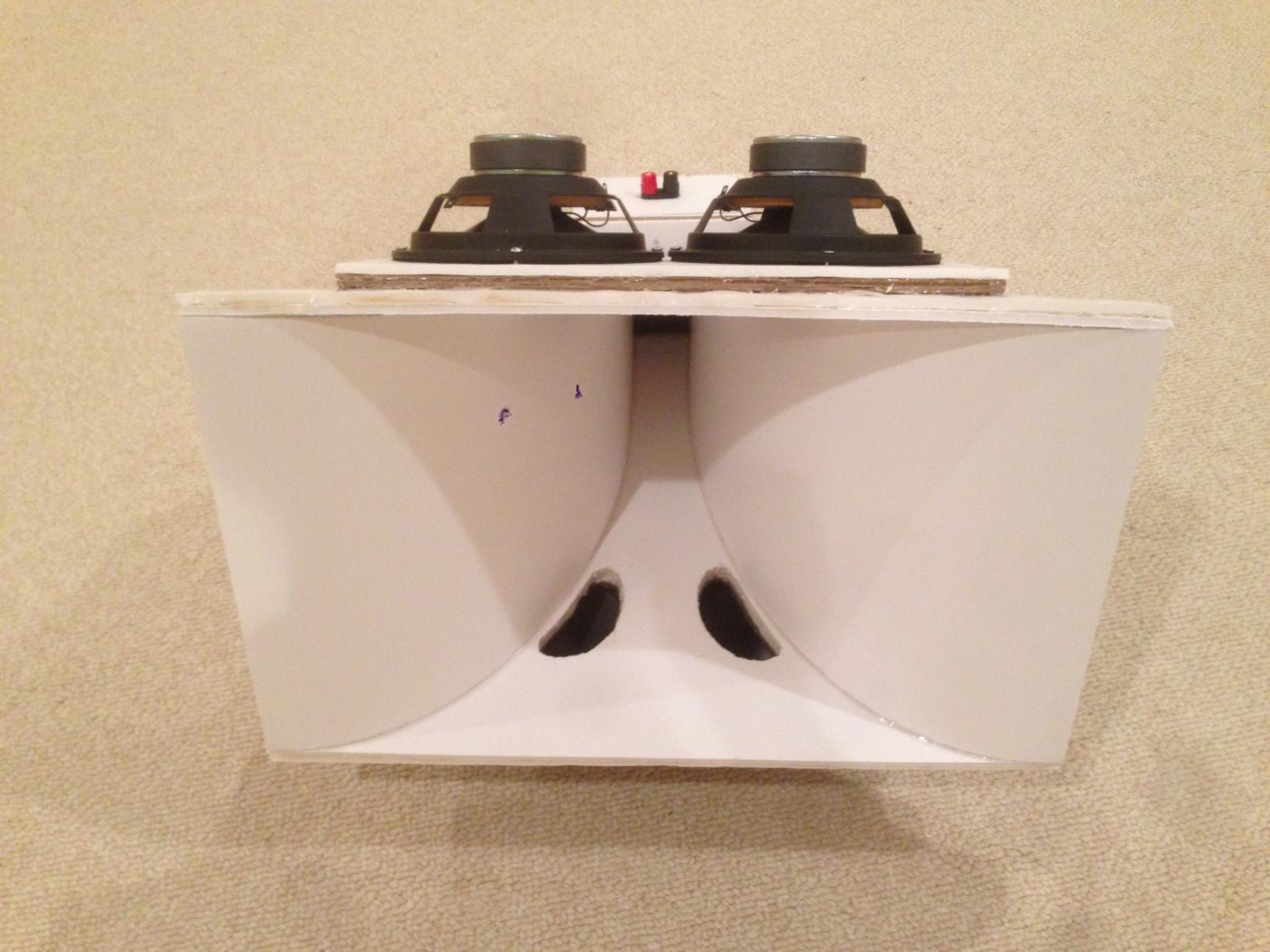

Cutout Bass Injection Ports and Installed Woofers
I used a template from unit 1 to transfer the kidney shaped injection ports. This higher quality foam core board was a lot more difficult to cut through. You can see the foam core spacer sheet used to provide clearance for the rubber surrounds from hitting the driver mounting plate.
Cutting out injection ports:

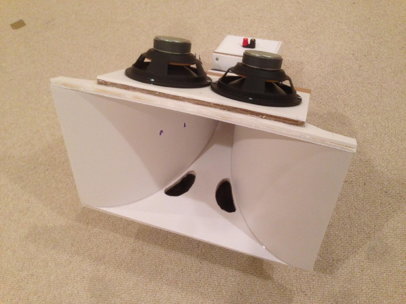

Finished with woofers installed:
Front view of Trynergy with four PE buyout 6.5 inch woofers installed:
I still need to build a couple of sealed enclosures to cover the woofers...

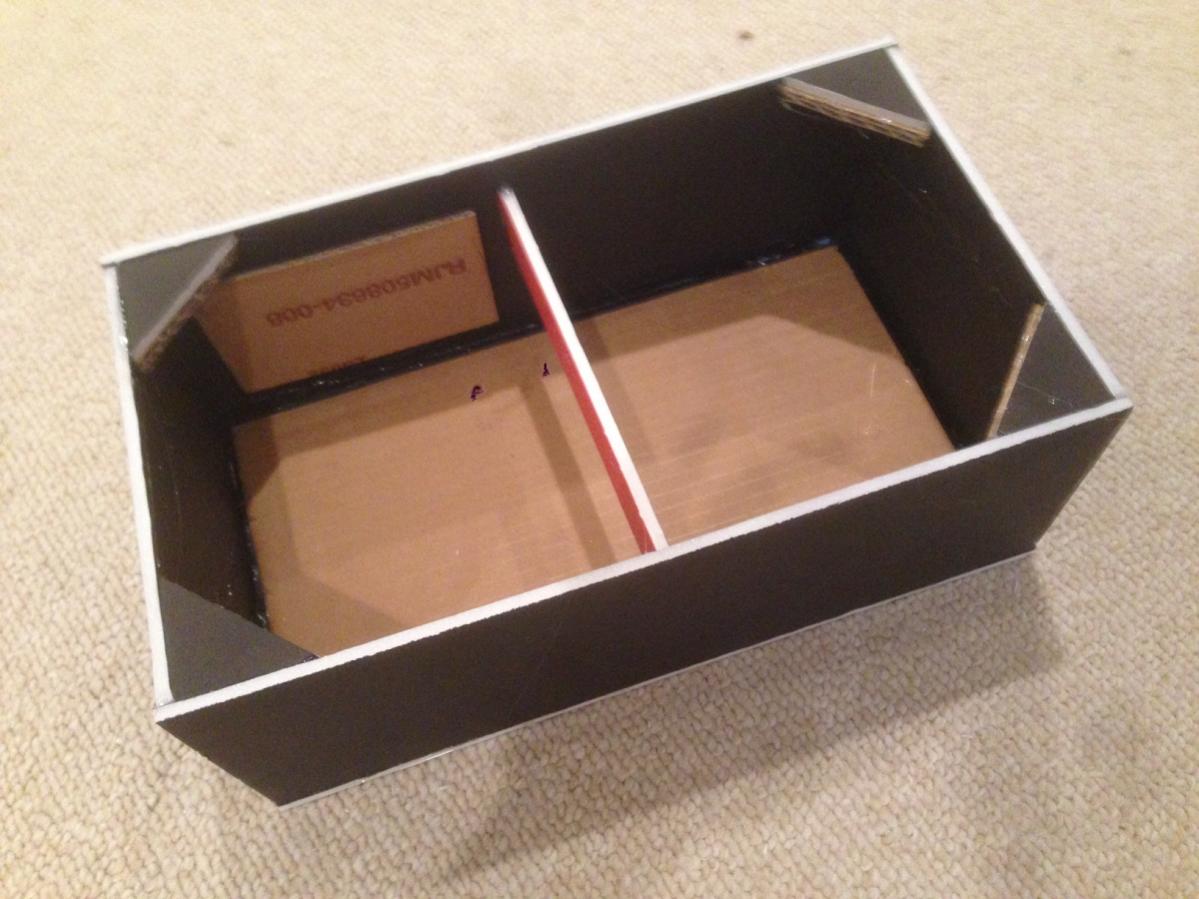

Rear chamber enclosures for woofers made

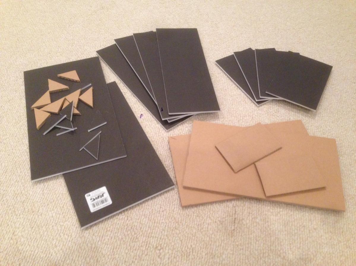

That's a lot of little pieces to cut and glue, now you know why I hate making prismatic boxes. They are done at least and lined with foam. Still need to install binding posts and connect wires to drivers with crimped quick connects. Boxes are 14 in wide x 8 in deep x 5 in tall.
All pieces cut and ready for gluing (2 sets):

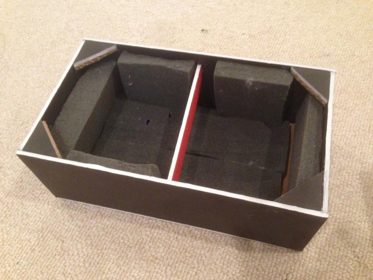

Completed box prior to foam installation:
Grey open cell foam now installed:
I did this for two boxes.
