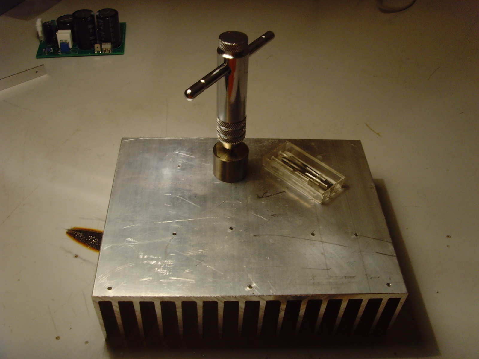

Indeed my intention is to stack the sinks vertically to optimise the airflow - 2 per channel. The PCB will be mounted vertically onto the sink with power input at the bottom and signal in/out towards the top.

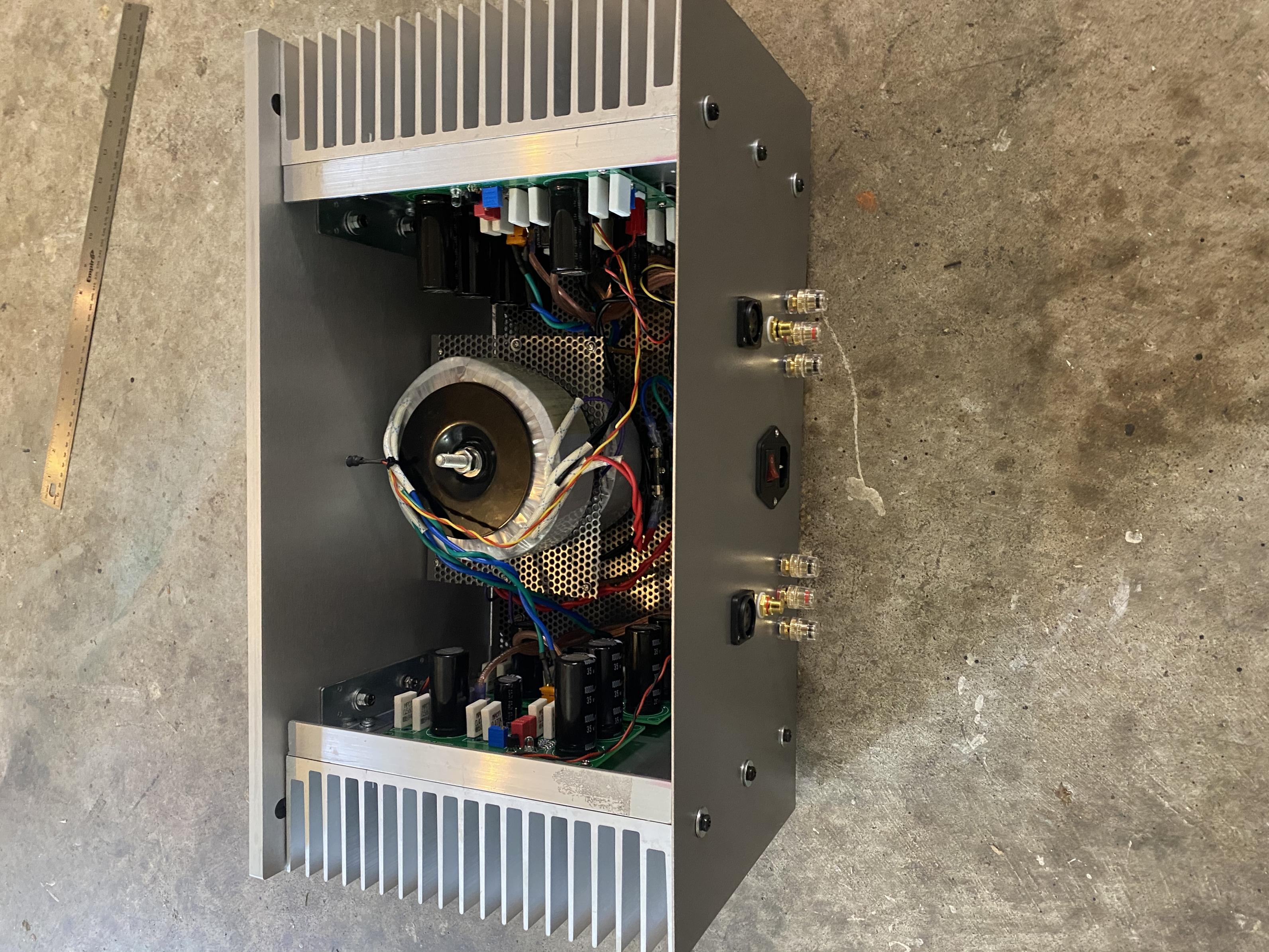

I just finished the below amp a couple hours ago. 4 total boards and set up to run balanced XLR or parallel. Sounds awesome and is dead silent!

On my boards I’m using the parts Tungsten Audio recommended (Nichicon Fine Gold 4700uf and Organic Polymer caps). As for resistors, on my first amps I built I tried to use Dale RN65 resistors but they were large and hard to fit. On this amp I used all Vishal Beyschlag resistors and they were small enough to fit the boards perfectly and still sound nice. As for Mosfets I used IRFP240s.
Thank you, so you are not using IRFP140s and retained the IRFP9240 or 9140? Looking at your pic I presume you are using the on-board bridge rectifier on each of the amp module. Also what about the biasing resistors of 3W?
Not the 9240. Irfp240. Rudi recommends the 5 watt MPC71 or MPC74 resistors. I was able to source the .22 and .47 ohm resistors locally but had to buy the .56 ohm online.

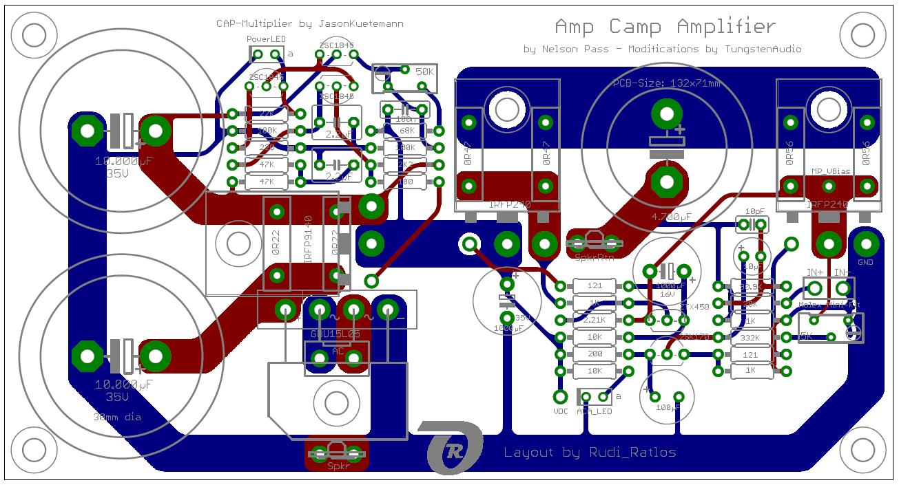

I have 3 pairs of "my ACA with Premium Parts" (slight modifications on the original ACA done by TungstenAudio; CapMx Multiplier - PSU on the PCB) left.
I expect to them in my hands in about 2 weeks.
The price for a pair of PCBs incl. shipping (registered mail with tracking ID) and PAYPAL-fee is 20€.
Give me a PM if you are interested.
Best regards - Rudi

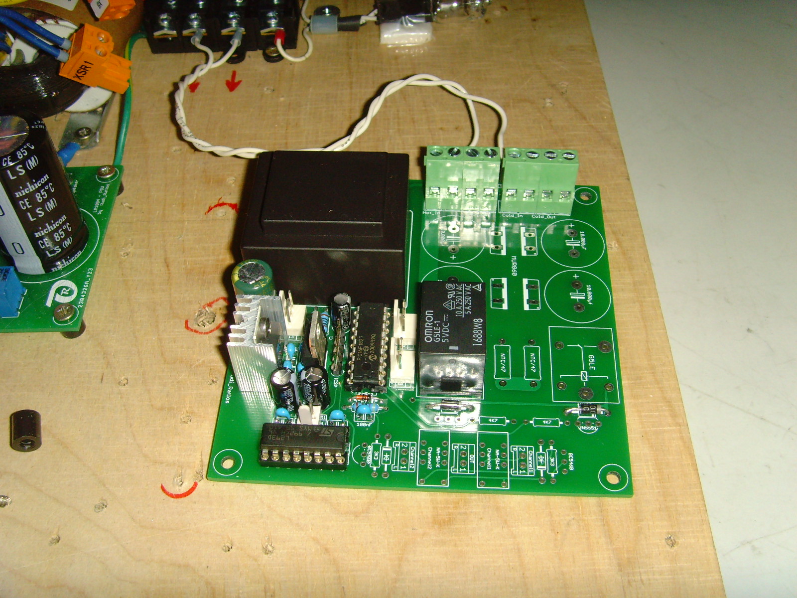

P.S.: The 3rd image is showing the prototype of a small "PRE" that I will use together with my own ACA.
The functions of the PRE are: Soft-Power-On, Mains DC Removal, Volume Attenuation (done by remote control and motorized potentiometer),
Signal-Source-Selection, Temperature Sensor, ...
The heart of the PRE is a Microchip 8 Bit µP PIC16F1827.
I have "some" experience with defining projects in MPLAB, programming in "C" and programming the µP via a PICKIT2,
but this time I want to change to MPLAB X and to the XC8 C compiler.
If there is somebody that likes this project and has time and is interested to join it: I will send him a PCB - for nothing of course.

This is the list of prospective buyers:
sthcoaster - 2 PCBs
OtisCampbell - 2 PCBs
angchuck - 2 PCBs
I will order 10 PCBs (I will keep 1 pair for my own, so 1 pair is avilable), as soon as you three have paid me.
The price for a pair of PCBs incl. tracked shipping is 20€.
My PAYPAL-ID is: RRozek@t-online.de
Best regards - Rudi
P.S.: Which PCB-colour do you prefer? Red or green?
