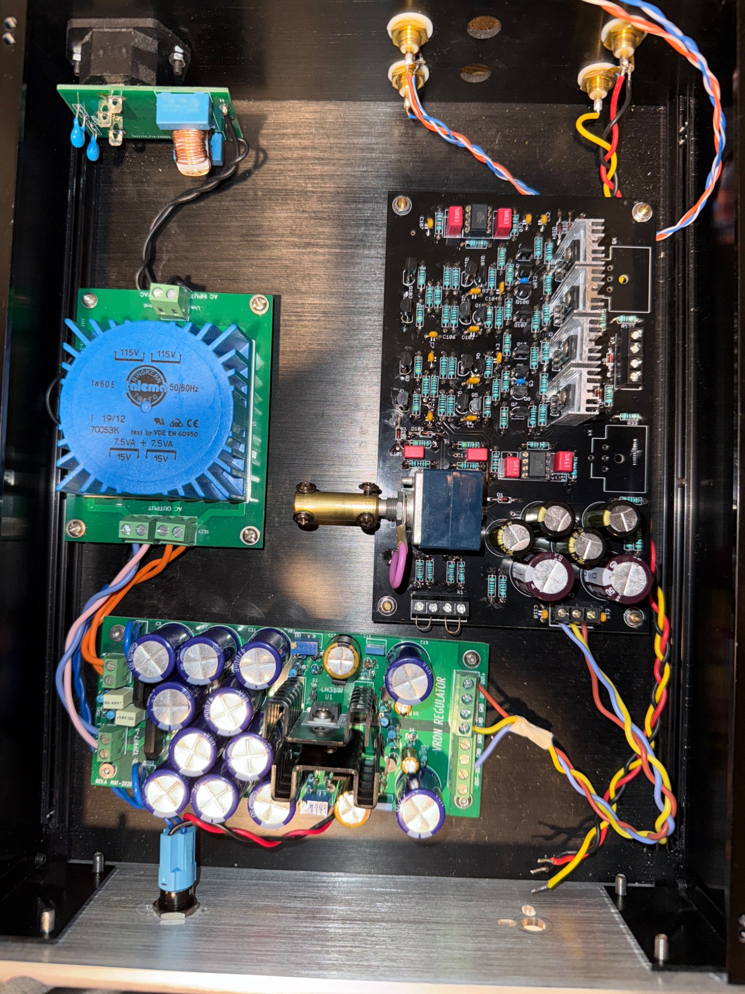

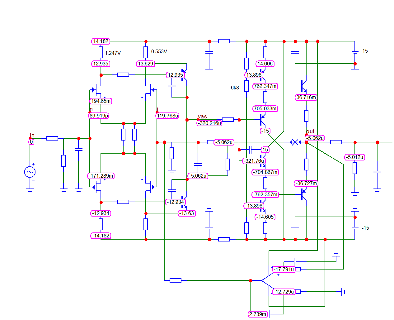

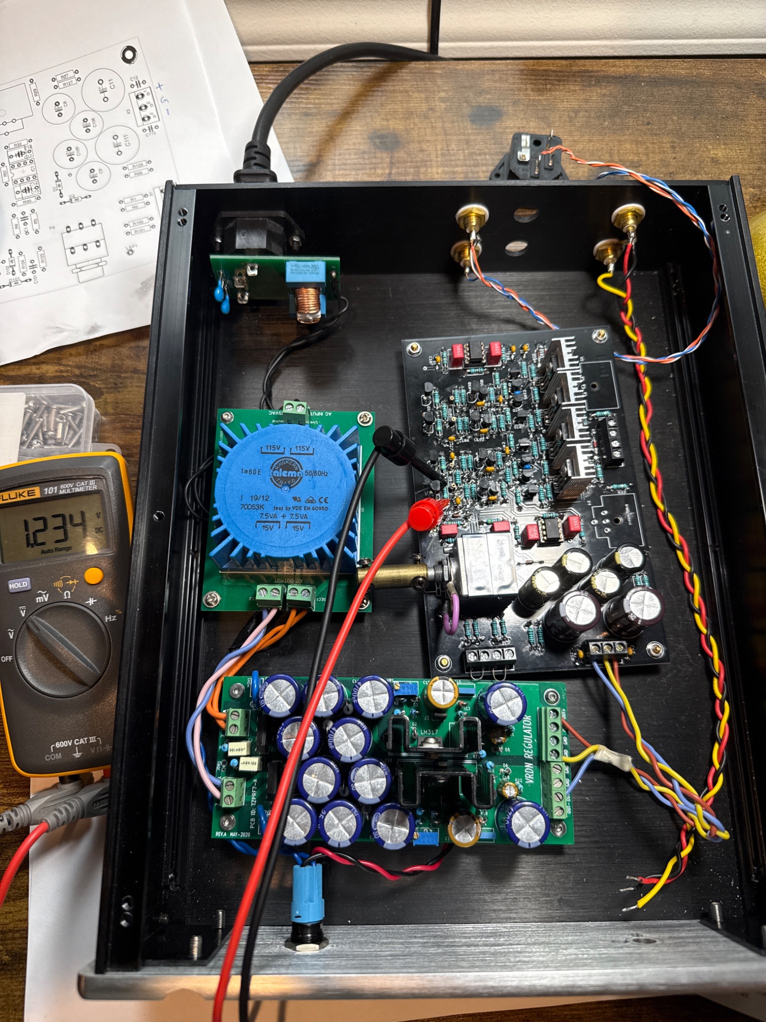

Here are my readings so far with inputs shorted to ground
Power Talema 15vac trafo then paired with VRDN psu for +15V/-15V
R6 - 865mv
R11 - 866mv
R106 - 779mv
R111 - 780mv
Voltage divided by 2.7ohm shown in ( )
R24 - 56mv (20.7mA)
R25 - 57mv (21.11mA)
R124 - 49mv (18.14mA)
R125 - 49mv (18.14mA)
R5 - 1.510v
R10 - 1.496v
R105 - 1.428v
R110 - 1.423v
R6 - 865mv
R11 - 866mv
R106 - 779mv
R111 - 780mv
R24 - 56mv (20.7mA)
R5 - 1.510v
R10 - 1.496v
R105 - 1.428v
R110 - 1.423v
Currently I am using R9/109 as 270R and what do you suggest based on my above readings to change this value to?It should be OK. You may tune Q1- Q4 current by R9/109.
R1,101 used 8k2 and R2,102 used 2k7 per the BOM suggestion.

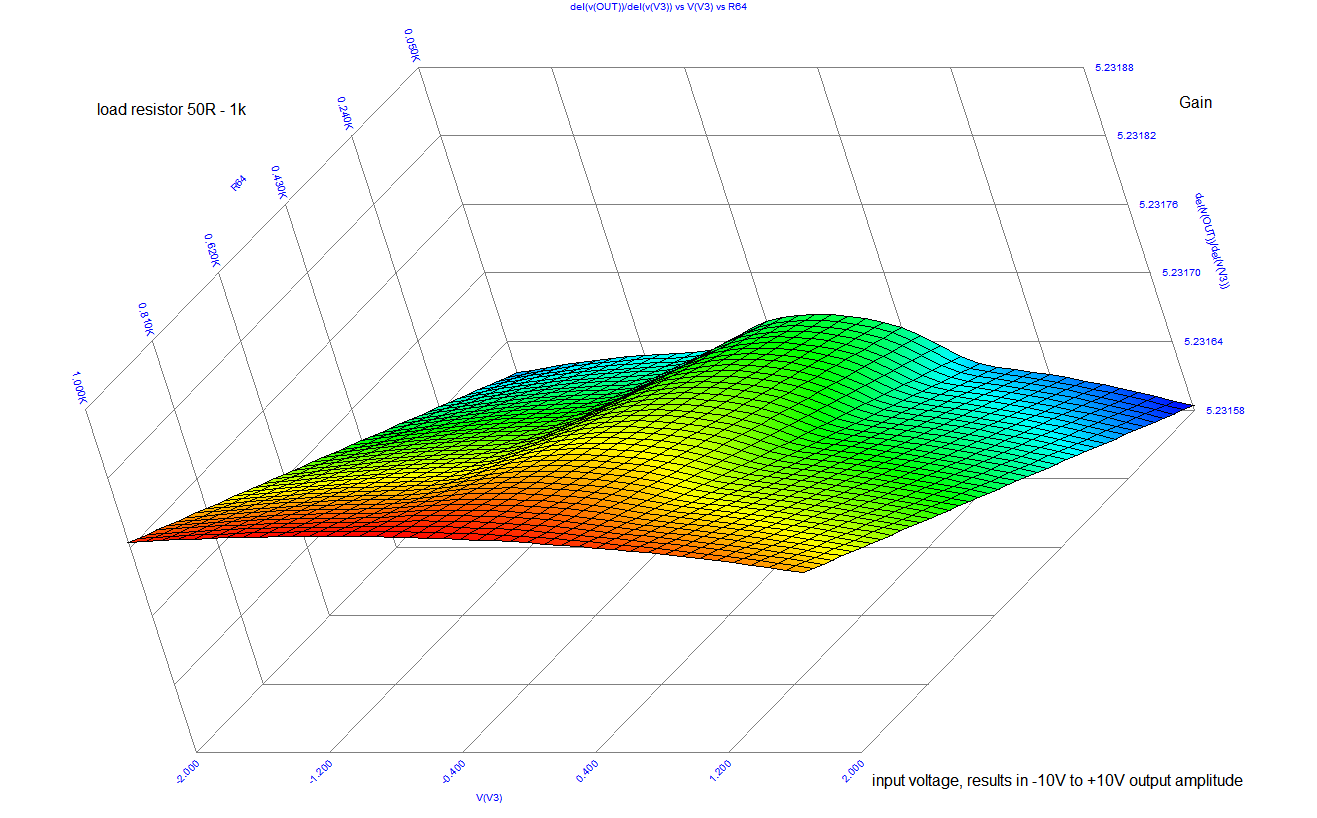

Gain linearity with respect to input voltage (+/-2V which corresponds to +/-10V output) and load resistance from 50 ohm to 1kohm

Thanks @PMA and yes I have the R8/108 as 100R. Now changed R9/109 to higher value but it’s dropping the voltage very less. So when I removed both the R9/109 keeping it open I get exact 1.226v across R5/105.And R8/R108 value? 100R?
I would increase R9/109 a bit to get about 1.25V across R5 and R10, but as I already said, it is not so critical. The recommended scenario is to start with R9/109 unconnected and to select them by measuring voltage drop.
