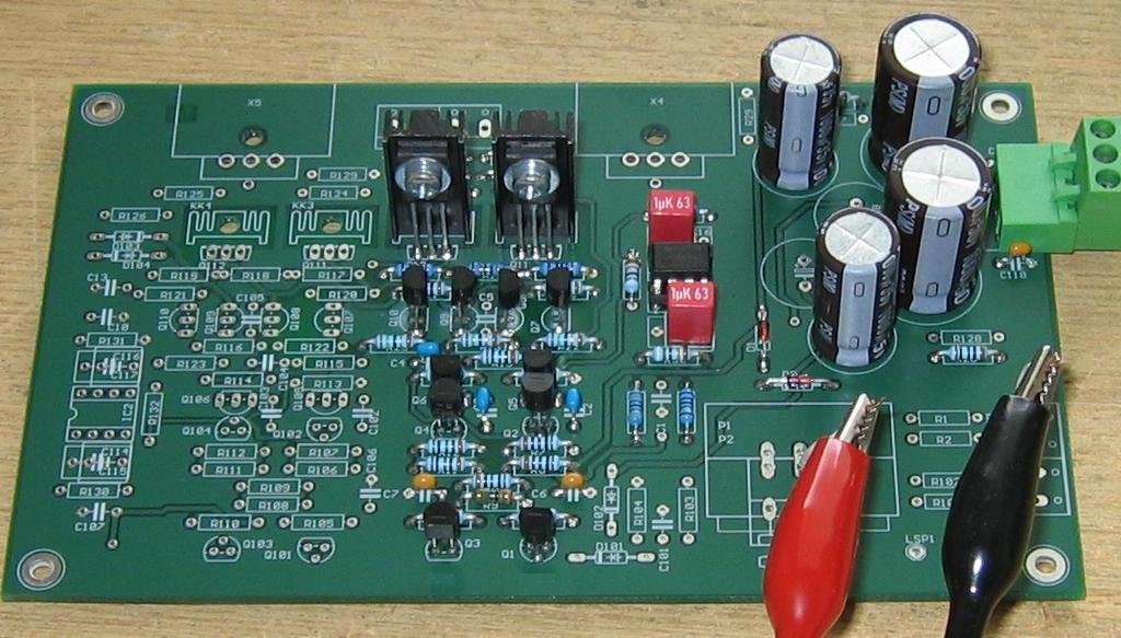

Here are my readings so far with inputs shorted to ground
Power Talema 15vac trafo then paired with VRDN psu for +15V/-15V
R6 - 865mv
R11 - 866mv
R106 - 779mv
R111 - 780mv
Voltage divided by 2.7ohm shown in ( )
R24 - 56mv (20.7mA)
R25 - 57mv (21.11mA)
R124 - 49mv (18.14mA)
R125 - 49mv (18.14mA)
R5 - 1.510v
R10 - 1.496v
R105 - 1.428v
R110 - 1.423v

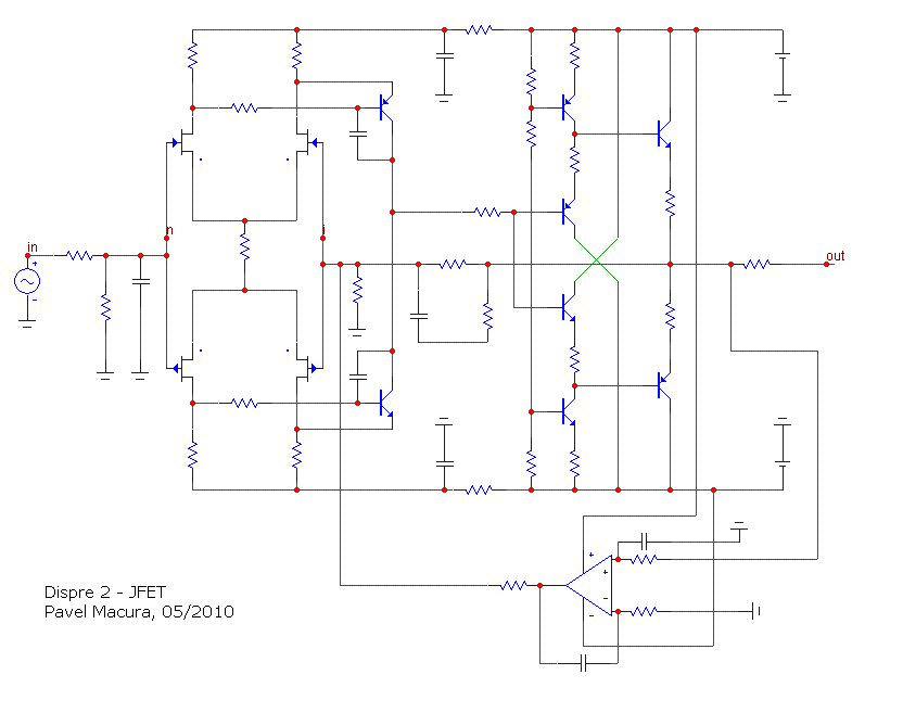

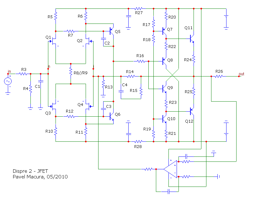

And R8/R108 value? 100R?
I would increase R9/109 a bit to get about 1.25V across R5 and R10, but as I already said, it is not so critical. The recommended scenario is to start with R9/109 unconnected and to select them by measuring voltage drop.
Thanks @PMA and yes I have the R8/108 as 100R. Now changed R9/109 to higher value but it’s dropping the voltage very less. So when I removed both the R9/109 keeping it open I get exact 1.226v across R5/105.
Reactions: Nikos and PMA
I would like to note that voltages measured across the resistors are not so critical. In my last sample, which uses stock LSK170C/LSJ74C, I measure this:
and both channel measure almost same distortion plots.
However, please keep in mind what I write in the manual:
R8 value is 100R for Idss 5 – 9mA, 150R for Idss 9 – 12mA and 200R for Idss 12 - 20mA.
This says that R8 must be selected according to JFET Idss range, to make it able to set appropriate idle current of the input JFET quadruple. This is important. As I have used parts with Idss > 16 mA, I had to use R8 = 200R in my last preamp sample.
