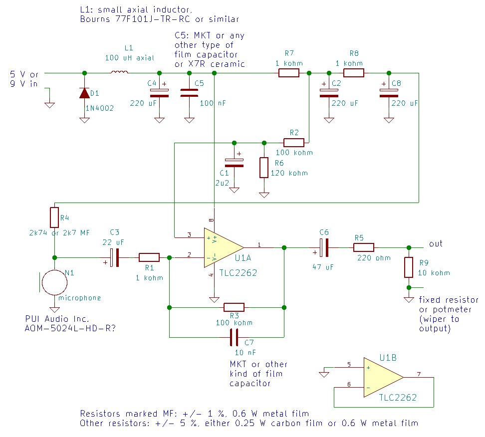

Maybe the best solution is this: increase C6 to 47 uF and always either connect a 10 kohm potmeter or a 10 kohm fixed resistor across the output.
The voltage division between the microphone supply of the sound card and the 10 kohm will reduce the DC voltage a bit, so any reverse voltage across C6 will be far less than the 1.5 V that aluminium electrolytic capacitors can handle. Besides, rumour has it that some sound cards refuse to work unless they see some load on their microphone supply, that's also solved now.
When you use a potmeter, there will be some DC current flowing from the sound card into the wiper. DC wiper current is known to affect the reliability of potmeters, but according to an old Panasonic application note, only when you draw it out of the wiper, not when the current goes into the wiper. Hence, that shouldn't be a problem.

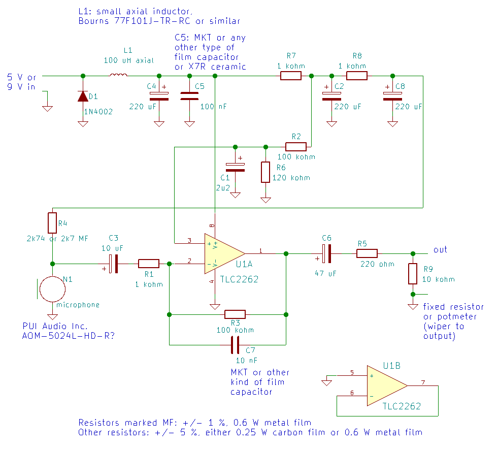

I made a mistake, C3 must be 22 uF because of the reduced R4. Apologies for the inconvenience.
Thanks for the update.. Don't apologies. I haven't even ordered the parts yet and you are more than helpful.
See item 1.4 of the attachment.
I didn't know that and definitely good to know. Thanks again. I will pay attention when soldering it.

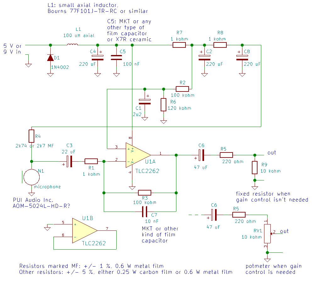

Another thought: If it is too complicated to get rid of the interference. Or even impossible. Is it not the easier and a cleaner solution to let the preamp run from it's own power supply? It's still a prototype to prove the concept. If it works then the real engineering has to be done.
No design change, just showing the two options for the output (with and without potmeter) explicitly.
If the crosstalk from the Raspberry Pi remains too high, you can indeed use a separate supply for the time being - a 9 V battery for example In the bird recording project, hal4287 managed to get his preamplifier working well on the Raspberry Pi supply, but besides the filters, he also needed to look out with how he connected the grounds. I don't know the details of how he connected things in the end.

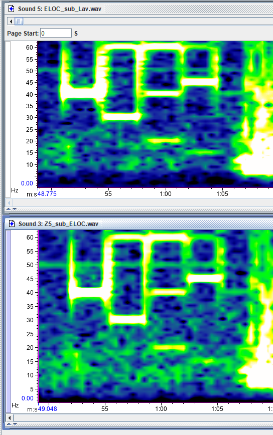

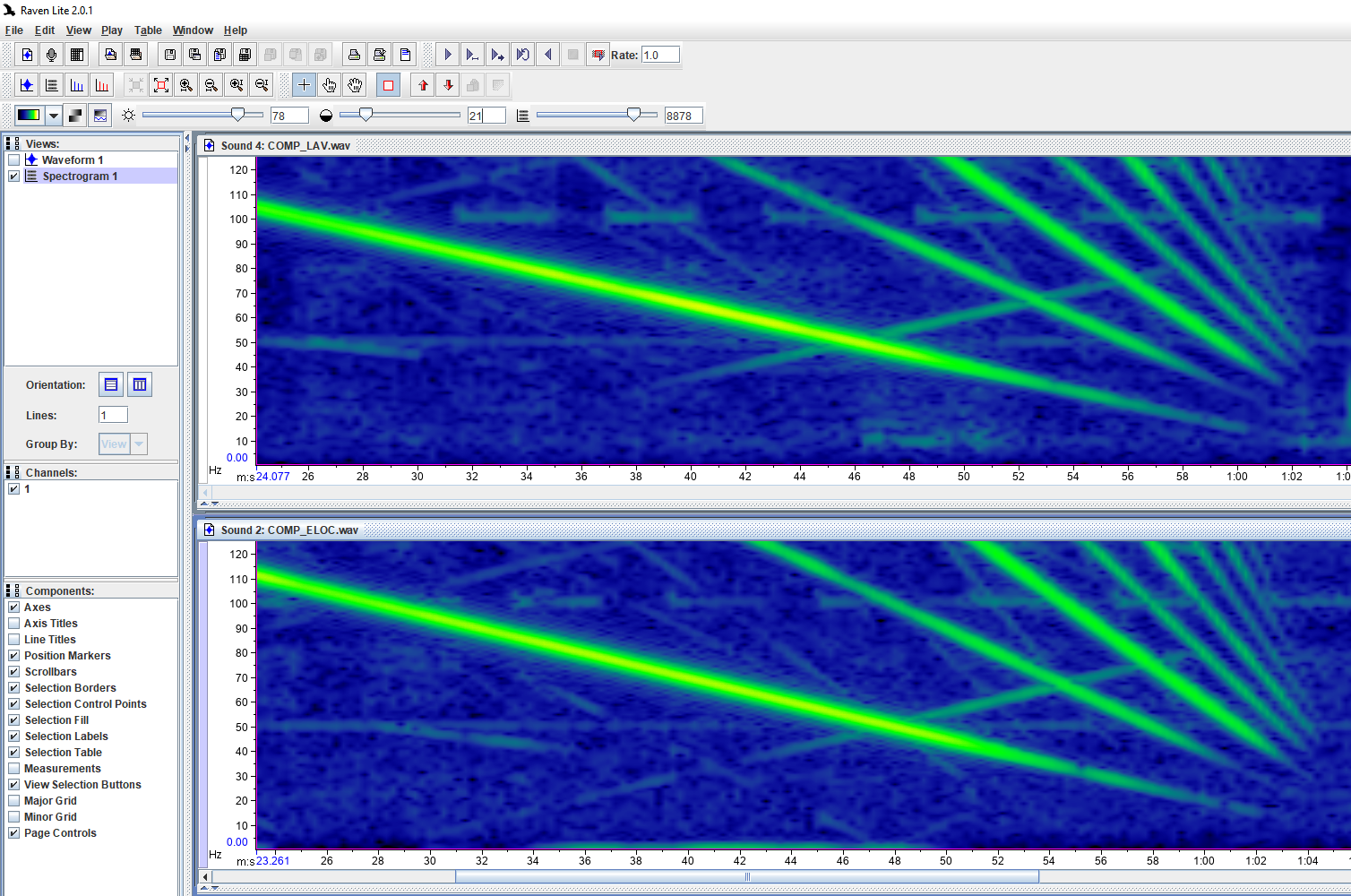

After some testing i found out the following:
My subwoofer played a sound file (from tone generator 150Hz down to 1Hz)
I recorded this sound on the same device with:
A) The preamp we built here using the WM61A
B) A 13USD Lavalier (Boya BY-M1) microphone without the preamp connected
Whatever the specs or calculations are. At the end we need to pick out a "shape of sound" in the low frequencies from the recording using a spectrogram to train the AI.
So i looked at the Spectrogram of both recordings and both results were almost equally good. Basically the same. Didn't matter how i tweaked the settings.
I still have to do more tests to be really sure about it. But it looks that way.
My conclusion is: All what the preamp does (amplify and low pass filter) we can also do with software later on. Is that correct?

The microphone might make the biggest impact.

What matters is the equivalent acoustical noise level. The lower the equivalent acoustical noise level, the softer the low-frequency signal can be while still being detectable, and the sooner you can detect elephants coming your way.
If the noise of the sound card is negligible compared to the noise coming out of the microphone anyway, then there is no point building a preamplifier. The microphone then determines the equivalent acoustical noise level of the whole signal chain, and there is nothing a preamplifier can do about it. You can then indeed connect the microphone straight to the sound card and do the amplifying and filtering after the sound card, in software.
If the noise produced by the sound card is much greater than the noise level coming out of the microphone, then a preamplifier will help (assuming the preamplifier itself has low enough noise). It amplifies the microphone's noise until it is well above the sound card's noise, so again the microphone's noise will determine the noise floor of the entire signal chain.
Looked at it in a different (anti-causal) way, the noise of the sound card can be calculated back to a contribution to the equivalent acoustical noise by dividing it by the gain of the preamplifier, if any, and by the sensitivity of the microphone. The higher the gain of the preamplifier, the smaller the contribution of the sound card to the equivalent acoustical noise, but when that contribution is already negligible without any preamplifier, there is no point in making one.
Do your spectrograms still look the same when the subwoofer is set to a very low volume?

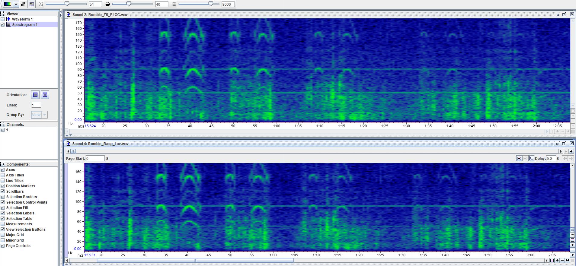

This time i played a sound file with a few seconds of 40Hz 30Hz 20Hz and 15Hz. Played with low volume. But i could have just put the mics further away. Would have done the same effect
The upper result is from the Lavalier without preamp. Low frequency detection seems to be much cleaner. I did several tests with different devices.
But the "unclean" result can also come from the fake WM61A... so have to do more testing when i have a better mic capsule.

Problems with the original circuit:
1. You can not short R5. This will make the op-amp unstable. It should be at least 500 Ohms. A larger R5 resistance allows a smaller C2 but should not be so large that it causes signal loss.
2. C3 is a high pass filter, currently at 72Hz. 25 Hz will be severely attenuated. It does not need to be a bipolar cap. A 22uF electrolytic would be better for a >=7Hz .
3. There is no DC blocking on the output. This may be a problem for what ever is connected to the output and there will be a lot of noise when you adjust VR1. A 10uF electrolytic in series with R5 would block the DC.
a. For the low frequency application, the use of an inverting amp is a poor choice that requires a large C3.
b. Likewise a single supply requires DC blocking caps that a bipolar supply does not. DC blocking caps create a high-pass frequency. You can use two batteries or split a single battery with "ground" set by a divider (R2+R6), ie ground not connected to either battery connection.
c. There is no need for large bipolar caps in such an application.
d. For low frequency applications, choose an op-amp with a low 1/f noise frequency, probably not a FET op-amp. Offset is not an issue for single supply circuits. Rail-rail op-amps are good for battery operation but some are only good for use at 5V. Check the data sheet. Low power is good for battery operation but bad for audio distortion.

You assume that MIC1 is a voltage source, but it is much closer to being a current source. Hence, the cut-off frequency is approximately 1/(2 pi (R4 + R1) C3).
The noise of MIC1 itself increases with 20 dB/decade at low frequencies, so 1/f noise of the op-amp is less of an issue than one would think.

In the datasheets I usually see an application circuit with a 2.2 kohm bias resistor, a list of specs that apply to the microphone in its typical application circuit and in that spec list "Impedance: less than 2.2 kohm" or "Output impedance @ 1 kHz: 2.2 kohm". That is, it's not a perfect current source, but it is close.
Access Denied
https://www.puiaudio.com/media/SpecSheet/AOM-5024L-HD-R.pdf
Nonetheless, 2.2 uF is indeed too low for 5 Hz, as was concluded dozens of posts ago.
