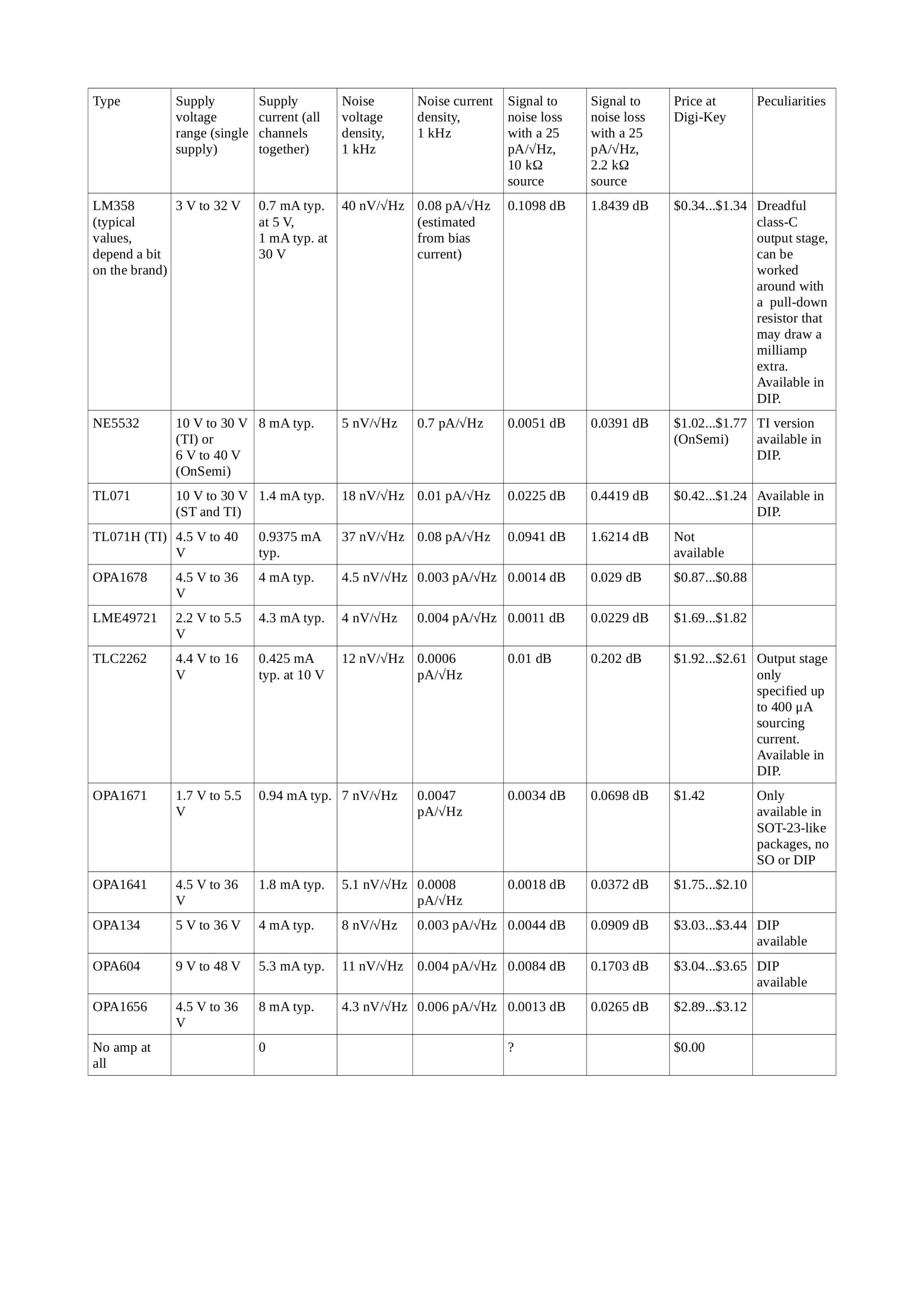

5 V will change what op-amps you can use, but with a 9 V battery you probably want to keep the supply current low - which means an NE5532 is not such a good choice. Sharing the supply with the computer also can lead to crosstalk issues, although it worked out fine in Hal's case.
An OPA1678 draws 4 mA typical and can work at 5 V as well as 9 V, while an NE5532 draws 8 mA typ. and needs at least 6 V. I haven't checked the TL071.
A TL071 needs min 7V according to datasheet. So that might still work with 5V. And maybe also try the NE5532 if it worked for Hal.
Some people talk about the TLC2262 which needs min 4,4V. Would that be a good choice?
Attached is a list with data for some of the op-amps mentioned in this thread, plus an estimate of how much signal-to-noise-ratio loss the op-amp's noise will cause when using the PUI microphone with either a 10 kohm bias resistor or the 2.2 kohm that the manufacturer recommends. These numbers would be even lower with the Panasonic microphone, because it dominates the noise even more. They apply at 1 kHz rather than 10 Hz, but as the noise density of an electret microphone capsule increases faster at low frequencies than the 1/f noise of an op-amp, the differences at 10 Hz will be even less.
I added the last line to remind you that you may not need a preamplifier at all if the noise level of the audio input of the single-board computer is low enough.
That's a very useful list. Thanks a lot.
Only two OPAMS which work with 5V are available in here:
OPA134 and TLC2262
So i guess the OPA134 is the winner. For only 1,80USD even a bargain 🙂

I don't know about that; both have a noise level far below the microphone's and the TLC2262 draws much less current than the OPA134. It's a pity that its output can only source 400 uA, though.

For what it's worth, if I were to modify the circuit for a TLC2262 and the elephant frequency range, I'd try something like this:
MIC1: AOM-5024L-HD-R or WM-61A, whichever turns out to work best (I expect the former, but no-one specifies what happens at 5 Hz)
C3: change to 4.7 uF MKT film capacitor. I don't think you need much more than that, because the microphone is essentially a current source, so the cut-off frequency is essentially 1/(2 pi C3 (R4+R1)) rather than 1/(2 pi C3 R1).
OPAMP: TLC2262
C2: 0 (removed)
R5: replace with 220 ohm in series with 10 uF aluminum electrolytic, positive side pointing to the op-amp. The resistor is just meant for stability when someone connects a long cable, any value between 47 ohm and 1 kohm will probably do.
Connect a 10 nF MKT or NP0 ceramic multilayer capacitor in parallel with R3 if low-pass filtering is desired, otherwise 39 pF NP0 ceramic (or 100 pF if a roll-off at 16 kHz is OK).
Using the feedback capacitor as filter capacitor instead of R5-C2 has several advantages: the op-amp doesn't need to provide as much signal current as with the R5-C2 filter and you have more loop gain in the feedback loop. A disadvantage is less protection against RF signals picked up by the cable at the output.
C4: no idea, to be determined experimentally what value is needed to keep everything stable with nearly empty batteries (that is, to prevent low-frequency oscillations, a.k.a. motorboating).
OPAMP: TLC2262
C2: 0 (removed)
Parts are on the way and will we built soon. That's really nice of you. Thanks a lot. Will also post the results in comparison of what i have now.
I also stumbled across this paper about different microphones. But i guess everybody here has already read that 😀
Just in case: High microphone signal-to-noise ratio enhances acoustic sampling of wildlife
By the way, for 5 V supply, R4 would have to be reduced to about 4.7 kohm (or 4.75 kohm if you prefer E96 values).
Using metal film resistors for R4 and possibly R2 and R6 could lead to a slightly lower noise floor than using carbon film (and a much lower noise floor than using carbon composition, but those are almost never used anymore). I wanted to mention that for completeness, even though I see you use metal film resistors everywhere anyway.
