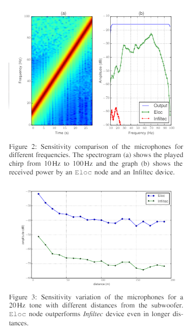

According to the already published paper the circuit which i built should have results as attached picture sows (ELOC is the one i am trying to build).
The complete paper can be read here: Locate Elephants using Infrasound

I have only had time to read a part of the paper so far, but I have one question and one remark:
-What is done when the elephants are localized?
-The conclusion that Eloc outperforms INFRA-20 is not convincing to me, because what matters is the signal to noise ratio rather than the sensitivity - it's easy to increase gain, but there is no point in doing so when the microphone noise already dominates.

The paper in very short:
The rumbling from elephants can be picked up from mics at max 2 km distance. So there will be a mesh network of microphones maybe 1km apart.
A microprocessor will trigger and sends the data through a LoRa network to our server if a elephant sound is recognized. With this data the life location elephant groups can be calculated and if the AI is good enough even from each elephant because they of course have their own specific "voice".
That is why i am building these preamps and test them first at a elephant camp nearby. To see if they can be used instead of the 400USD INFRA-20. Some researchers already use these for elephnats which are mics made for bioaccoustic research. They also work. But also cost 300USD.
Many good microphones are able to record till 10Hz or so. But i think they are not sensitive enough in these low frequencies?
