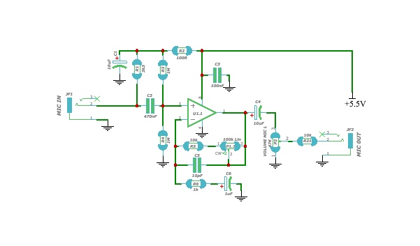

When R4 is reduced to 4.7 kohm for 5 V supply, C3 has to be increased to 10 uF, which starts to get expensive in MKT. Panasonic has some cheap bipolar electrolytics, but those may not be available everywhere. The most practical solution would probably be using an ordinary 10 uF electrolytic capacitor and measuring with what polarity it has to be connected in the circuit.
Thanks again for still improving it. I would love to have already implemented all your suggestions. But i am still waiting for the parts 🙁

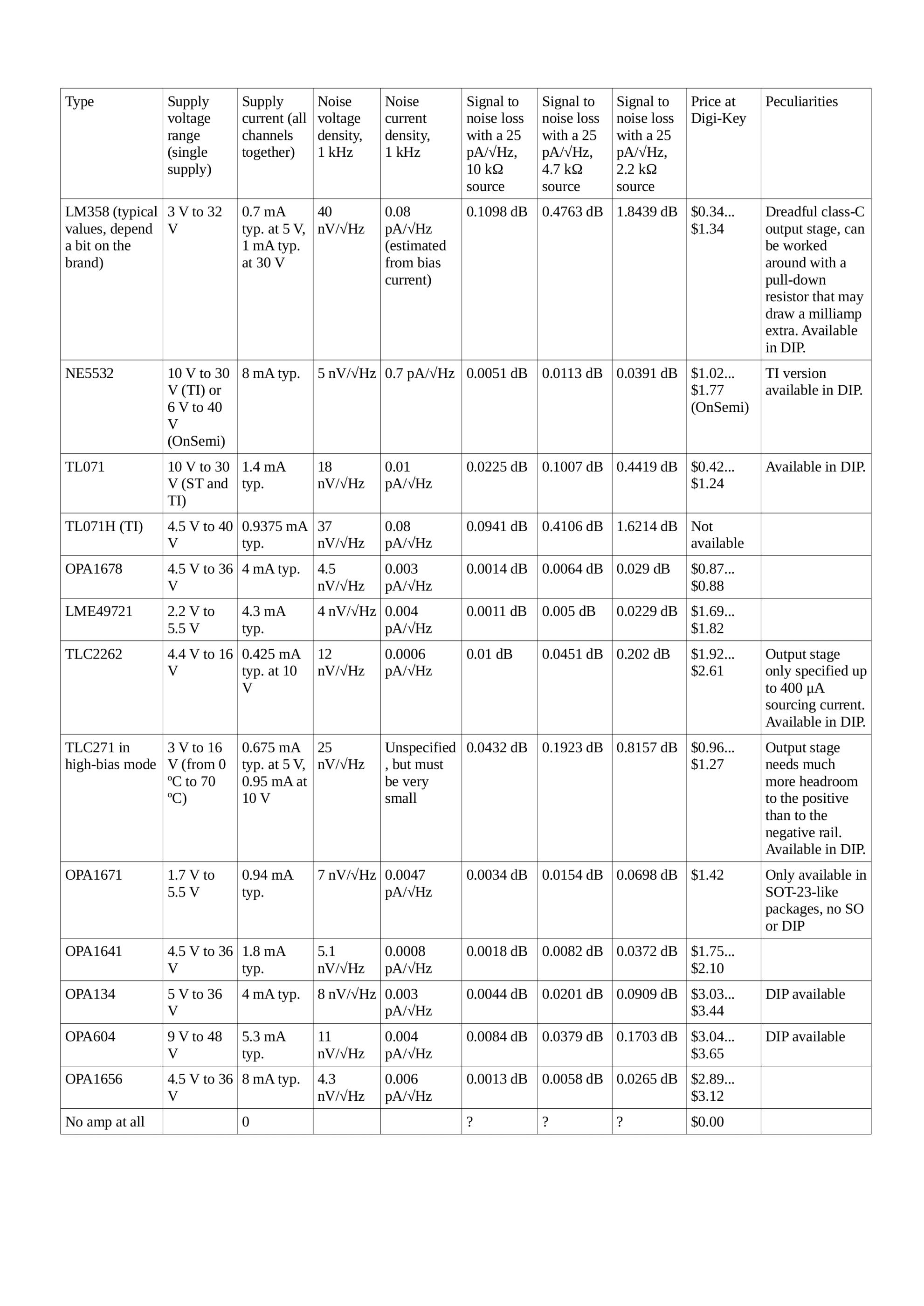

That's a low-offset version of the TLC272. As low offset isn't needed and only one channel is used, you may then use the cheaper TLC271 instead: 25 nV/sqrt(Hz) at 1 kHz in high bias mode, $0.96 ... $1.27 at Digi-Key, 0.675 mA typical at 5 V and 0.95 mA typical at 10 V in high bias mode.
I didn't look at the TLC27x family because the TLC2262 is advertised as a performance upgrade for the TLC27M2. I should have checked the price difference, though.
Attached is an updated op-amp list, the additions are the TLC271 and the estimated loss of signal-to-noise ratio due to op-amp noise when the microphone's bias resistor is 4.7 kohm.

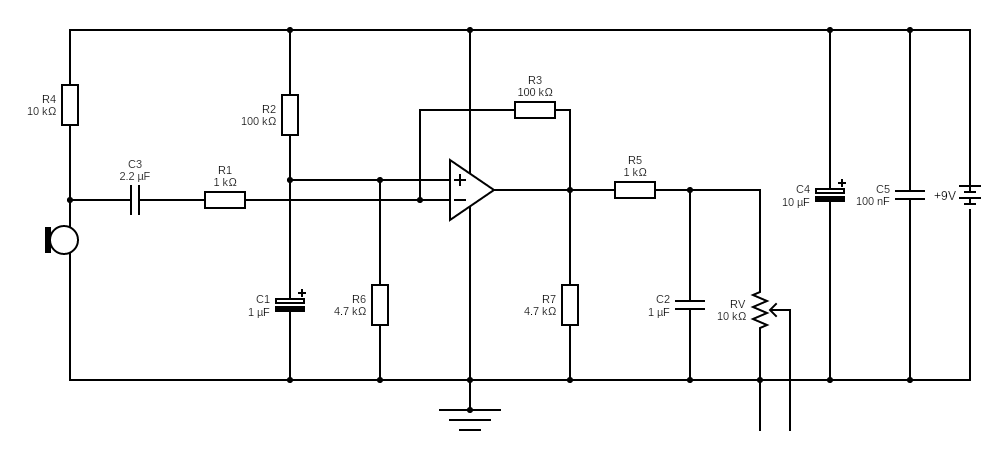

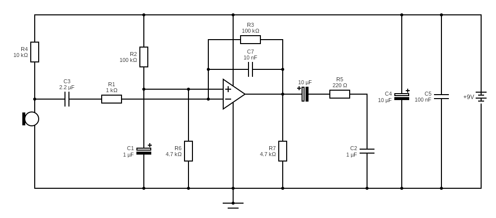

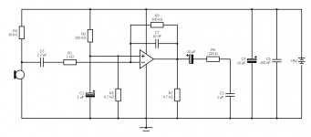

Finally the parts have arrived and i build a prototype with all the modifications (suggested from super helpful MarcelvdG) on a breadboard. Unfortunately there is no sound output. Even i tab on the mic... nothing.
But maybe i made the wrong circuit. To clear things up:
ver_01 is the circuit with the hissing sound.
ver_02 after i made the modifications i got from this forum (works pretty good already. Sound compare: with LM358 and TLC2262 )
ver_03 is how i interpret this post
Is ver_03 correct? Or did i misunderstood something?
What i have measured with a 7V supply voltage:
Mic gets around 3,8V
GND - pin 2 OPAMP: -0,87V
GND - pin 3 OPAMP: - 0,55V
GND - pin 8 OPAMP: 7V
GND - C6 (negative side): -1,1mV
GND - C6 (positive side): -39,3mV
C7: Does MKM work instead of MKT?
I used The LM3598 and the TLC2262 with same results.
If you think this info does not sound logical ad all. I will check all again Which i already did three times though 🙂
Trying to get this running first before i implement the 5V modifications.
Thanks again for all the support.

In the right circuit, R6 should be 100 kohm, C2 shouldn't be there and R7 shouldn't be there when you use the TLC2262 (only meant for the LM358). C3 should be 4.7 uF.
I had never heard of them before, but MKM capacitors should work fine.
Ohh. I don't know how that happened. But it seems i accidentally uploaded a wrong version of the ver03 circuit. So this here is correct picture of the circuit which didn't give me any sound output. So the voltage measurements from my last post apply to this new uploaded circuit.
Sorry for wasting your time with my mistake.
First thing to check would be the positive input, pin 3. It's supposed to be biased at about half the supply voltage. Pins 2 and 1 then basically copy pin 3's DC voltage.
Yap. You are the man. That made me find the problem. In computer terms i always used to say: The problem sits mostly between the chair and the monitor. Of course this case was no different. I haven't connected PIN 1 at all.
So now i get some output but it is very very quiet: Blowing into the mic from 2cm distance
Another hint?

The voltage at pin 3 should be independent of whether you connected pin 1, so I don't understand how connecting pin 1 can fix the wrong voltage at pin 3.
Do you get the correct bias voltages now, about half supply at pins 1, 2 and 3 and supply minus 2 V ... 5 V across the microphone?
I don't know what it was but suddenly it works now. I didn't change anything. Maybe my audio cable has a short or so. Or some other loose connection.

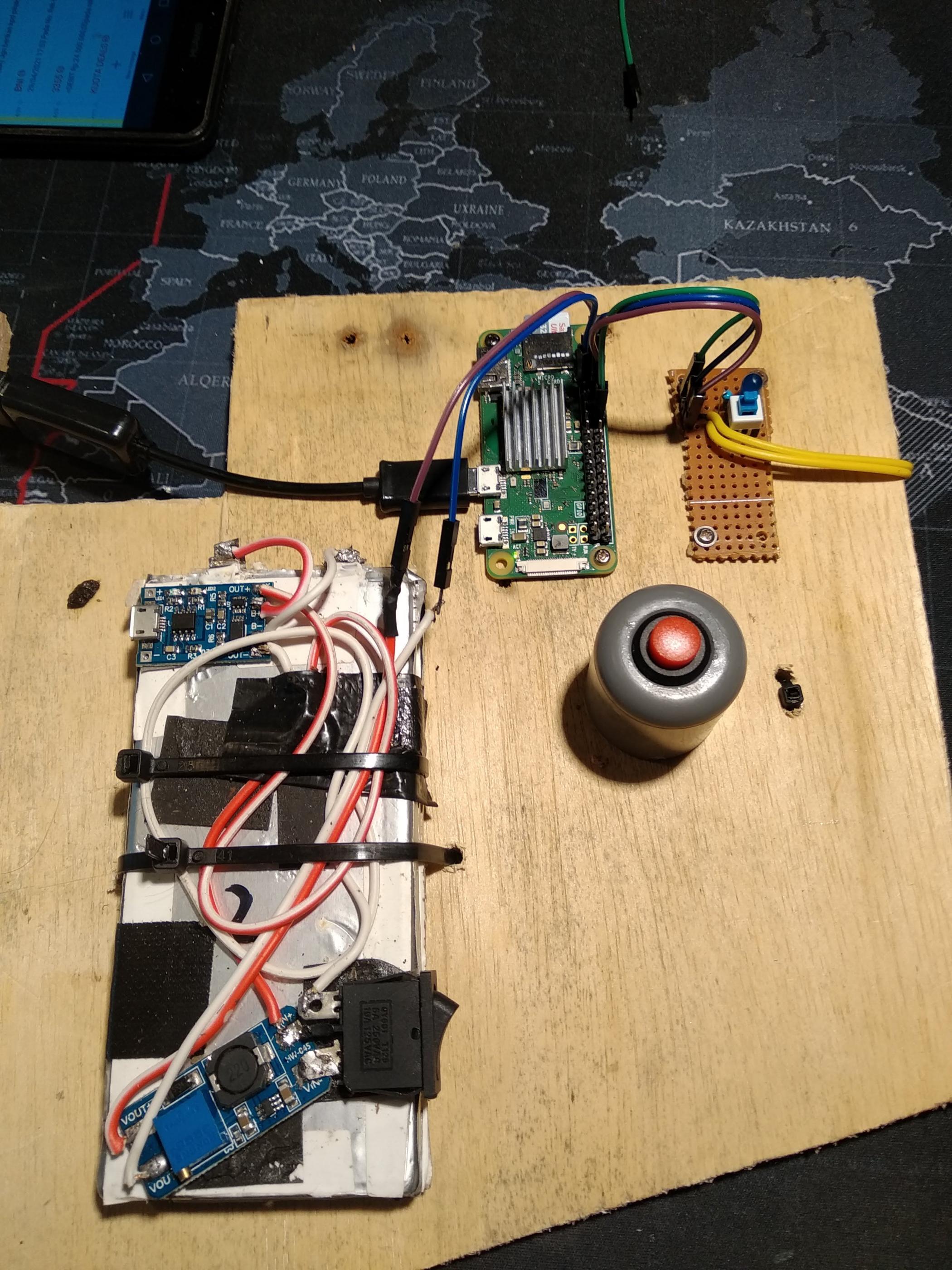

That's how the RPi is powered right now. Don't punish me for that DIY "powerbank" 😀 But that might be one reason for it.

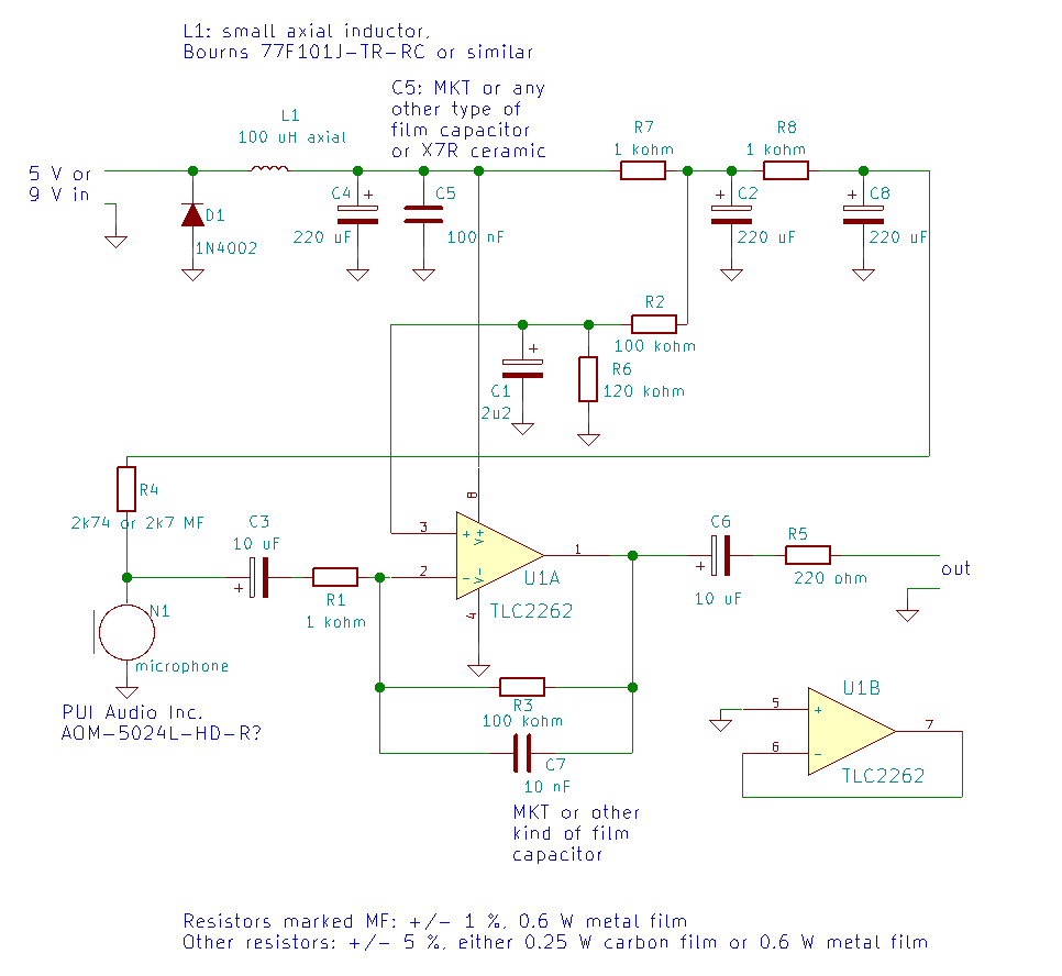

I think you need some brute-force low-pass filters, similar to what we used in the bird recording thread. I'll draw a schematic and post it. At least I know now that I didn't waste Hal's money by including them in his preamplifier...
In the GoldWave spectrum plot, the interference from the Raspberry Pi looks like 23 Hz and its harmonics plus a big peak around 1003 Hz. See the attachment, the horizontal axes are in Hz and the vertical ones in dB with respect to some unknown reference. The bottom graph is a zoom of the first 200 Hz.

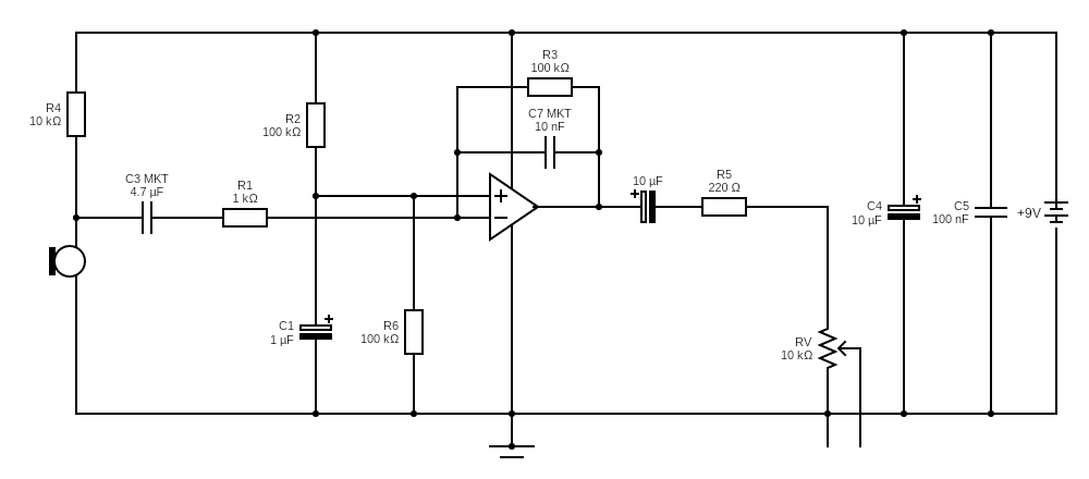

This is the best I could come up with. Is the sound card's input a line input or actually a microphone input with a DC bias voltage on it?
Changes:
-Extra filter components added: L1, R7, C2, R8, C8. D1 is a diode to protect against reversed polarities and a freewheeling diode for L1.
-Values of C1, C4, R4 and R6 changed.
-R2 connected after the first section of the new filter.
-I didn't draw the potmeter, but just add it if needed.

Oh i understand. So it's basically "just one" frequency we need to get rid of and the rest disappears with it.
For now we are using a USB sound card which has an actual MIC input. It measures 3,2V.
As usual i will have to wait for parts to arrive. And i will report back when i got stuck somewhere or i actual do not make a mistake this time and it will all work 🙂
Thanks again for all your effort. I really appreciate it.
