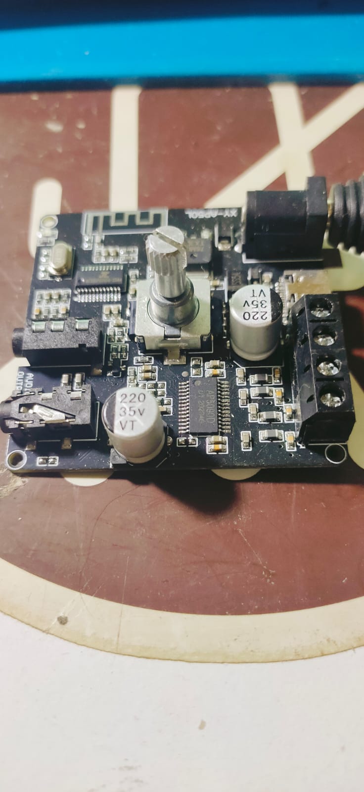

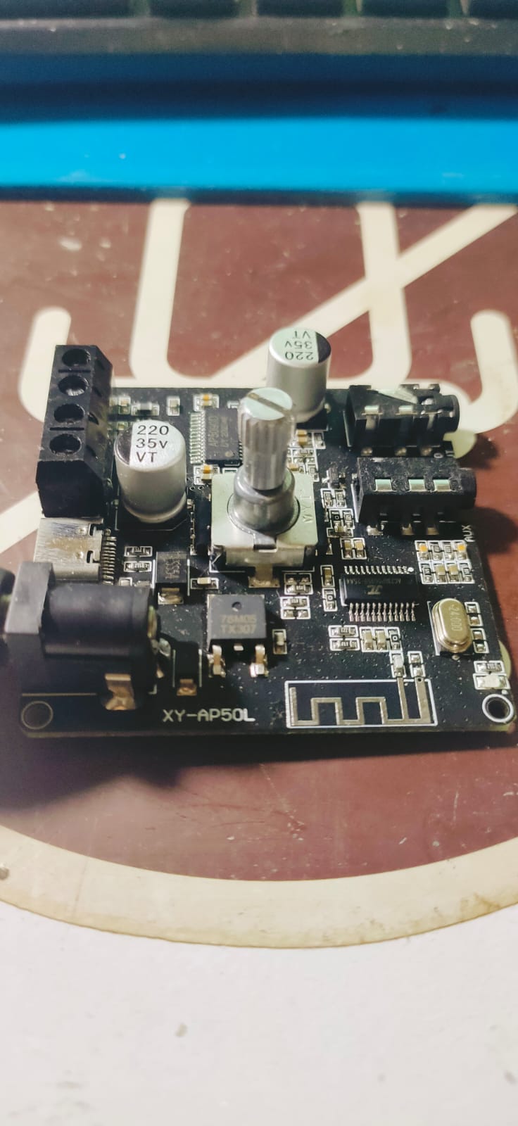

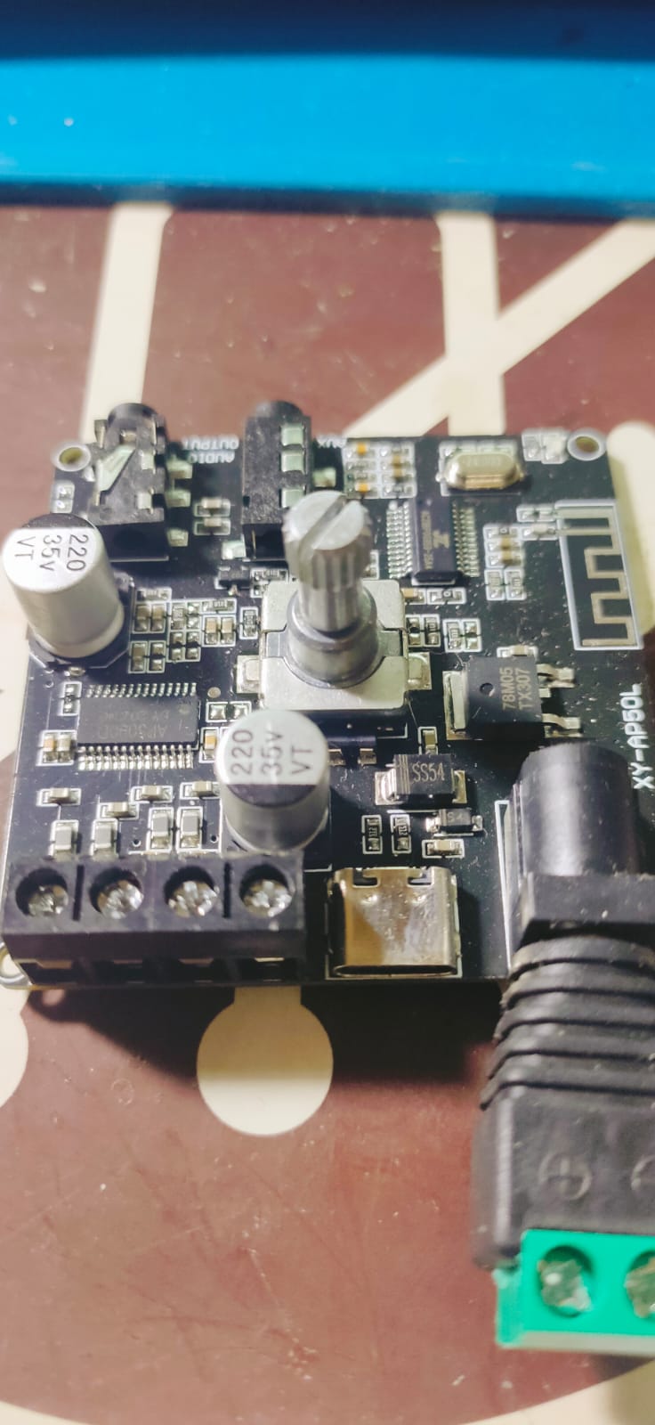

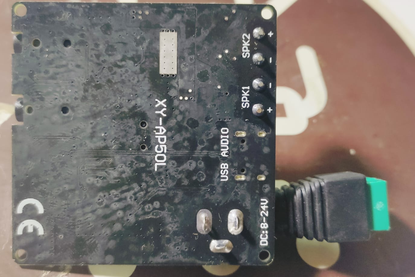

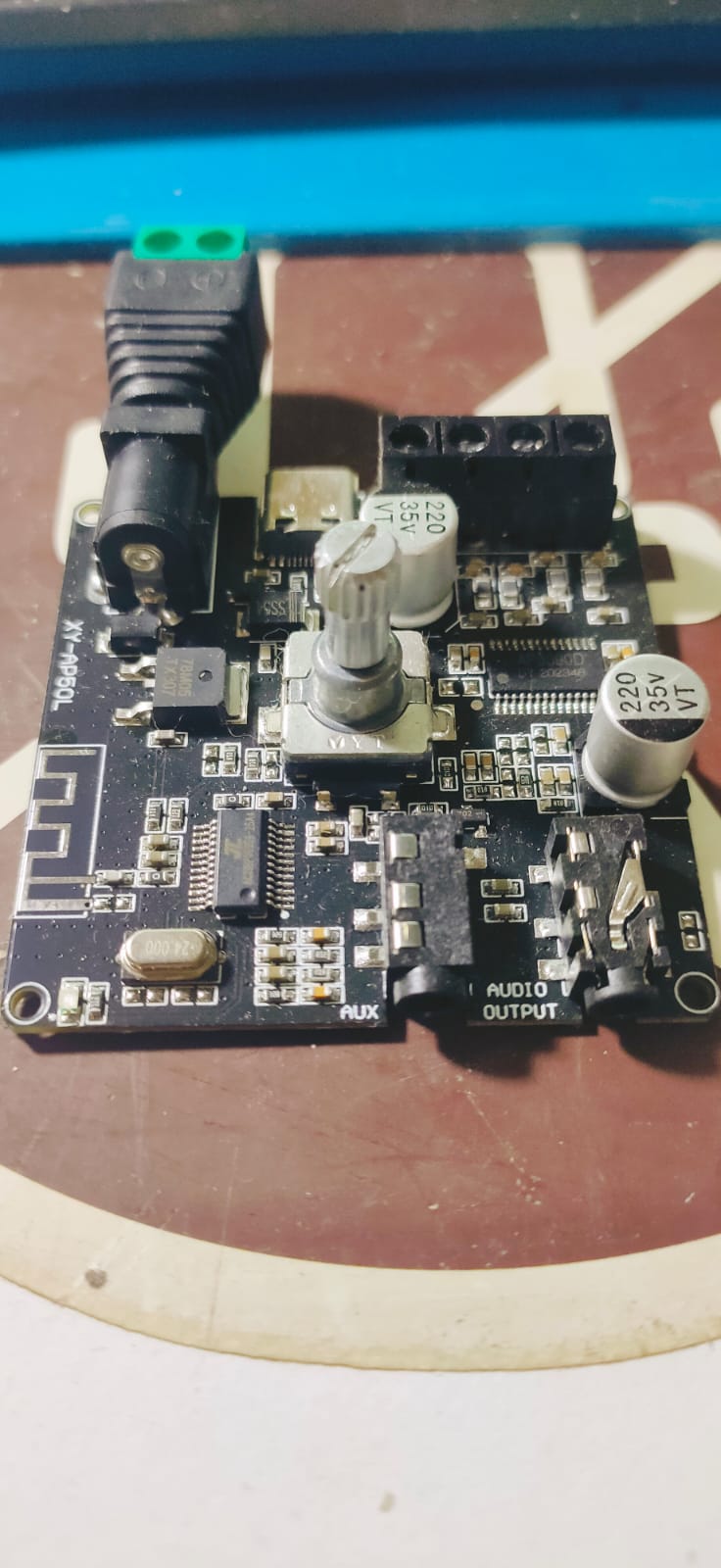

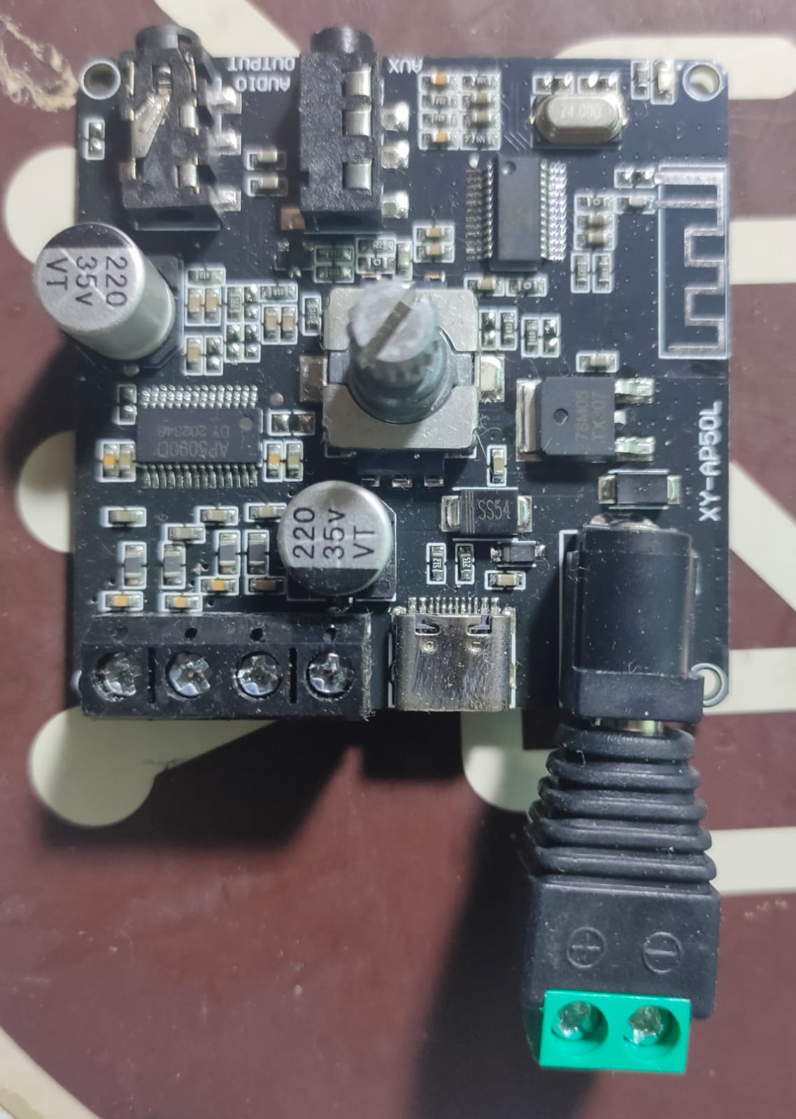

while searching i found this post and want to ask a question ..how for encoder to be used with analog signal to make volume control ...ive this board from aliexpress its 2 channel stereo class-d amplifier and i cant find any chips but the amplifier it self and the bluetooth chip how to run the encoder such a way?

For my volume control the rotary encoder sends pulses to a microcontroller which interprets the pulses for up or down. How yours uses the pulses you would need to follow the traces from it and see what they feed, has to have a microcontroller or dedicated chip to use it.
