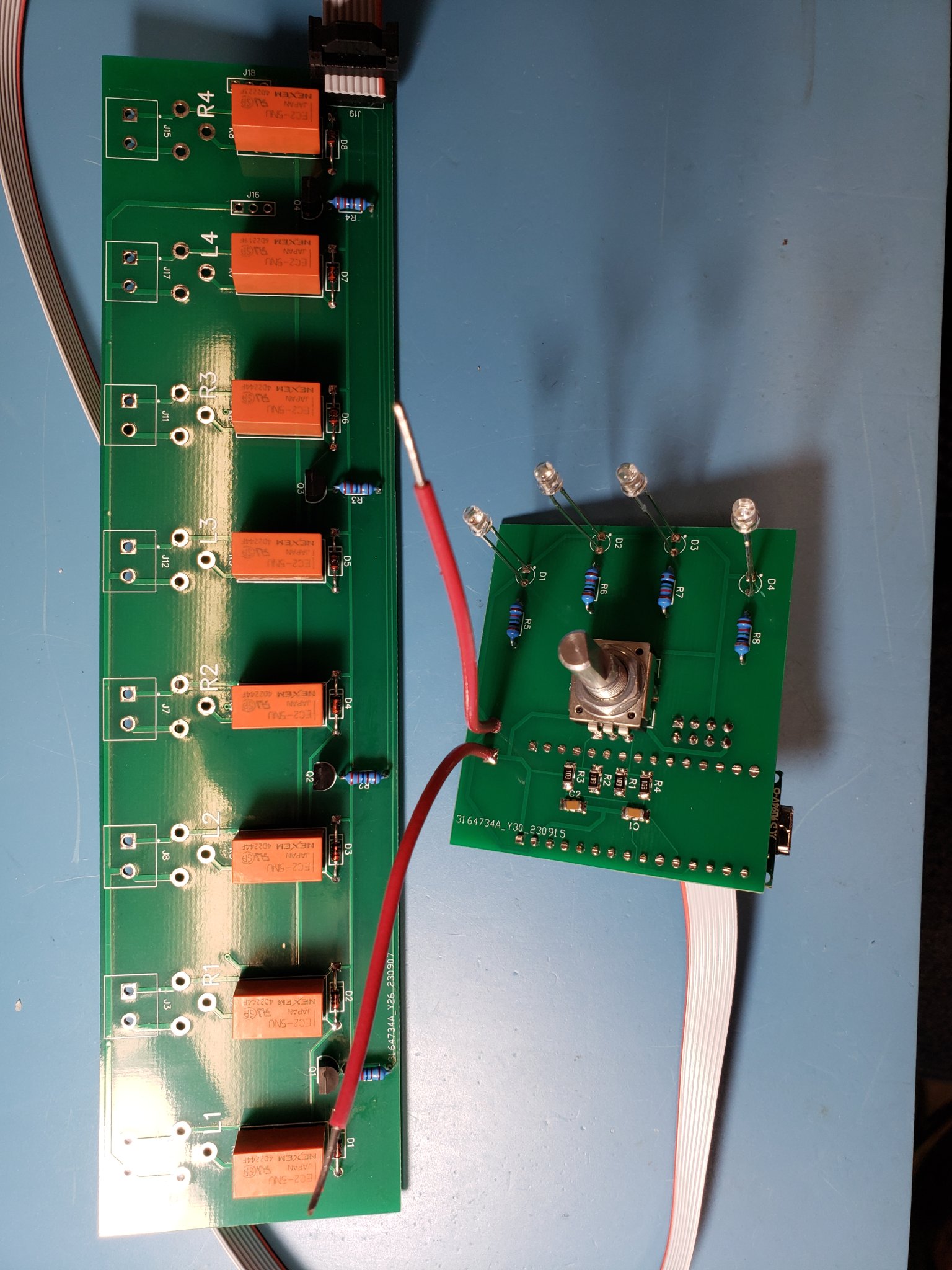

The selector board is also now completed and is working correctly except it only changes selections when rotated clockwise, it does nothing in the opposite direction. I checked both digital input pins on the Nano and it gets pulses both directions. I checked everything else and not seeing any issues. I'm posting a picture of it, maybe someone else will notice something. It's acting like a software issue.
Finally found a few minutes to look at the code and found the bug. In the Loop() code the line if(inputDown){ should be if(inputDownInt){
I need to look the code over more closely, it is not the cleanest code, I through it together without the hardware to test it. If I can clean it up then I will repost soon.
Ok updated the code. Made it simplier and doesn't roll over the input from 4 to 1 on up or 1 to 4 on down. Now it goes up to 4 and stops so you have to turn it the other direction to turn it back to 1. I will just post it as text, it will lose all the formatting indents like good code so not as readable:

Awesome! I will give this a try. I hate to say anything, but the newest code for the volume control is still muting/unmuting when the button is held. I'm wondering if the code posted was the old version and not the new.
Great on the input. I will have to look at the Volume Control code see if I didn't post the corrected code or not. Thanks for the catches. 🙂
One thing that might help with keeping versions straight would be to put a version number for each sketch in the comments section at the top. Then anyone can quickly identify which sketch is being used.
Hi RickRay, When you say "the volume control is still muting/unmuting when the button is held", are you referring to the encoder push button or the remote. The code is meant to stop the mute/unmute cycle from the encoder, if someone holds that button in. The remote will send repeating codes when a button is held, can't stop that, but not a bad thing as you want to be able to hold the volume buttons down to go up or down quickly, having to push and release a volume button on the remote to change one step at a time would be a pain. 🙂
Good idea to add version to the comment section at the top, I used to do something like that, but lately my version control on the software sucks. I do make a point of keeping versions on the Gerbers, at least in my system.
Both the encoder and remote go from mute/unmute still. It also goes from standby to on when the encoder button is held down still. Makes sense that the remote button would still do that.
Ok, checked the code for the volume of old verses new and they are the same. And the programming computer seems to have deleted all my files. I have backups of everything except the Volume programs update. So I will have to remember how I did it and recreate it. Fortunately I have one volume setup of the hardware to test on.
Oh my gosh, that sucks. Not an issue here, it will be a while before it gets installed and it works the way it is.
@johnhenryharris that fixed the encoder button issue! The remote still does it like you said it would. I did notice that the dimming function does not keep going around and around when the button is held. I am VERY happy with the way it works, can't wait to get it installed.

johnhenryharris:
I'm no coder, but the following portion of your code in Post #584 appears to have an error:
