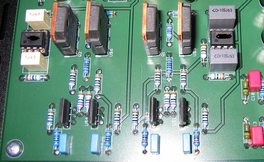

Unfortunately I have not updated the pages yet . But I have some partial PCB photos. These 2SK389/2SJ109 are great sounding parts.
Thank you . I wish I had such a stock of 2SK389/2SJ109

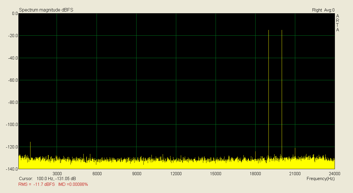

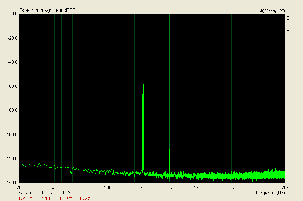

Regarding spectrum, it is at the limit of my measurement possibilities. Now I am showing CCIF IMD of the preamp.
Unfortunately, I have not found any correlation between THD, IMD, square wave responses and resulting sound. I have a bipolar preamp and JFET-MOSFET preamp that measure quite same in all known parameters and measurements, but they still sound very different ...

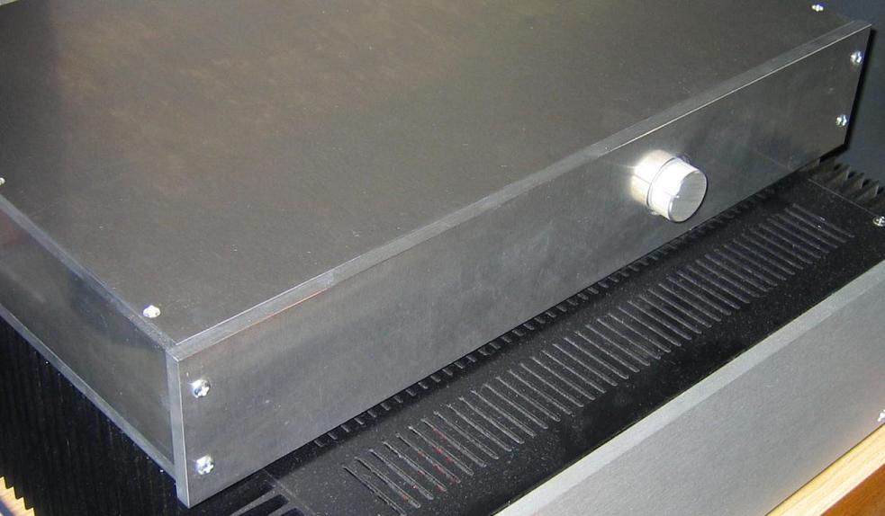

I have recently tested the bipolar preamplifier vs. the FET preamplifier both in a same conventional, 1U 440mm case. The sonic difference is easily audible.
Regarding the milled Al case - compared to the conventional case, it makes some difference. I would say like a difference between link level cables. That means, the difference in sound of bipolar vs. fet preamplifier is higher than the contribution of the milled Al case.
