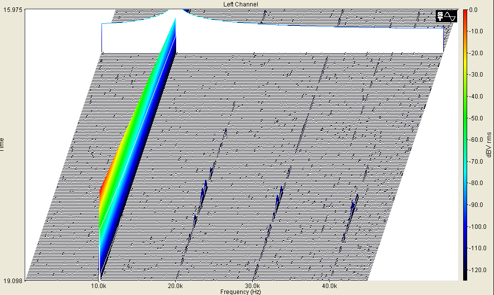

BV said:You want see stepped spectra vs. amplitude, or not? It is possible only single ton measurement, like this (-80to 0dBV, 10kHz)
Yes, I want to see spectra vs input level, on the whole frequency band. Spectra must be shown in respect to input level.

What you need to get waterfall plots is to pass each data slice as blocks of a FFT-length, normalized to ref. signal level beforehand if required, in a .WAV file (in 24-bit fixed point resolution, for example). However, the true effort is how to get/record and extract the data to pass.

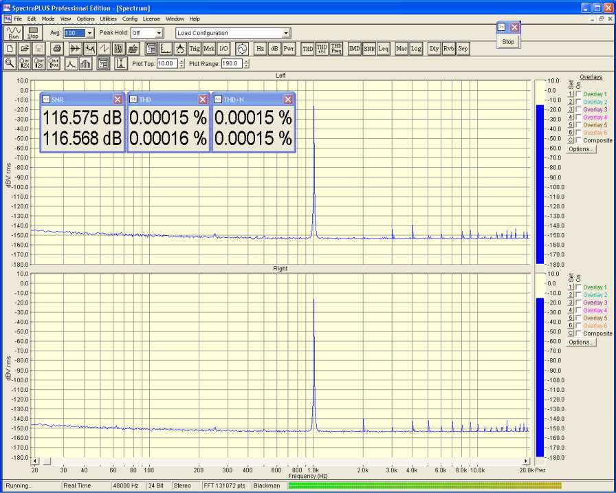

Here's what EMU 1212M can do in balanced mode. In single ended is much worse, but still acceptable for the DIYer.
This is pretty good. I expect that the higher frequency components get worse with increased amplitude?
Yes, it is. But I suppose, calibration is not done correct, and level is in respect to dBFS, not dBV rms..Noise floor under -150dBV at showed settings seems unrealistic.This is pretty good
Yes, about linearly. Unfortunately the EMU drivers are not allowing using the internal loop over 48KHz sampling, so an external generator is required.
It is done correctly. Look in the picture for the averaging, sample size and RBW.
I calculated that, and it may be done correctly. Sound card inputs differ in opamps used and topology. The values shown are not in contradiction with theory.

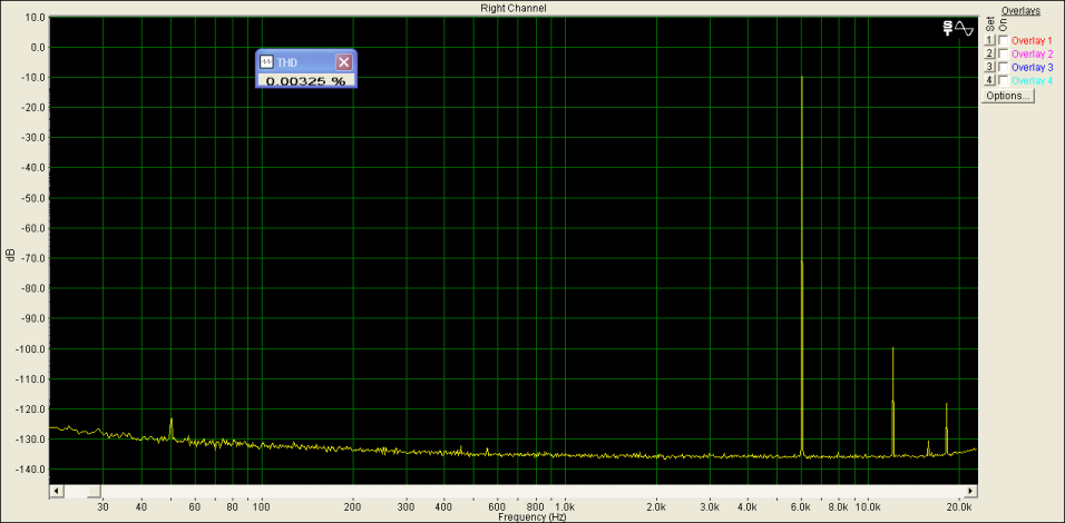

My card input is worse, the best noise floor result I obtain from preamp measurement is attached, and it is a noise floor of the soundcard. Related to dBVrms.
