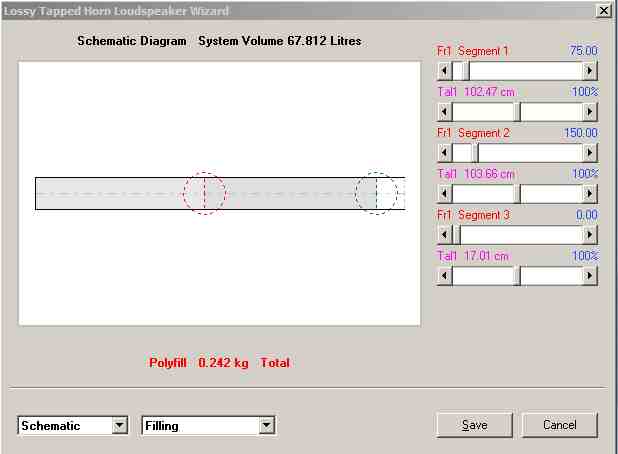

GTO_1214_T_QWP_3D_long_L12_Wizard_filtered_Displacement.jpg20.4 KB · Views: 271

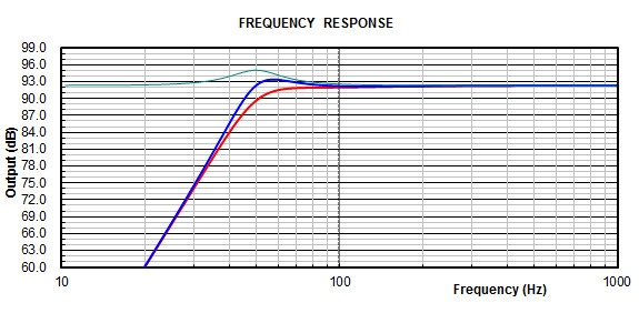

Something to bear in mind: HornResp, from what I heard, does not include the effect of losses. This can result in the actual response at lower frequencies being a bit less then that predicted, the actual difference being dependent on a number of factors. See for example the image below which compares a sim of a medium-Q driver in vented box with no losses (the blue curve) with one taking the impact of losses into effect (the red curve).
Brian
Thanks for the heads up.

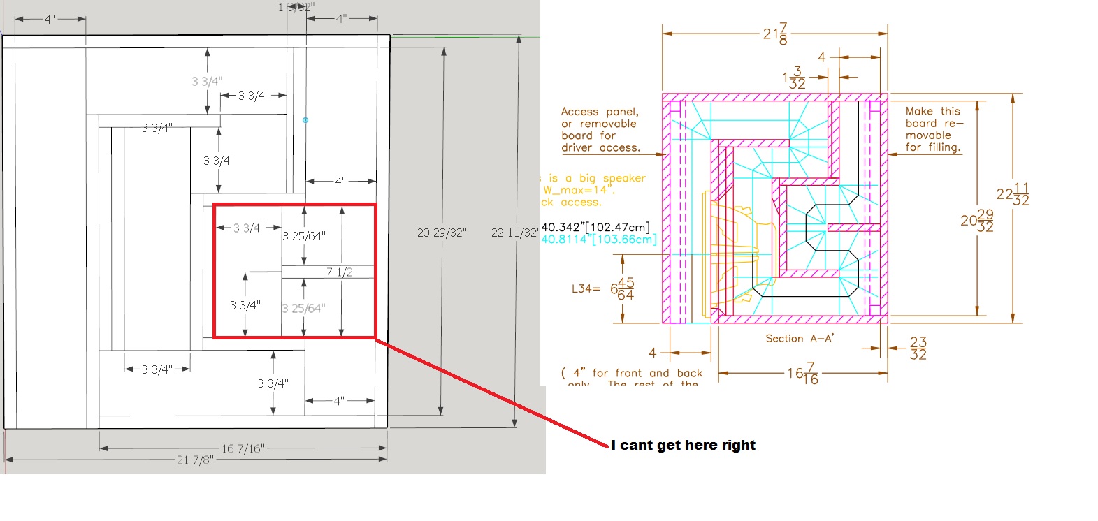

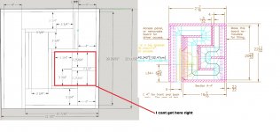

I am once again stuck trying to figure out a part of the drawing. I tried but I cant get it right, everything else falls in to place except this one area.

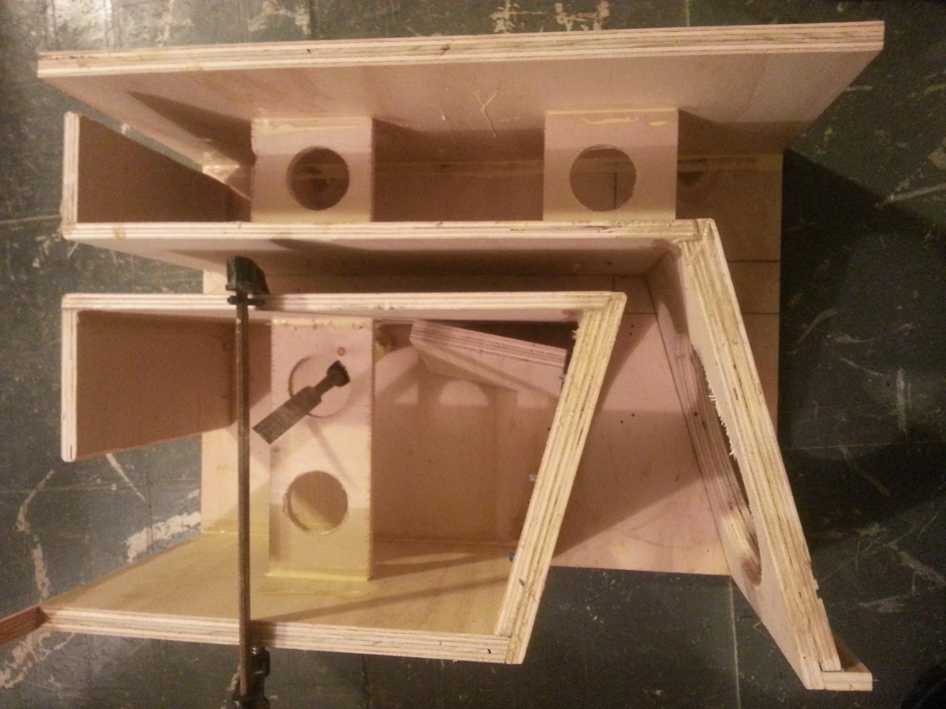

Great progress! I would stick a brace block in the channel between the braces on either side of the channel - this will give a mechanically much stronger brace as if you had a solid brace all the way thru. Same with a small block bear mouth channel.
Lawbiding, you don't play around when it comes to knocking out these builds!
Nope.
Hi lawbiding,
It's good that you redraw these before cutting wood.
I'll attach an error correction suggestion. I would also add a board @ S1 to correct the L12 length increase.
A note to the baffle board (the three boards the speaker is mounted to), the should all three go all the way to the bottom board, the immediate mounting board at the speaker would have only a straight sided hole, and the other two boards would be opened up @ about a 45° angle.
Hope that was the only error in the drawing.
