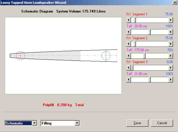

That is a nice design - big box though. I think lawbiding was asking for 38Hz to 150Hz range coverage which this TH doesn't quite go up high to. Not too many TH's can. A FLH can though - just bigger.

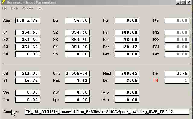

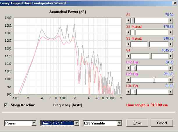

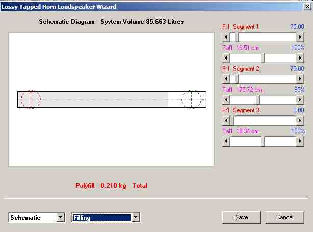

Post #228: "...What is the difference between a TH and a QWP in design and output? How smaller would the QWP be."
The TH has a horn shaped duct, that expands from throat to mouth. The QWP is also a 1/4 wave resonator, but w/ constant cross-section. See the attached example for details.

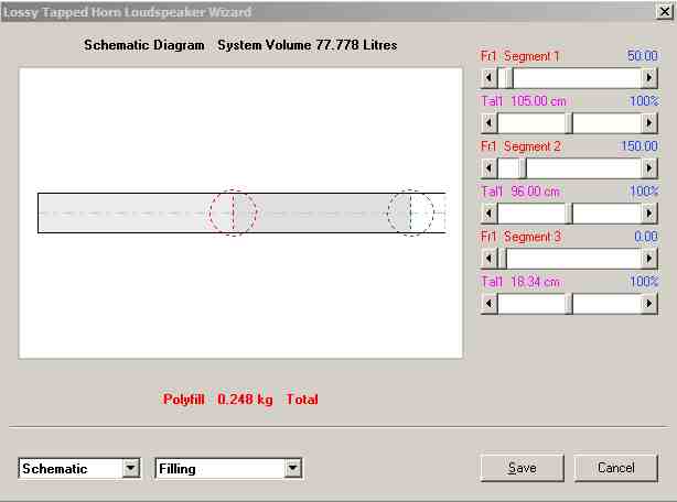

I forgot about the 150Hz, to get there you'll have to give up some SPL, and change the location of the driver in the duct, see attached Hornresp example QWP#2_long_L12. Here the driver is not placed @ the ends of the duct, but about in the middle.
Just as a note, the GTO 1214 wants to go lower, as in the Kraken THs by Petter Persson http://www.diyaudio.com/forums/subwoofers/160879-build-your-own-2x12-th-kraken-212-th.html , but, the box will get bigger fast. To get the upper range to 150Hz in a TH you'd have to add 1/4-wave tubular resonators to cancel out the two big upper peaks. Maybe X can show you how that is done in AkAbak.
I'll attach a QWP drawing, and Hornresp simulations for the long L12 and the short L12 QWPs. You can find your sweet spot for a Hornresp simulation should you go w/ one of these, or just go w/ mine.

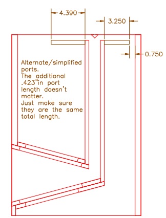

This is an update for the "long L12" QWP (with the driver in the middle). There are some changes in the individual section length. (I also noted some errors in the last drawing, but we'll take a closer look @ it if you decide to build it or this one.)

I like the layout of the qwp it look simple to build.
Tb46
I will go with this one that is attach below. I like the frequency graph although it does not go up to a 150hz
I'd be worried about that steep and deep notch in its output above 100 Hz
The long pipe looks interesting, though I think it can be optimized a bit further - there's s bit of wasted space in it.

Hi....FYI:
b🙂
Hi Bjorno
The frequency output of this one is too
Low. This cabinet is to be use in a van.

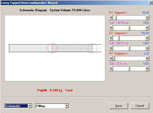

Hi Y'all,
I like bjorno's example (Post #235) too, and he calls it correctly T-QWP (the T is for tapped); naturally, as he is one of the masters of this type of enclosure. Mine from Post #230 is quite similar, it has a different fold, and a smaller duct cross-section.
Since then I have reduced the duct cross-section in the drawing/simulation even more (303.9cm^2-same width w/ 3.75"duct height), and tried to reduce internal volume waste, but when we increase the compression ratio (reduce cross-section) we also loose SPL, and it becomes more difficult to get the driver in the box (the multiple boards are bjorno's idea: Thanks); still this one would get you to 120dB in 1 x Pi, more than I would want to be subjected to. I also like the softer lower roll-off (2nd order HP filter). And the box is smaller.
I'll attach the data on that one, and then I'll run, or I'll be in trouble. 🙂
P.S.: I hope, that somebody who knows what he is doing would look this over, and help w/ the direction of this design.
