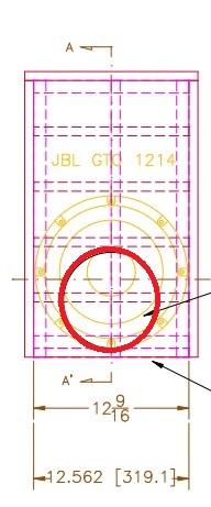

The diameter for the round hole is obviously larger ~ 7-3/4"Dia.
Tb46
Should I smoothed/break/round the edge of the round hole.

Hi lawbiding,
Post #284: "Should I smoothed/break/round the edge of the round hole."
Missed that one. Acoustically I doubt it matters, but it's easier on the fingers to use at least a 1/4"Rad. to round the edges.

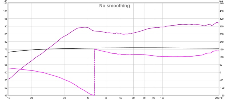

I seem to have been on a parallel path. I just built a PPSL that looks uncannily like the design posted here. The sub is for a 2001 Subaru outback sedan(my stepson's) and is meant to play through the ski hole. It uses a pair of CerwinVega S-8 (vintage) 8" woofers, EBS alignment tuned to ~35Hz. Below is a measurement taken with the mic at the opening. There is no stuffing or lining of any kind yet, I haven't had time for tuning yet. It looks like it'll be pretty boomy in the car but that's what the kid wants. I'll measure again when I get it in the car.

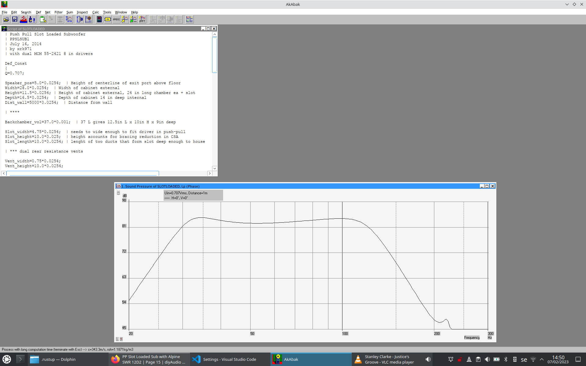

If anyone wants to play with the Akabak code for the above PPSL speaker, here it is.
Code:
| Push Pull Slot Loaded Subwoofer
| v6 with Alpine swR 12D2 Nov 11 2014 34x15x25 in dims
| xrk971  DIYAudio
Def_Const
Q=0.707;
Speaker_pos=8.0*0.0254;  | Height of centerline of exit port above floor
Width=15.0*0.0254;  | Width of cabinet external
Height=34*0.0254; | Height of cabinet external, 24 in long chamber ea + slot
Depth=16.5*0.0254;  | Depth of cabinet 14 in deep internal
Dist_wall=5000*0.0254;  | Distance from wall
Backchamber_vol=40.0*0.001;  | 40L = 2442 in cu gives 15.125in D x 13.5in H x 12in deep per chamber
Slot_width=8.5*0.0254;  | needs to wide enough to fit driver in push-pull
Slot_height=13.5*0.025;  | height accounts for bracing reduction in CSA
Slot_length=16.25*0.0254; | length of two ducts that form slot deep enough to house 12 in driver
| *** dual rear resistance vents
Vent_width=0.90*0.0254;
Vent_height=12.00*0.0254;
Vent_length=24.0*0.0254;
Seatduct_len=12.0*0.0254;  | Seat duct length from box to rear seat backs inches
System 'PPSLSUB6'
Def_Driver 'Alpine SWR-12D2'  |Alpine DVC sub 12in Qts=0.44, xmax=20mm, 72mm travel(p-p), 84.7dB, 6.375in depth, Nov 11, 2014
 Sd=479cm2
 Qms=7.1
 Qes=0.47
 fs=27Hz
 Vas=46L
 Le=2.23mH
 Re=3.90ohm  | 1.95+1.95
|OFF
Filter    'High Pass'  | 4th order Butterworth -24dB/oct
    fo=23.3Hz  vo=1.0
    {b4=1;
     a4=1;  a3=2.613126;  a2=3.414214;  a1=2.613126;  a0=1;  }
|OFF
Filter 'LowPass' |Lowpass filter - 48dB Butterworth (change 'fo=***' and refresh for changes)
fo=90Hz vo=1
{b0=1;
a8=1; a7=5.125831; a6=13.137071; a5=21.846151; a4=25.688356; a3=21.846151; a2=13.137071; a1=5.125831; a0=1; }
|OFF
| Speaker placed in corner with driver at Driver_pos above floor in corner
Def_Reflector  BottomCorner
Bottom={Speaker_pos}  Left=17in Right=17in
HAngle=0  VAngle=0
OFF
| Speaker with driver at Driver_pos above floor Dist_wall away from wall
Def_Reflector  HorizEdge
Bottom={Speaker_pos}  Top={Depth + Dist_wall}
HAngle=0  VAngle=0
Enclosure  'Back chamber 1'  Node=10
Vb={Backchamber_vol/2}  Qb/fo={Q}  Lb=10in
Enclosure  'Back chamber 2'  Node=20
Driver Def='Alpine SWR-12D2' 'Driver 1'
Node=1=0=30=10
Driver Def='Alpine SWR-12D2' 'Driver 2'  | driver 2 is reverse mounted with phase reversed
Node=1=0=30=20
Duct    'D3'  Node=31=30  | rear half of output slot
    WD={Slot_width}  HD={Slot_height}  Len={Slot_length/2}
OFF
Duct    'HR189'  Node=30=0  | Helmholtz resonator in main slot to absorb 180 Hz peak
WD=14in HD=1.0in Len=18.7in  Visc=30
Duct    'D4 Slot'  Node=30=32   | front half of output slot
Duct    'D1 Vent'  Node=10=31   | resistance vent 1 leading to slot
    WD={Vent_width}  HD={Vent_height}  Len={Vent_length}
Duct    'D2 Vent'  Node=20=31   | resistance vent 2 leading to slot
| *** Connector duct from box through flip down ski hole door in back seat ****
Duct    'D5 Seatduct'  Node=32=33   | duct from box to radiator, assume same CSA
    WD={Slot_width}  HD={Slot_height}  Len={Seatduct_len}
Radiator 'Vent_rad'
Def='D5 Seatduct'
Node=33
x=0  y=0  z=0
HAngle=0  VAngle=0
WEdge=30in  Hedge=15in  | Assume seats are 60in wide x  30in tall
Reflection

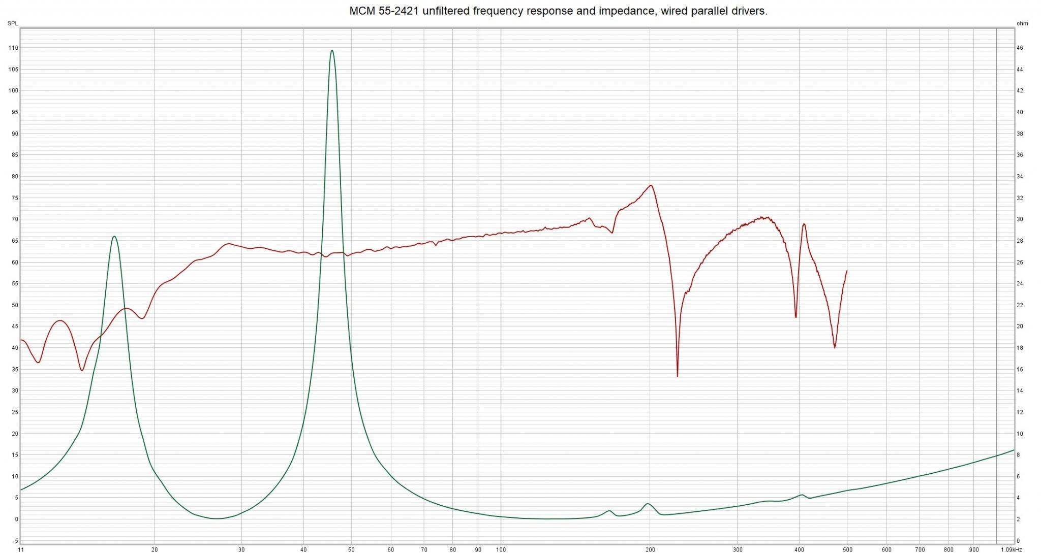

I thought this design looked promising, so I built one...Quite pleased with the results, but the tuning and impedence seem a little different from the sim. Measurement made outside, well away from any boundaries, at about 3m from the mouth, ground plane. With a 30Hz 24 dB LR high pass flat down to 35Hz, in half space, which is quite impressive in this size cab!
Reactions: xrk971
