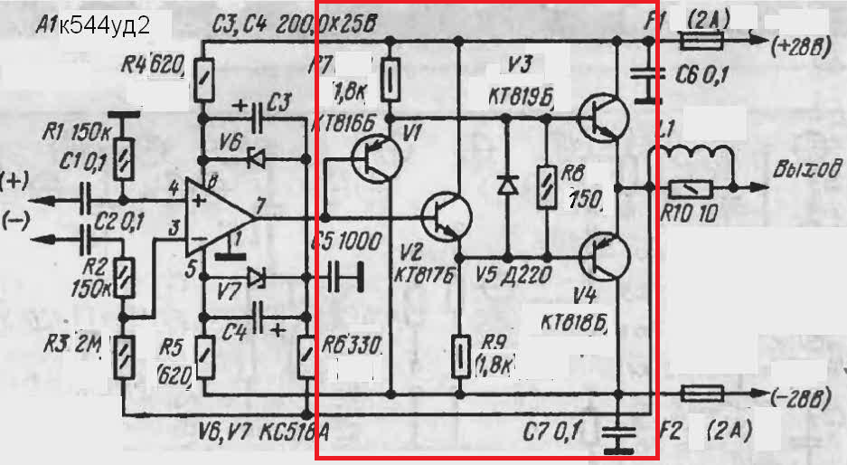

is this a response to a request to show the amplifier circuit?
Q3/Q4 arrangement reminds me of the Ageev amplifier, 198-something as far as I remember.
this is just a redrawn diagram of the AM-2 block 🙂
to tell the truth - with increased voltage to reduce TND
