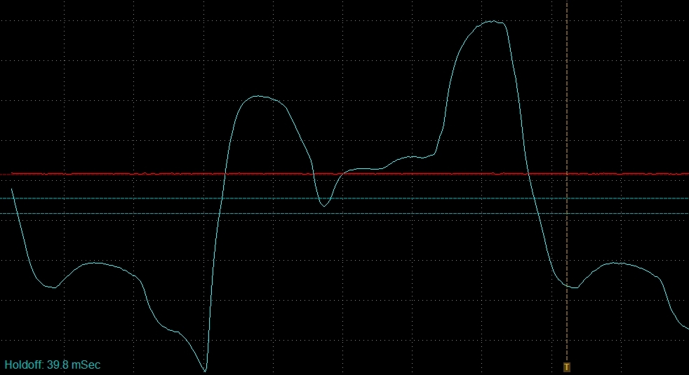

I connected the amp to loudspeakers 3 ways and scope to see if I could find anything.
At 3Vrms at 20 hertz the woofer is bottoming out, zero distortion, it does attempt at 10khz to make a square wave.
There is no ringing, nada, I thought lowering the feedback resistor from 2.2k to 2k would cause ringing , none,
It poorly does square waves past 10khz but this is not an issue, I tried to clip the amp at 6 Vrms at 10khz , no clipping.
Placing or removing the cover had no effect on the waves or resonance, or anything visible through the scope.

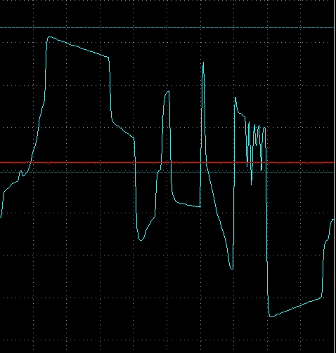

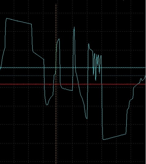

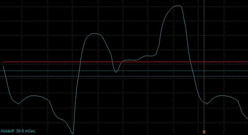

For pleasure and curiosity, I took two pictures of 670hz wave patters which repeats and are asymmetrical.
It is connected to 3 ways loudspeakers to take measurements at normal listening volume, guess which one is the solid state and which one is the tube, which one should sound best 🙂, note the pattern has a lot of irregularities and no oscillations, the amplifiers have a hard time reproducing the voltages in the loudspeakers, a lot of problem.

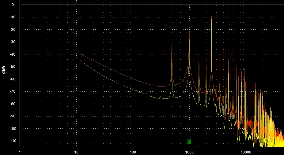

This is a preliminary test that I did to compare pentode + cathode feedback vs ultralinear, since then the pentode circuit performs a lot better. It is obvious that the sound of the P+CF is way superior, as easy confirmed by ear, I had the amp play some music and it was obvious that the UL was very 'good' for some standards but that the pentode had that clarity.
This test is done with two signals, main 1khz is at 1.5 watts, the 2khz, is at 1watt, approximately
I don't know why the values of THD are so high in that picture, but it gives a comparison idea.
The real numbers I will redo that picture with only the Pentode in Cathode feedback. I will post it tomorrow the final pictures of THD

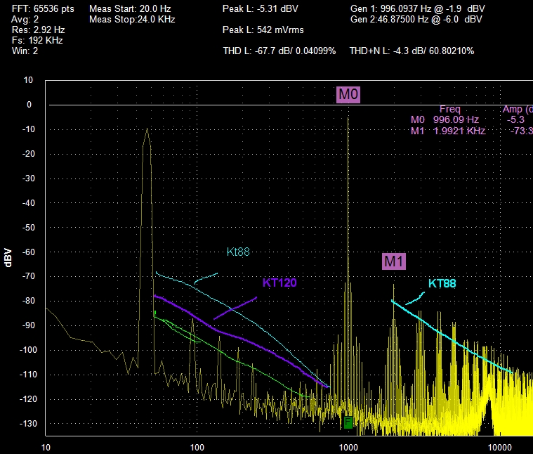

I did another arbitrary test with the kt88 amp and the solid state amplifier, this time at 4Vrms and a 100, 120 hertz type of signal, lower, obviously the control signal cannot be generated or intercepted properly by the ADC\DAC so I will show the control picture, the measured picture, it could simply a matter of capacitance. It looks like the solid state amplifier has a bit more digging and power for the previous tests connected to loudspeakers, now on the 8 ohm dummy load, both tube and solid state seems the same amplifier, for your viewing pleasure and utter confusion : (solid state left, tube, right)
I did an IMD 1kz,2khz test at same voltage, the Solid state amplifier has 5db more THD in second harmonics, then 2db more in other harmonics (3,4,5etc
You can see a picture of 46 hz + 1khz, I drew on the picture to simplify the comparisons... at around 8 watts.
at almost 2 watts, I did a single 1khz signal test, the tube kt88 gets 0.023% thd , the solid state amplifier 0.066, this represents 10db more second harmonics.
the solid state has -3db of 3rd harmonics.
But then for 4, 5, 6, 7 it has way more, the tube amp has -92db of 5, no 4, 6, 7 etc, all below 100db+
The solid state has -73.4 db relative of 4th harmonics then a cascade of , 5, 6, 7, 8 etc going -80db te o -90
The only other anomaly is that the SS has a regulated stable PS with independence of mains fluctuations, it has a lot less noise and no hum.
The tube amp has a fluctuating power supply with the main voltage which has quite an effect during measurements, it also has a lot of hum in the 120hz region.
Perhaps this is causing the sound to not sound open.

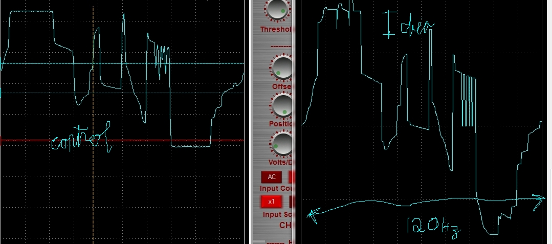

My tube amp has developed a high pitch cavitation noise on the Transformer, this is spread to the power tubes.
I think the heater winding is damaged from the kt120 heavy current, or a main input capacitor is damaged, no clue but looks like it is not going into the speakers.
Actually it is a very clear signal, like in the sample, and I can hear it through all my tube gears,
My main power amp has the resonance, and the tubes of my pre amp and tubes of my dac.
My pre-amp has a complex input filter for RFI and others So it should not be affected.
I know that today is very sunny, and many neighbor have solar panels on their rooftop which could send some EMI pollution and RFI, so it is weird that the main tubes catch it so strongly, in the basement it is less. I observed this before but today it is very very strong...

I can strongly hear it in the basement at lightbulbs base connections nearest the electrical panel.
It is very strange.
It is very strange.
Yes! It must be solar panels disturbing the ground and inserting ghz mhz crap in out mains... such a shame.
It subsidized, now I can only hear the buzz of all the CFLs and Diodes, which is lower, and it is more intense at night.
I did audition again with the modifications to the tube amp with the lower resistors, higher feedback and covers off (lol) and the dedicated single capacitors for the screens...
Well, the noise in the background lowered a lot and some atmosphere returned, the sound is more organic, more natural, the transistor has just a bit of lead in the bass definition but the tube amp is quite there, it is not as analytic but if you just listen carefully it has all the detail there that the solid state amp has.
