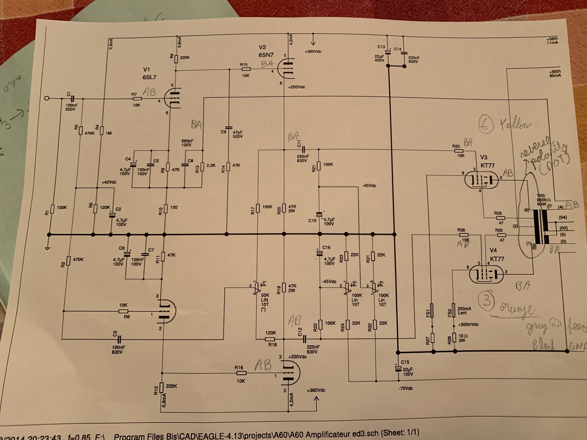

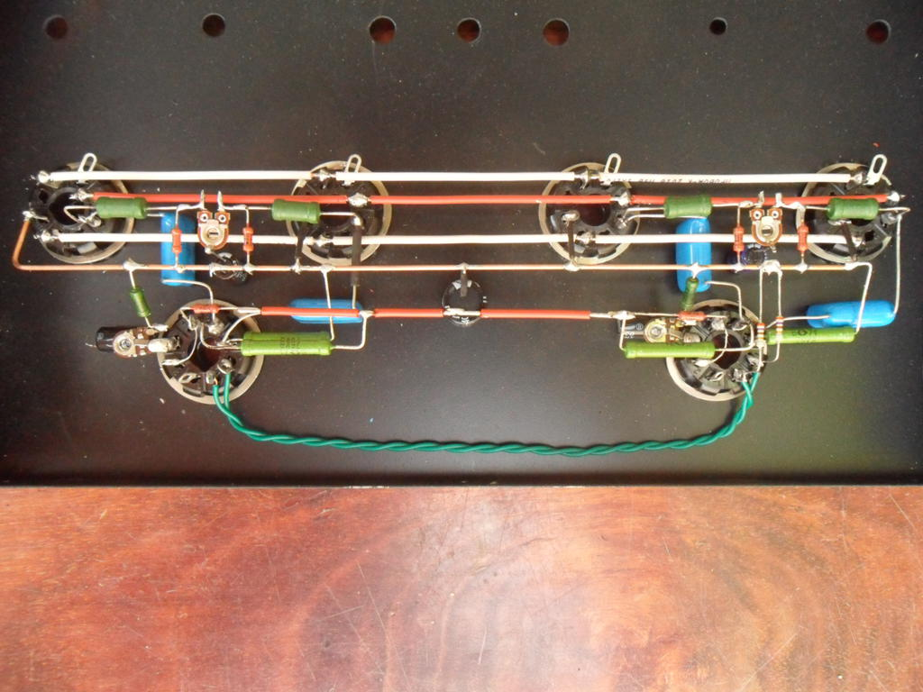

The channel which has this problem also has a 'scratch' noise when turning the volume button, it wasn't doing this before when it had the other transformer and working in UL.

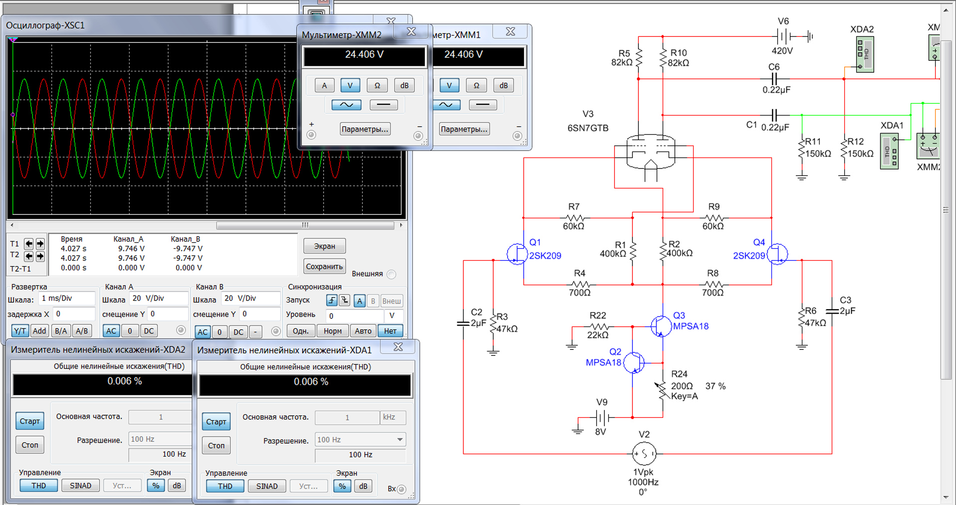

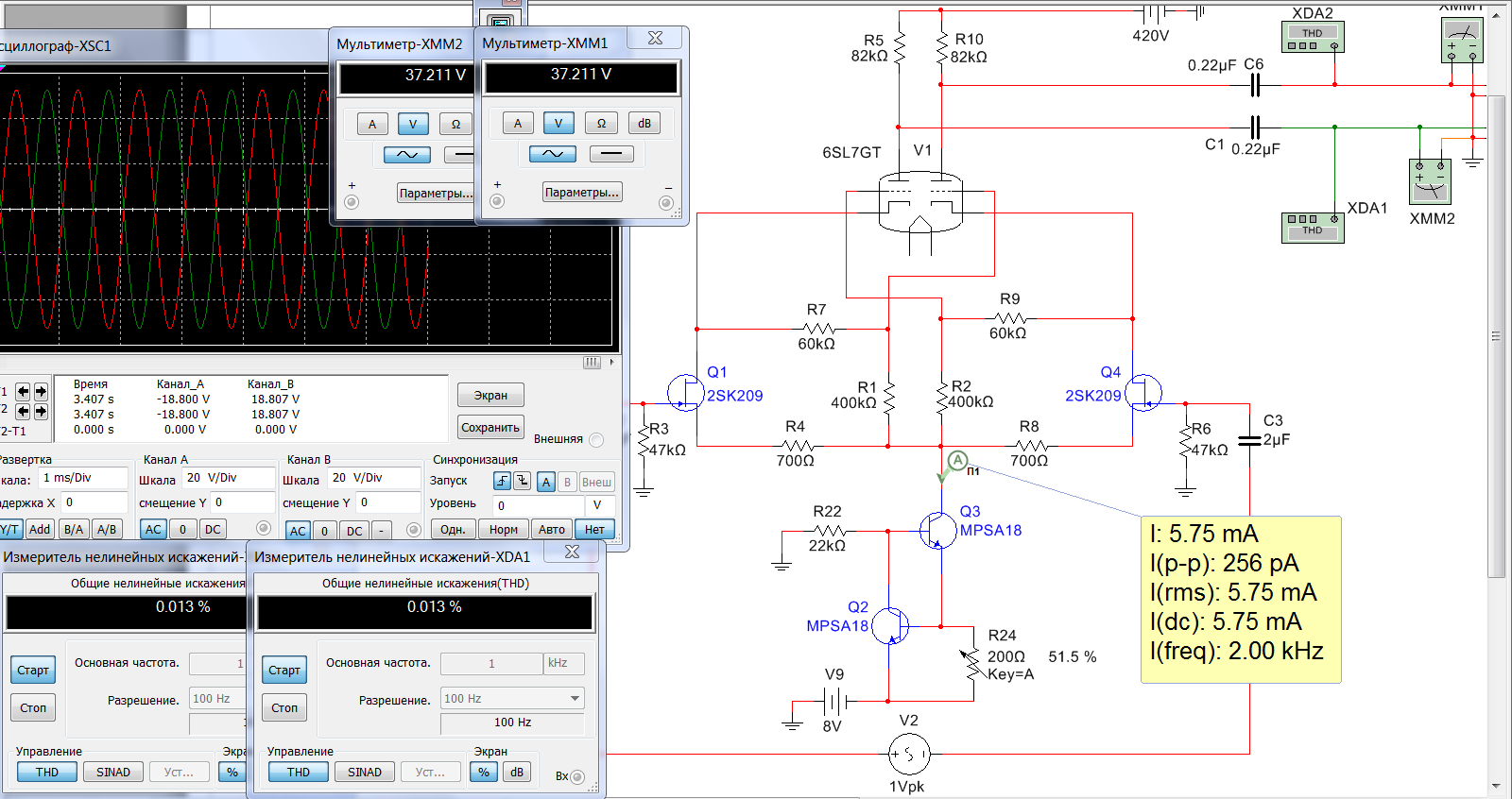

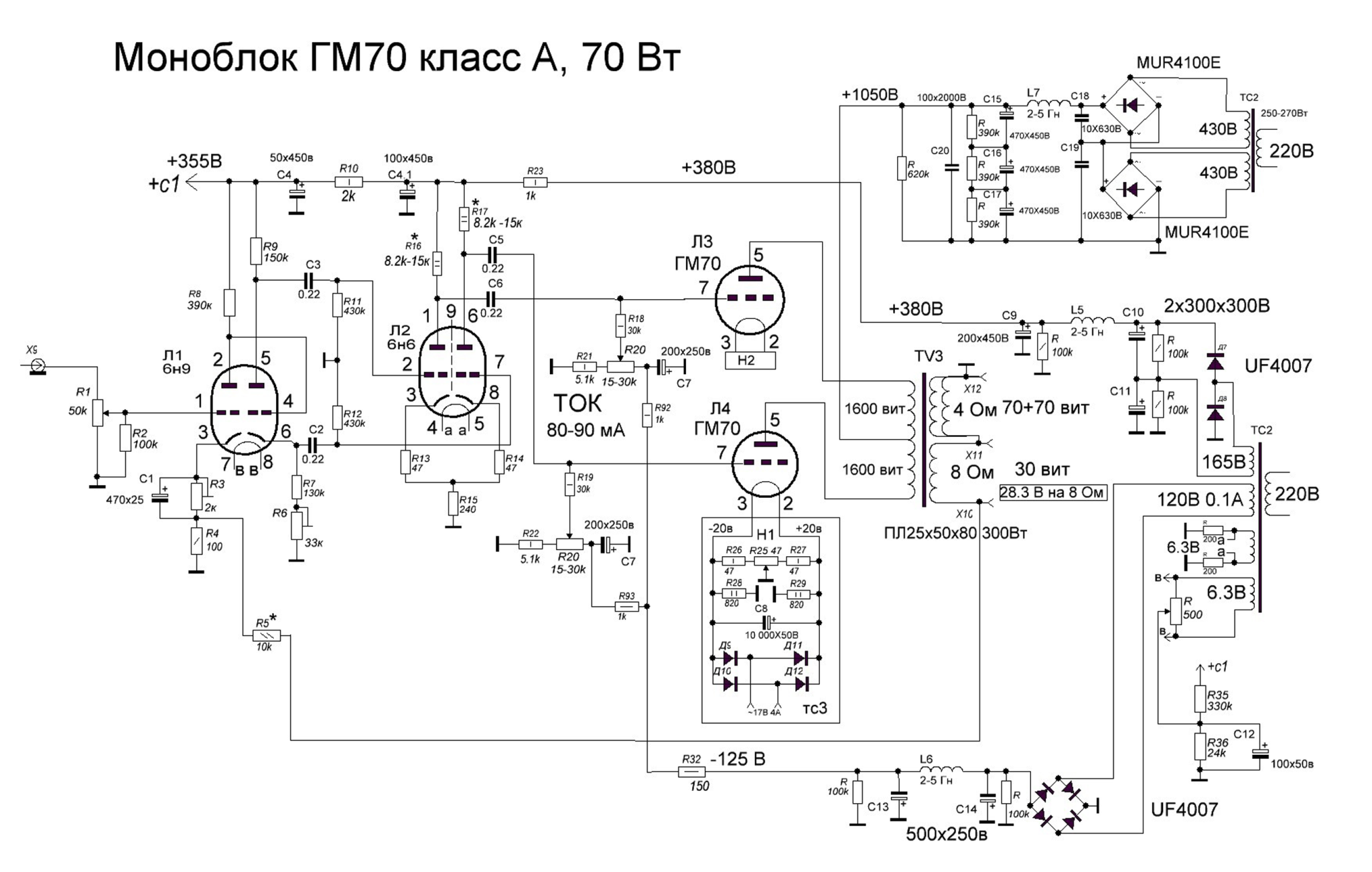

Food for thoughts: schematic link: (( this is a triode not ultralinear but so.. )) schematic from Japanese builder
very, very interesting!

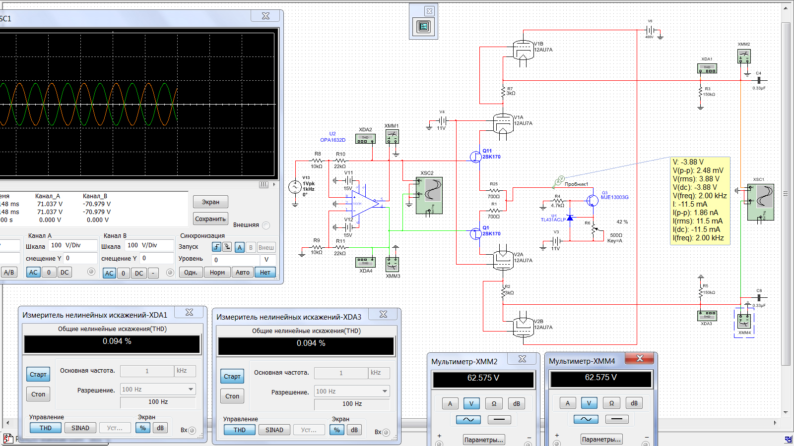

only FDA OPA1632, THS4131, ... are begging to be here
then at the output of the "phase inverter" - beauty ...
cathode feedback
cathode feedback
- this is the best that can be
true - you need a decent build-up from the phase inverter
but the nature-like feedback is the happiness and charm of the tube sound
a lot of problems of oscillation and so on
the installation must be short and in a steel case
Beautiful!!! ,
I removed bypass capacitor and found the problem!!!
I thought it was bad tube, bad ground resistor, bad feedback cap, bad coupling cap.
The problem was a wire touching another one!
AND the feedback loop is inverted somehow, now I removed the contact that touched and I reversed the connection of the output transformer.
I have to draw something to explain it.
Your built is awesome!! Thank you for sharing it with me!
I was so distrusting now my abilities to make this amplifier (which was perfectly stable before) , during the modification I must have bent the wires without knowing it.
This made me order two solid state mono power amplifiers.... the only amplifier that I know would be great.
But now the path is clear again to amazing tube sound, nothing like I have heard before. I might even attempt the ultralinear + cathode feedback combination.

Multisim! Right now I am lost into pentode with cathode feedback with a lot of problems of oscillation and so on
Do you know if it makes a difference if I connect the 8 ohm tap to Ground and the 0 output tap to the feedback,
Instead of reversing the primary of the OT? , I am just lazy and changing 8-0 output taps is easier than reversing all the primaries , which is 6 wires per channel...

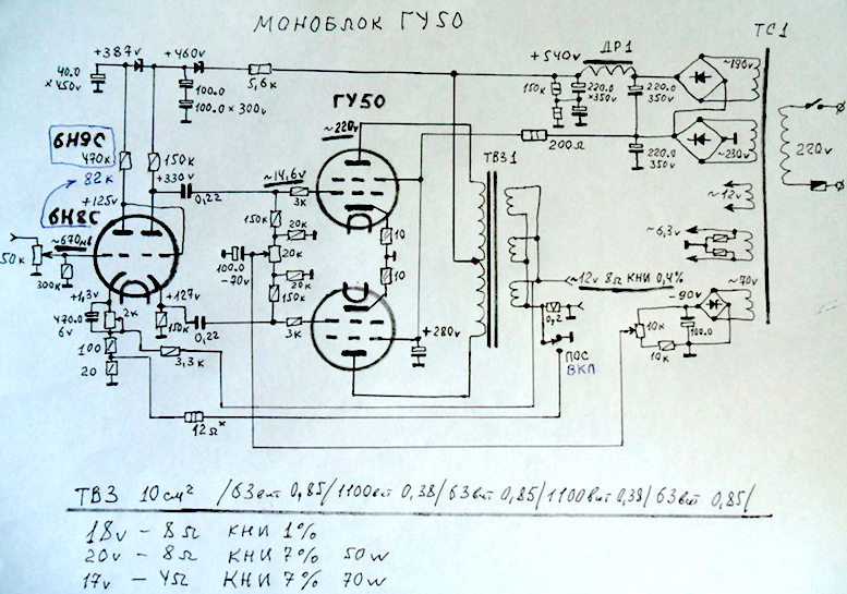

Ideally I would love to have the 6sn7 at input in parallel common anode, followed by another 6sn7 and transformer/splitter driver
35 watt in Class A !!!
right now I connected the 0 ohm to feedback, and the 8 ohm to ground. Should work...
Svytoslav, I am familiar with 6h9c I use it and it is very good, can't hear anything bad about this nice tube.
I am not familiar with other tubes. I wasn't able to make the 6n6p ever work or the 6n1p, very problematic for me.
here it is not possible to change the power supply of the second grid relative to the anodesbut in GU50 - it is easyby changing the power supply of the second grid - we change and match the audio transformer with the load at the minimum TND
