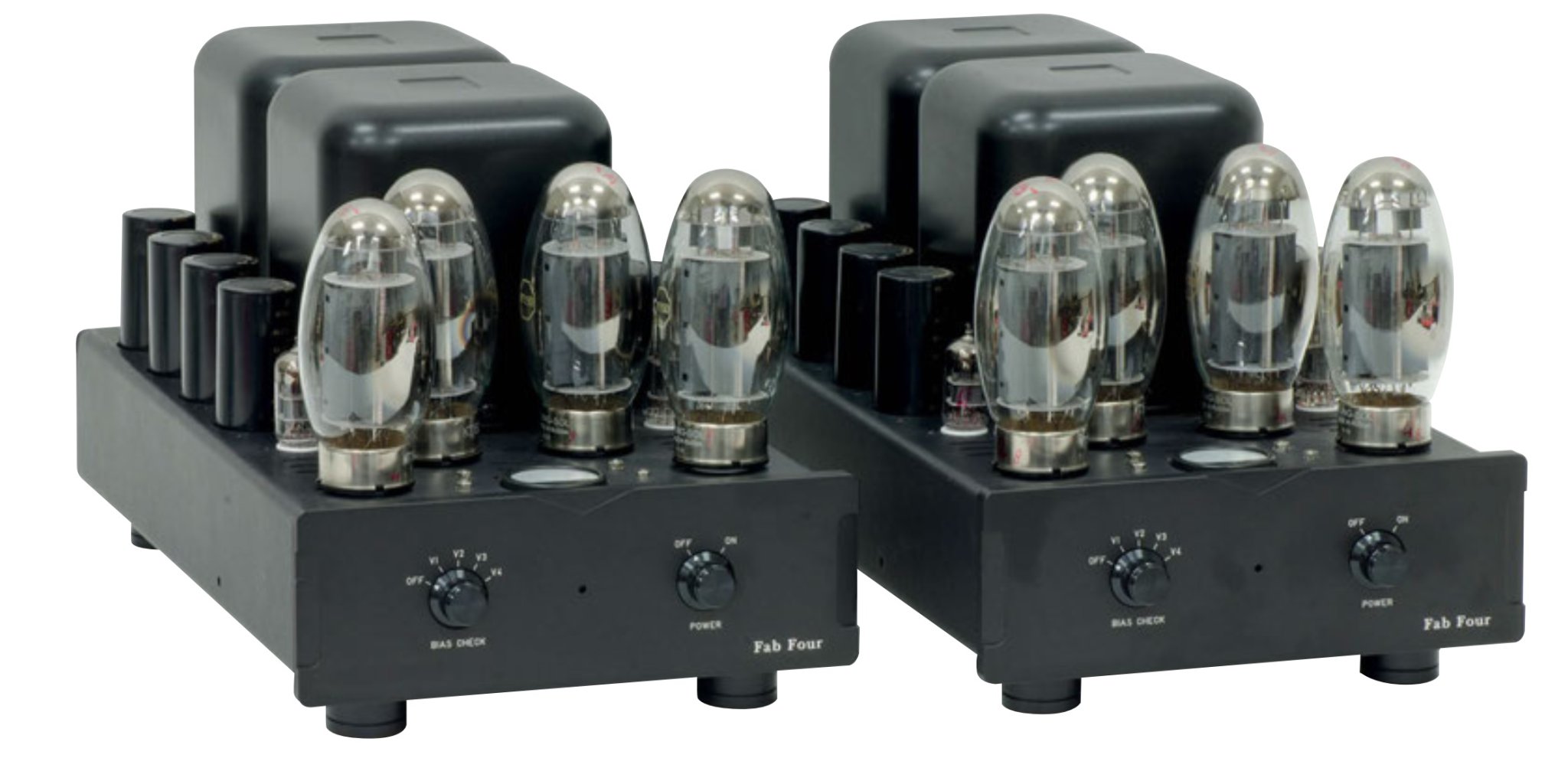

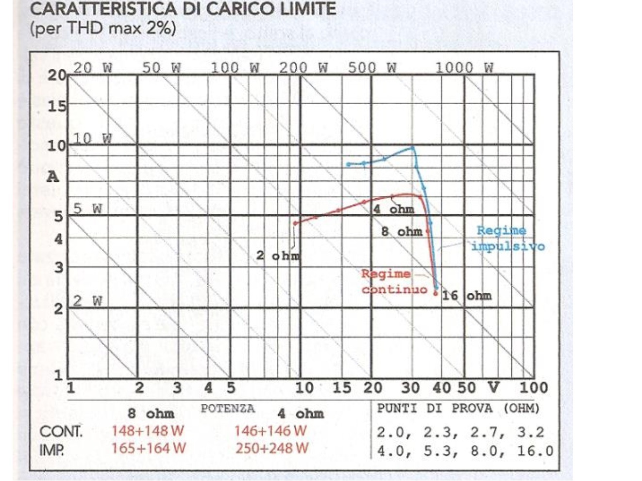

As posted time ago I will resend a big ones I made time ago after testing the KT120 but then using a KT150A big parallel PP amp to my mind is about power, about annoying neighbors and rattling window's & a bit of willy waving, if that's your bag : ) Actually a good PPP design is about biasing it so it mostly sits in class A
On the seconf photo there is a test to check the power vs load continous and impulsive.

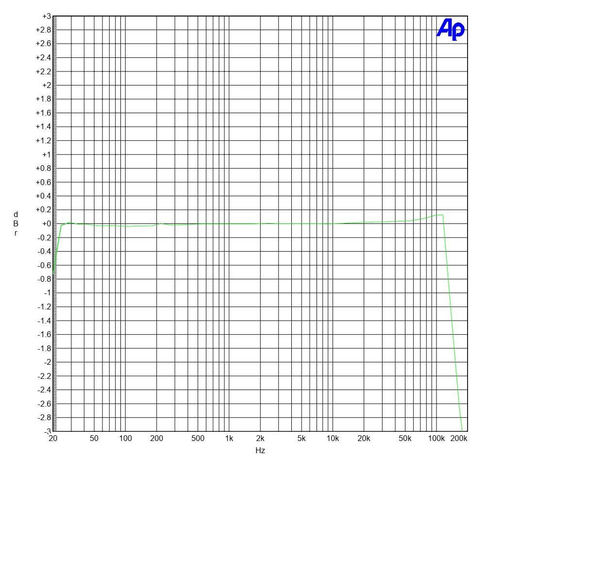

This amp use a E88cc , 6H30 as phase spiltter. Tetrode connection
The secondary is fixed at 5 ohm
The bas is around 40 mA with Va around 500 Vdc
So it is in class A until 8 watt rms
The third is a response at 100 watt - 8ohm with 16 dB of feedback
