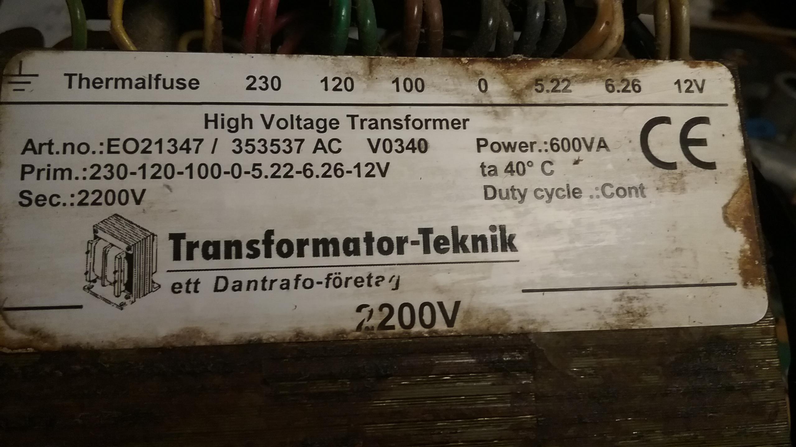

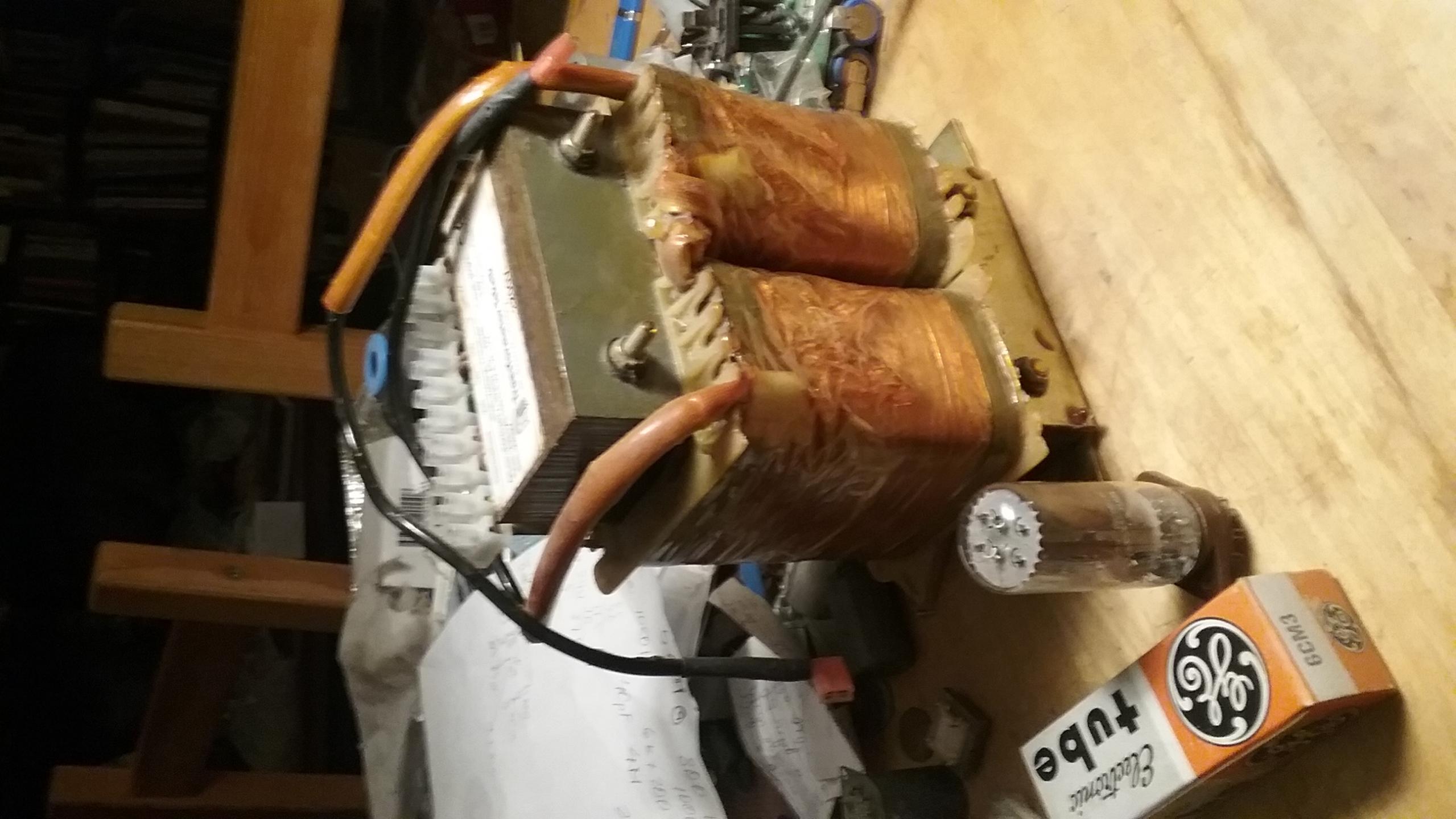

Im gonna help a friend with his GM70 build, we found two identical tek transformers out of 545 scopes. Those puppies give 140VA + 2X 115VAC each, if you work it out you end up with six rectifiers and six capacitor for just the high voltage supply.
True that high voltage power transformers with center-tapped secondary are things of the past. It is either NOS, or expensive custom job. I have several such transformers that I acquired over the course of years. One is 1,800 vct from a Heathkit transmitter, quite a beast. Another, which I am going to use in my GM70 project, is a new production German thing, 600 VA 2,200 vct, with 6.3 V windings, perfect for a 6CM3 full wave rectifier.
