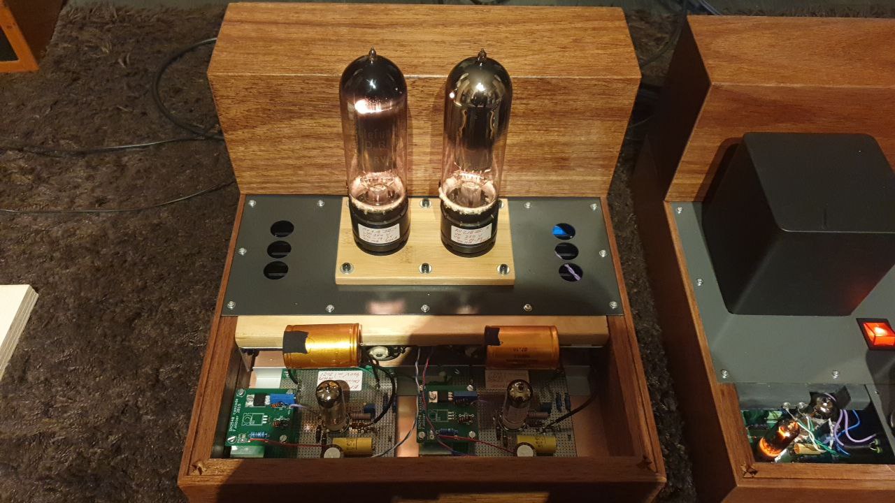

I gave that a shot, and got under 300uV on my friends 6A3/6B4G. but the tread got derailed by bickering. It has all the bells and whisles. and i have the board files online for free.
Heres an RV218 amp he built with them. Hes running one of my tube reg designs to give .2mV of ripple

V4lve lover,
Your friend has a nice looking amplifier.

I know what you mean. thank you i will pass on the compliment.
