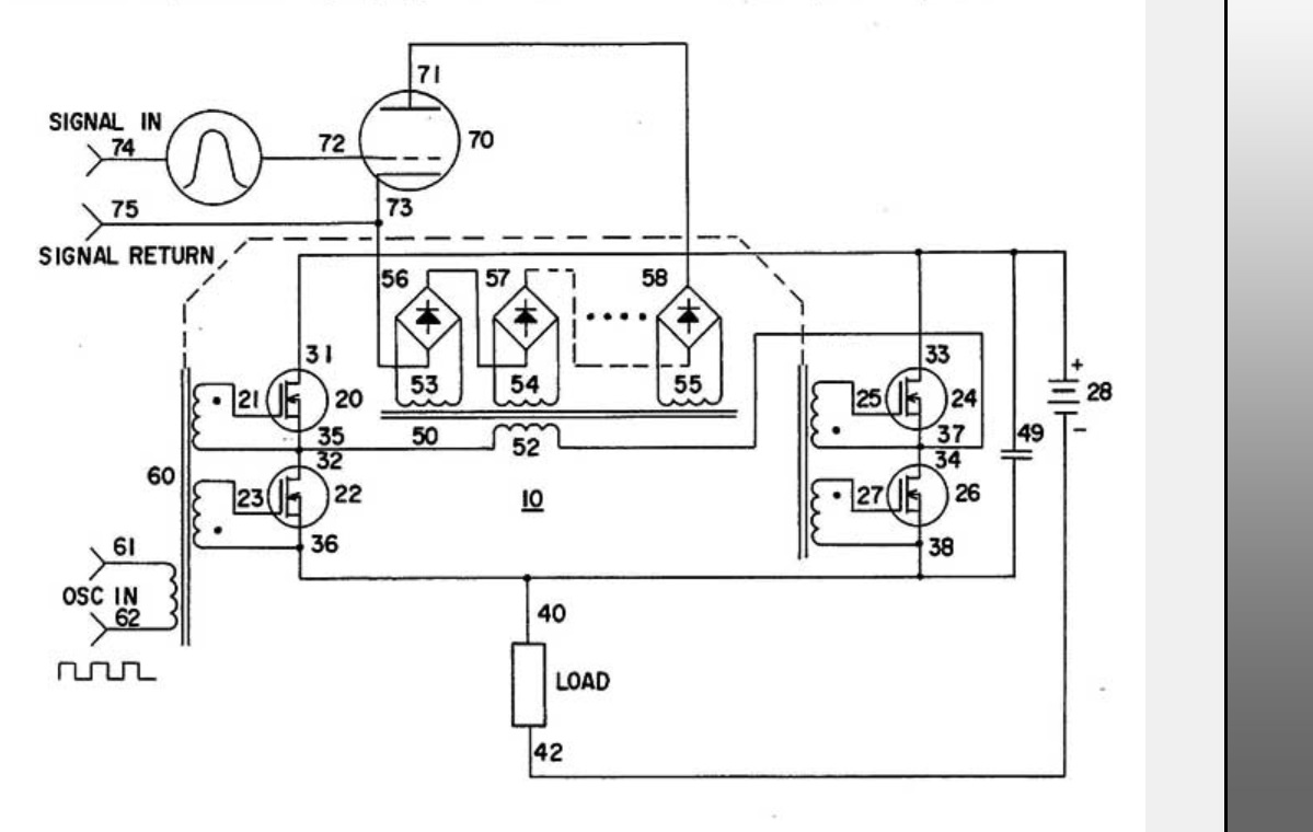

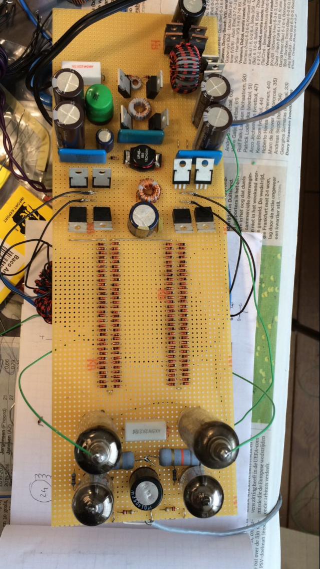

These are diode bridges, each bridge can handle about 75V @500Khz, This can not be done with standard diodes so i need fast switching diodes. As the voltages here can be several hundreds i need to stack the bridges.
UF4007 is fast enough to do so i think.

75uS reverse recovery time against 8nS of the 1n4148
BAV21 then? Sorry i was trying to be smart

its an H-Bridge that creates a square wave switching the magnetic field on these transformers (step up), But the audio signal is not . By doing so the tube can be fed with a dc voltage and the result on the output would also be a true DC offset (not possible with a "standard" transformer).
