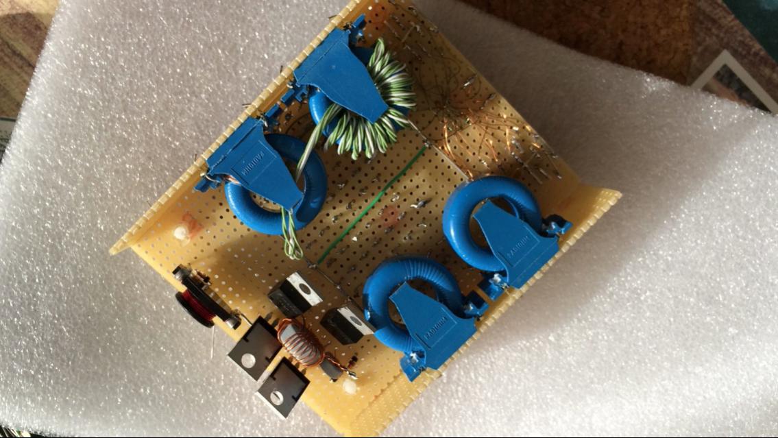

Ive been down that road before: my advice. instead of building monoblocks. Build two chassis one for the amplifier one for the power supply. And just push DC through the umbillical cord.
Only join all the supplies for your amplifier in the amplifier chassis at a central star ground and you're all set.
You can cut down on the losses somewhat if you use the LT4320. If you use reasonably good mosfets that have relatively fast switching times. A standard 25A bridge has horrible switching characteristics.
I use RURG6030 diodes for these kind of things nowadays, but i have a dozen 4320's i still have to use. im quite adept at rolling my own PCB's
I actually sold some regulators to someone that wanted to upgrade an existing amplifier, and using 4320 we actually got the headroom needed to run from a normal 10VAC winding for a 813 Push-pull. He was lucky enough that his transformer winder built in a lot of margin and it ended up fine.
For the HT, im quite the oddball, i have some very high performance tube regulator circuits to my name.

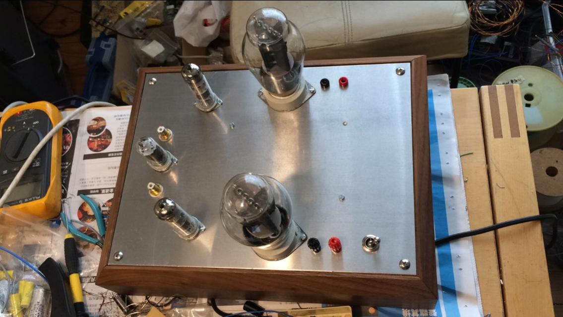

We know residual B+ hum tends to cancel in PP stages, the same going for the heater supplies - higher PSRR for PP. Can we get away with AC then? What about IMD?
I've built two PP 300B amps using AC filaments. With the output tubes properly balanced, they were dead quiet on my ProAcs.
So yep you can cancel the 50Hz hum with a balance pot and get no hum on each plate. The PP also cancels the hum too so you may find multiple positions of both pots where there is no hum from the speaker. However you will still see 50Hz sidebands on the 1KHz tone until you get both in the right place. The 100Hz hum does not cancel on each plate but does on the PP. So you will still be left with 100Hz sidebands on the 1KHz signal.
