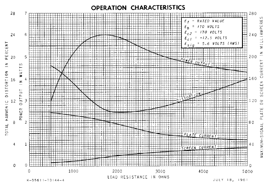

This graph is for a single EL86 (6CW5, actually) with plate voltage and screen voltage at 170V. I'd be using the 6P43P with Vp = 265V and Vg2 = 245V.
The above graph shows the deepest distortion null for a single EL86 pentode at about 2100 ohms. For push-pull class A operation, you'd double that. So now we're at 4200 ohms.
For highest power output, the peak for a single EL86 pentode is at about 1750 ohms. Again, double that for PP class A, and now we're at 3500 ohms.
So a PP primary load somewhere between 3500 and 4200 ohms would seem to be the sweet spot.
Push-pull EL86 into a 4k p-p primary load seems like a pretty good spot. I would want it a little on the high side with the higher plate and screen voltages. That's why I was thinking of using the Z565 with a nominally 6 ohm speaker on its 8 ohm tap. That speaker's impedance curve does dip down to 4 ohms, but they all do these days.

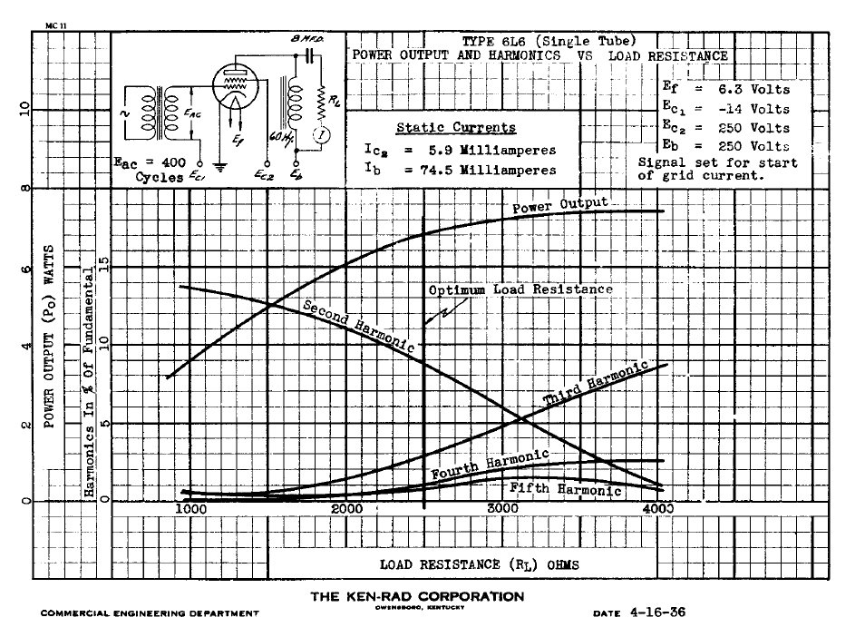

I was also thinking about the profile of harmonic distortion vs. OPT primary impedance.
In this graph from the data sheet for the old metal 6L6, the primary impedance is varied with power output and the various levels of individual harmonics charted, for pentode operation with 250V on both plate and screen:
The optimal load impedance for single ended pentode operation is shown as 2500 ohms.
Lowering that to 1500 ohms reduces the power output by a third, but H3 is now practically absent, with H2 up a bit. In push-pull operation, H2 from the output tubes would be at least partially cancelled in the OPT, would it not? That would argue for going lower than optimal for cleanest operation open loop.
This is the opposite of the situation for triode operation. For power output triodes, raising the primary impedance reduces THD along with reducing power output, while lowering primary impedance increases both power output and THD.
Keep in mind that the above graph (and the one for the 6CW5/EL86) were drawn with no NFB applied.

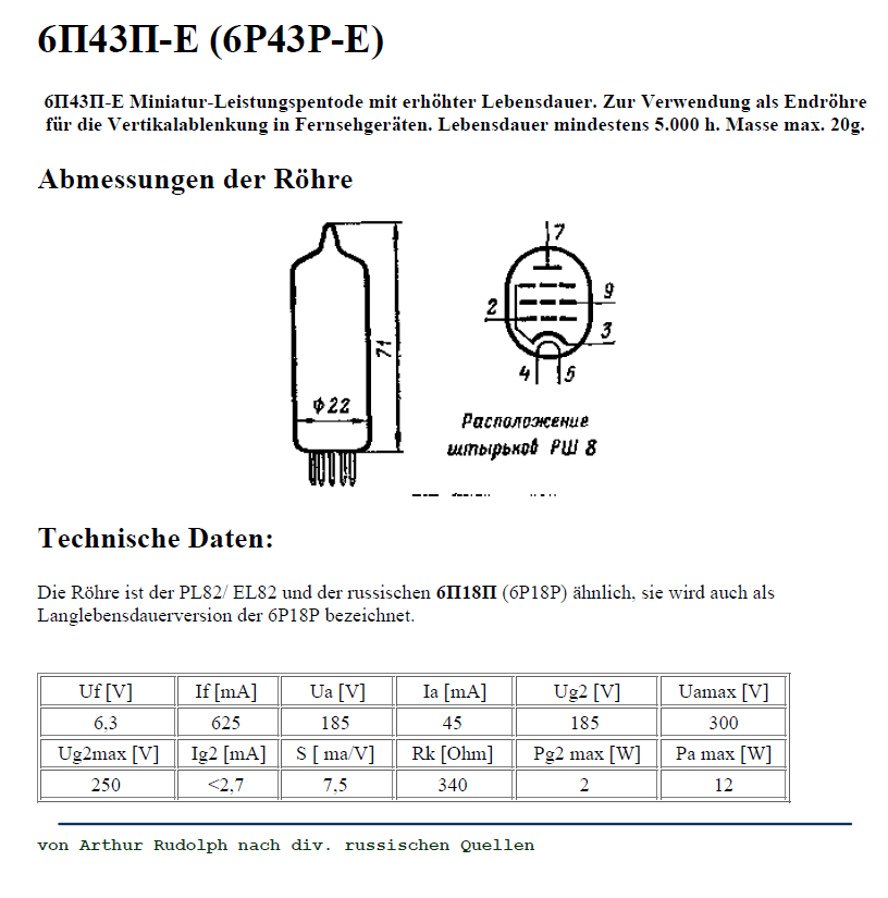

Re. the 6CW5/EL86 G2 voltage I've done some reading since I bought a couple dozen Zaerix PL84 (the euro 300mA heater version of this tube) a while ago. I seem to remember that the key to success for a long tube life was to keep the screen grid voltage low (170V), especially when the plate voltage is on the high side to maximize output power.
Just putting this out there, for a data point.
It's the insert/data sheet from a brand-new-in-the-box 6P43P-E, USSR era.
I believe it lists the max plate voltage as 300V, and the max screen voltage as 250V.
The max plate dissipation is shown as 12W; max screen dissipation as 2W.
Here's a translation to German I found somewhere, years ago...
That also shows the max Vg2 voltage as 250V.
The German author seems to think the 6P43P-E is similar to 6P18P, so he shows the specs from a 6P18P data sheet. Strangely enough, they line up with the Soviet data sheet in the first graphic.
Of course these things are relative. I think if you use an EL86 with a plate voltage >350V, you'll need to keep the screen voltage down under 200V. But if you keep the plate voltage at 265V? Wouldn't that allow you to safely raise the screen voltage?
Perhaps the russkies are a bit sturdier than their western equivalents, I don't know?
