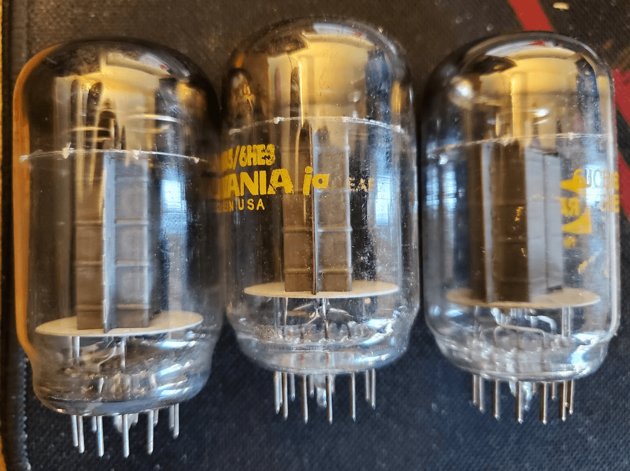

Back when they were a buck each, I got a bunch of Sylvania and a couple of Raytheon painted "6JC5/6JB5/6HE5" from ESRC.
The Sylvania and Raytheon tubes look identical inside and all are etched "FJCE" on the glass, like the two on the right, below. The one on the left has its paint rubbed off, but is etched "6JC5/6JB5" (no mention of 6HE5).
Which are these? 'Real' 6JC5? Relabeled 6JB5? Could any of these be relabeled 6HE5?

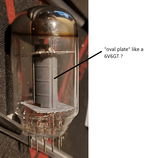

I have seen two different plate structures in the 12 watt 6HE5. One looks like the oval plate from some 6V6GT's and the other is a box plate much like a 6W6. Many 6JB5's have the same plates. All 6JC5's and tubes with all three numbers should have the larger box plate with a ridge in the center, or a plain box plate with slightly rounded corners. I have a box full of these things somewhere, but I can't find it now.Which are these? 'Real' 6JC5? Relabeled 6JB5? Could any of these be relabeled 6HE5?

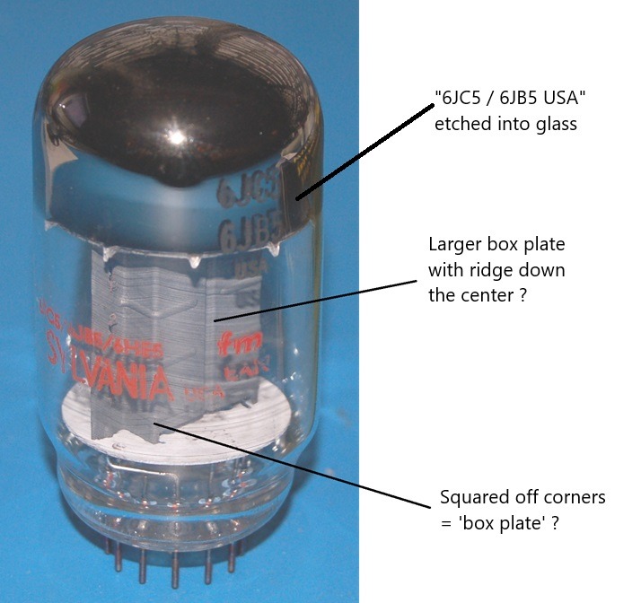

OK, so I have two kinds of 6JC5s.
One I think is the 'box plate with ridge down the center':
Is this a 6HE5 "with the oval plate from some 6V6GT's", masquerading as a 6JC5/6JB5?
Just from looking at them, I'd think the one with the larger, squared-off plate would dissipate more heat than the smaller, oval-shaped plate. But I don't know much about this stuff.

Yes, the box plate version in the top picture is the 19 watt version. The etching shows two type umbers but the red Sylvania paint shows all three. The bottom tube might be able to eat 15 watts if it was properly assembled.
