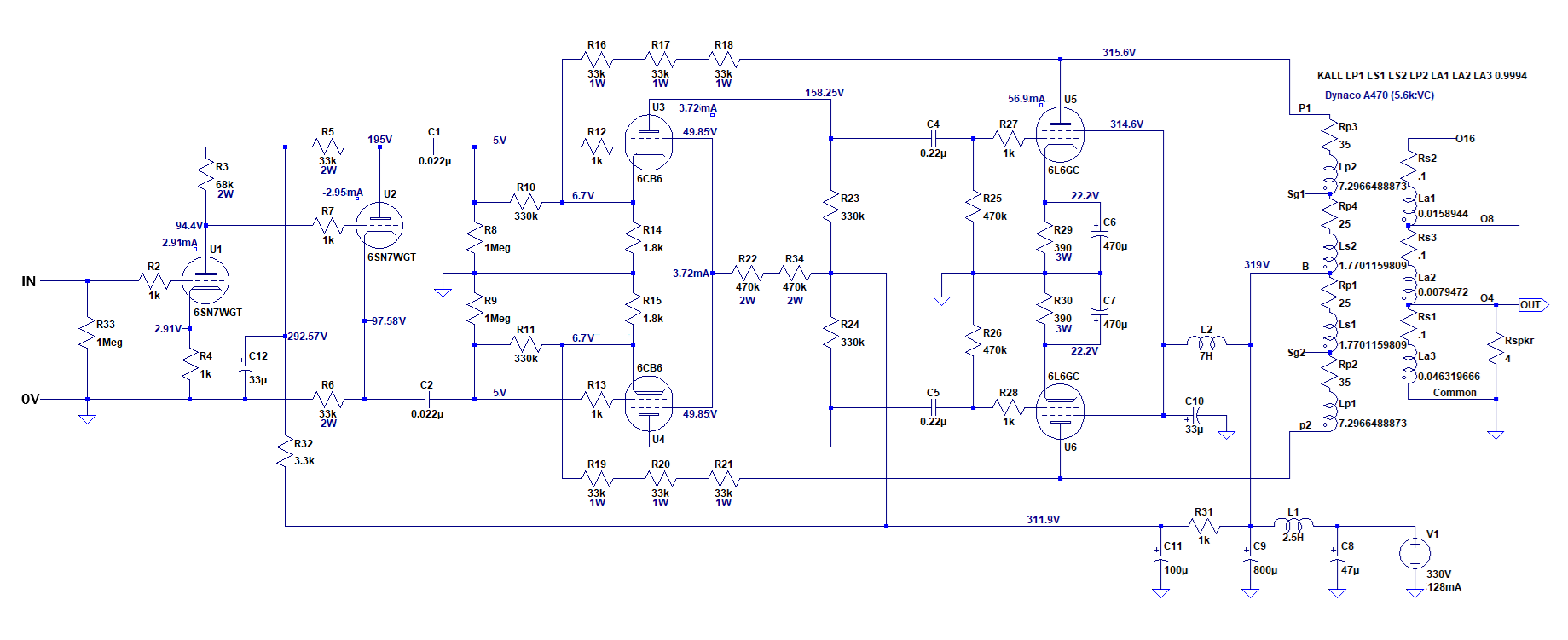

I think I'm settling on this circuit, below. I have all the iron for it, and I have a chassis that's big enough to fit it all. I'll have to strip that chassis (it was a PP 2A3 thing that developed a mysterious problem that I was never able to fix...) and then I'll need to punch a few new holes for tube sockets. Nothing major, and the power supply stuff is almost wired already.
Here's my proposed circuit:
I've seen a lot of good reviews of both the O-Netics and Heyboer OPTs.
- Low B+ (330V) with 150mA per channel power transformers means I can run 6L6GA or 6P3S outputs low and hot, mostly in class A operation. This reduces the 3rd harmonic distortion, leaving 2nd harmonic dominating until nearing clipping. I figure that should 'sound good'.
- The 6L6 outputs dissipate 16.7W at idle, which is well within the limit of 19W or 20W for 6L6GA, 6L6GB or 6P3S (not the -E version). But that's beyond what I would ask of 6V6GTA, and those are expensive now, so I don't want to burn them up unnecessarily.
- Simulation says I should get 18W per channel at 1% THD.
- At 1W out, THD should be really low (0.015%) with 3rd harmonic distortion 10dB below the 2nd harmonic.
- I don't have any 6CB6 so I'm going to use 6CF6 instead. I have some 6AU6A in stock (same pinout), in case the 6CF6s don't work out.

I'm sorry, I was calling the 6AU6 differential pair a 'long tailed pair' -- which is incorrect. My bad.
I'm still planning to use a 6FQ7 concertina for the input stage and phase splitter.
An LTP first stage would be a great idea. You don't need more gain, so a pair of low-mu triodes should work fine. 5687 at low plate current would probably work well. Maybe 6DJ8?
I decided against an LTP phase splitter first stage because then the harmonic distortion spectrum would have a dominant H3, and also because of the added complication of getting a CCS into the tail. I wanted to try to get a dominant H2, hence the concertina. The distortion profile seems to be dominated by that first stage. Change the 6FQ7 to a 12AU7 and the THD goes up significantly.
My question was whether the 6AU6 diff pair needs grid stoppers. Does it?

There's no hard and fast rule regarding the inclusion of grid stoppers. You could try it without grid stoppers to see if there's any parasitic oscillations. You could include the stoppers as a matter of course since they won't do any harm if not required for damping out parasitic resonances.Do you think R12 and R13 are necessary? Does the LTP need grid stopper resistors?
My usual practice is to include 1K grid stoppers and 470R screen stoppers for pentode gain stages. so far, no probs. It's the power finals where you really need stoppers since some types (807) love to make snivets when going into plate current cutoff. Adding 1K5 screen stoppers put an end to that.
