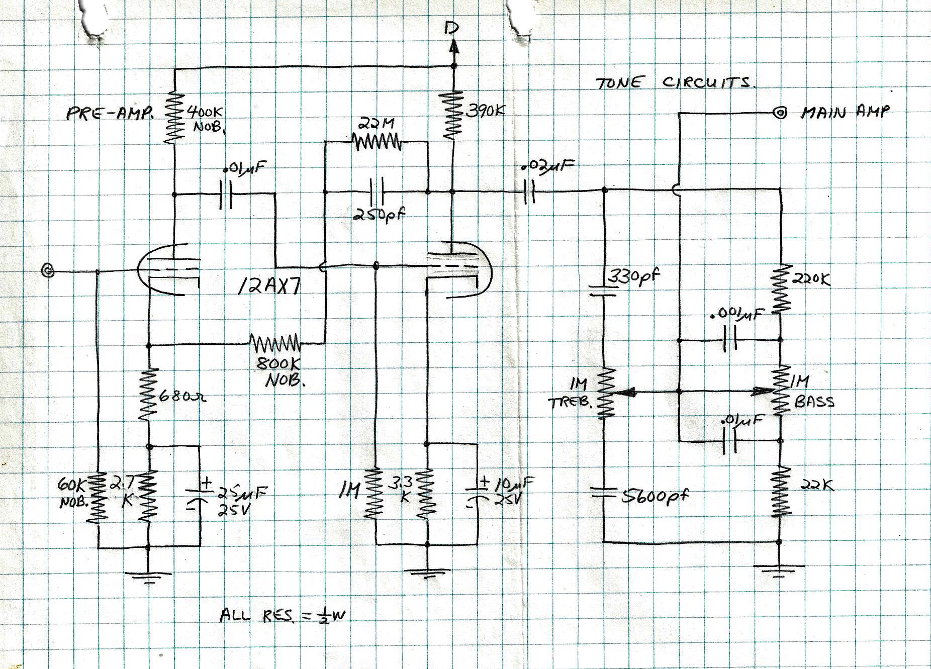

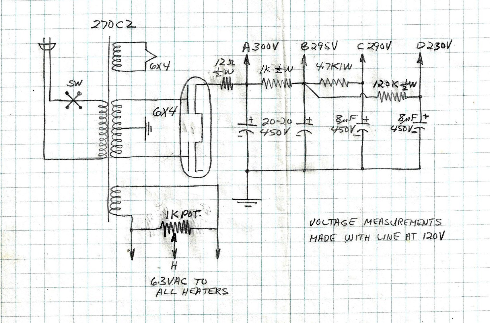

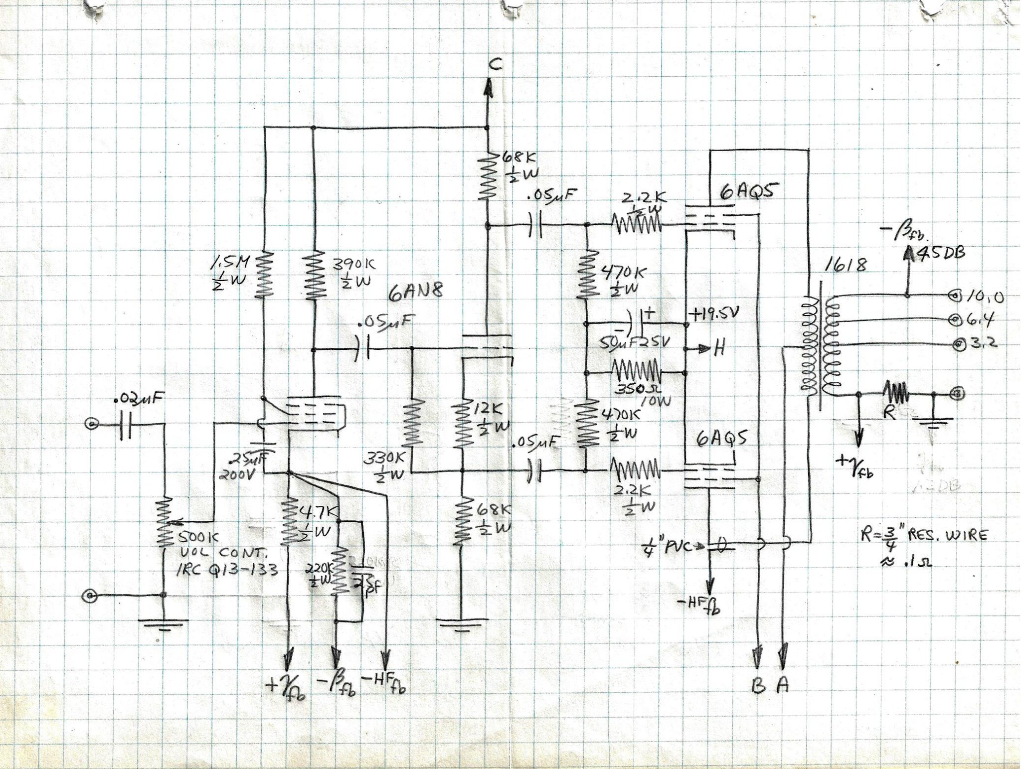

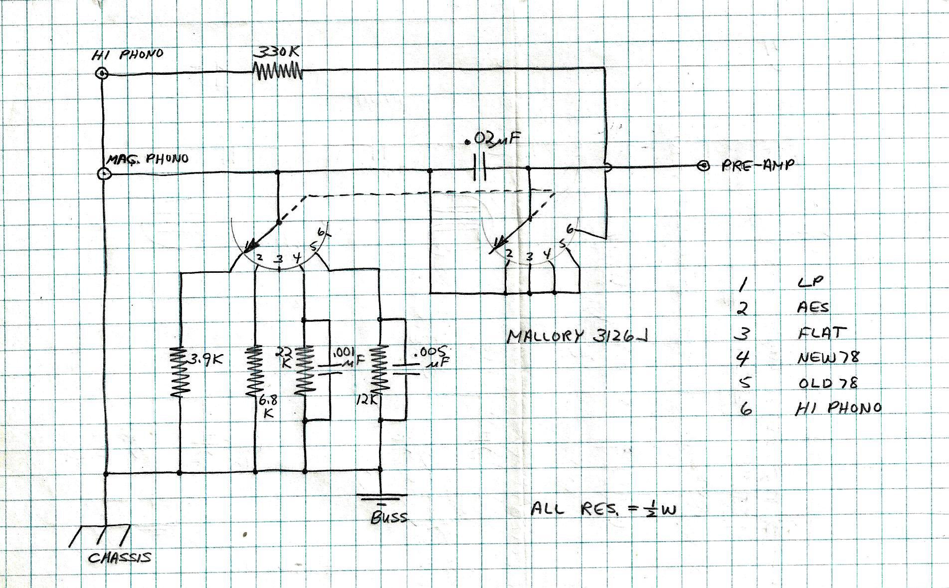

The back page on this one tells me I built it Aug 1956. It went to a former Luftwaffe pilot I met while working at DeHavilland, an aircraft factory in Canada. He eventually became a dentist & practiced here for many years.
Other than the positive current FB sensed by a short piece of resistance wire this amplifier is very ordinary. Positive current FB reduces the output impedance. The connexion to the current sense could be just as well hooked up the other way round in which case the current FB becomes negative & output impedance would increase. Or a low value resister on each side of the common with a pot across the pair & the FB can be adjusted from positive to negative. That is how Electrovoice & others did it.
Negative output impedance can be easily had which cancels some of the speaker voice coil resistance. The speaker resonant peak inverts, too much FB & the circuit becomes unstable.
All the iron is Hammond. The OPT is meant for a public address amplifier, only limited NFB is possible. The Hammond 1600 series today is much better.
There was some HF ringing at the front edge of square waves, that was mostly fixed by a ‘gimmick’, a short piece of insulated wire tied to one of the OPT primary leads. In some unrelated tests later I found there is something like 200 pF more capacity to the OPT core from one of the primary leads than the other. I’ve included some tests I used to sort out that problem here. The capacity unbalance does create more problems when stabilizing a FB amplifier. I’m sure the Hammond OPTs of today are much better than in the 50s.
There are several articles covering amplifiers like this in Volume 3 of Audio Anthologies published by Audio Amateur Press, 1990
6AQ5 PP Amplifier with Positive Curent Feedback Input Selector.jpg424.7 KB · Views: 140
6AQ5 PP Amplifier with Positive Curent Feedback Power Supply.jpg377.9 KB · Views: 131
6AQ5 PP Amplifier with Positive Curent Feedback Preamp & Tone Controls.jpg534.9 KB · Views: 143

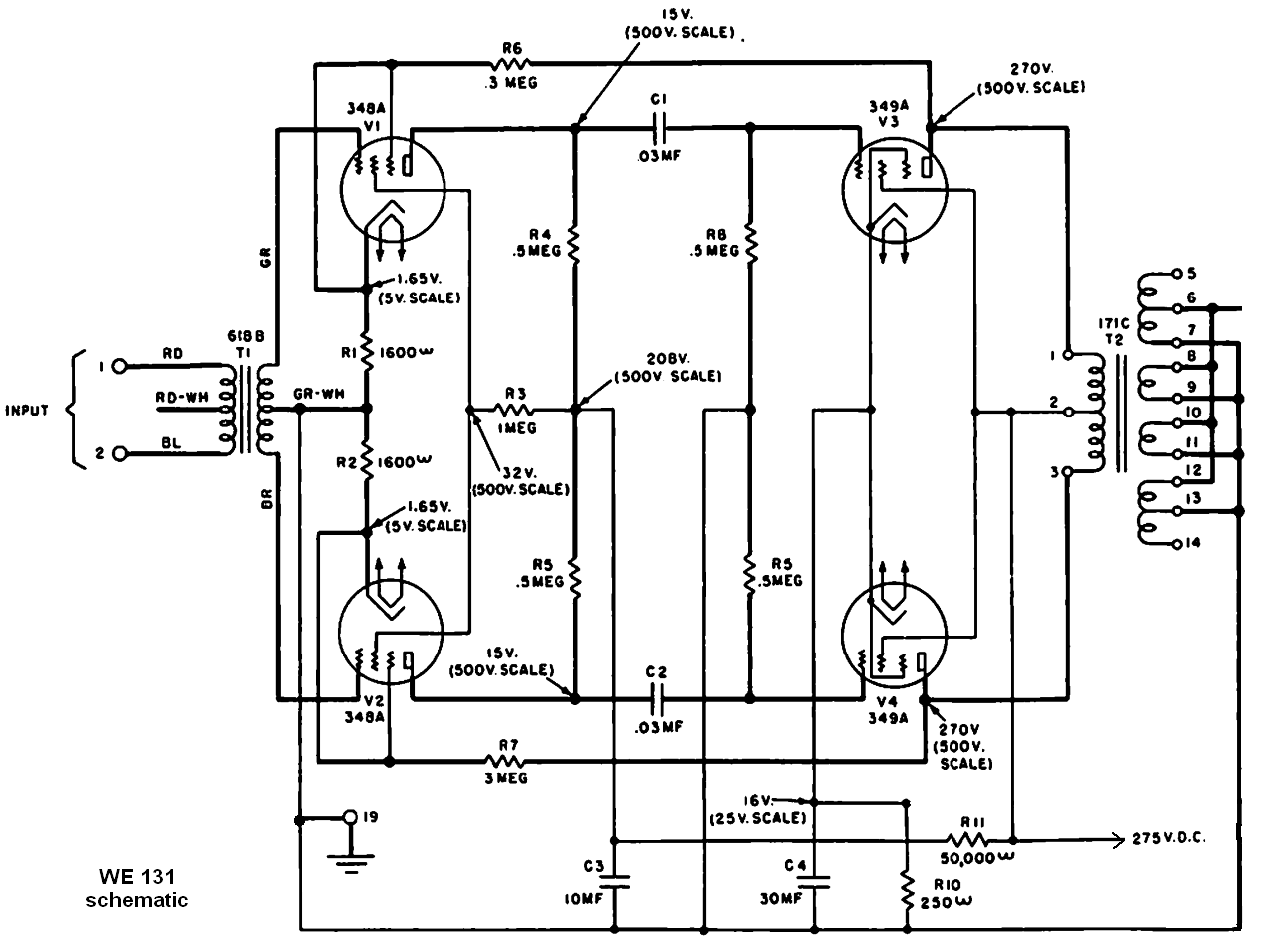

Looking through old emails, I found this circuit from a diyAudio post from about a year ago. It's a schematic from a Western Electric amplifier using a differential pair of 348A (similar to 6J7) driving a pair of 349A (similar to 6F6 or 6V6), again using that local negative feedback scheme from output pentode plate to driver pentode cathode.
The output pentode plate (349A) to driver pentode (348A) cathode feedback resistor is 300k ohms.
Note the voltages on the 348A differential driver pair.
The voltage at each cathode is 1.65V.
That voltage drop across 1600 ohms means plate+screen plus feedback current for each 348A is 1.03mA.
The 349A plate voltage is 270V, while the 348A cathode voltage is 1.65V. That's 270 - 1.65 = 268.35V.
268.35V dropped across 300k ohms means current draw there is approximately 0.895mA.
Plate voltage isn't shown, but the voltage at the screen grids is way down at only 32V.
The B+ voltage to the 348A pair is only 208V. The screen resistor is 1M ohms. 208V - 32V = 176V, which divided by 1M = plate current of 176uA for both 348As, or 0.088mA plate current for each 348A.
So now we have 0.895mA + 0.088mA = 0.983mA
Each 348A draws 1.03mA, so 1.03 - 0.983 = a very measly 0.047mA plate current for each 348A.
Each 348A has a plate load resistor of 500k ohms.
500,000(0.000047) = 23V dropped across the plate resistor, so plate voltage = 203V - 23V = 180V.
That all works out to:
Vp = 180V
Ip = 47uA
Vg2 = 32V
Ig2 = 88uA
Infb = 942uA
Vk = 1.65V
Ik = 1.03mA
Here we have an extreme version of that diff-pair pentode driver in a current-starved state.
