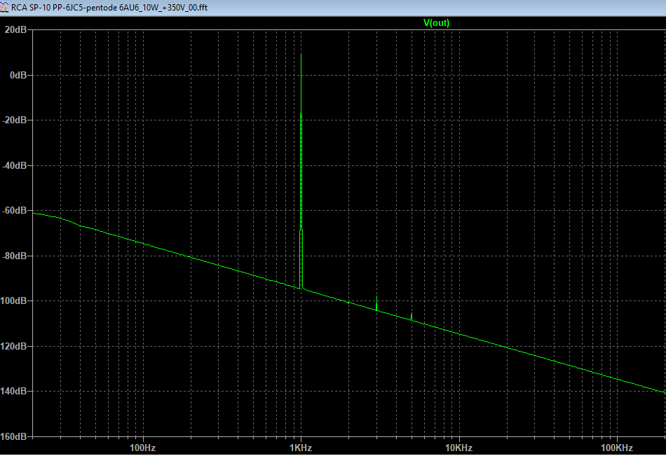

I wish I knew how to simulate IMD. I'll look into that.
I look at the virtual scope FFT in LTspice all the time, to gauge what clipping behavior looks like. I want to see the least amount of upper harmonics possible, as well as no resonances at ultrasonic frequencies.

The more I look into this circuit, the more it seems those RCA engineers really knew what they were doing. If I swap the driver tubes to 6EJ7 and bias them so that they each draw 2mA plate current and 1mA screen current, the THD goes up to 0.015%, but significantly, that is all H3, as the H2 is cancelled by balanced CMR. For some reason, that current-starved 6AU6 scheme results in lower H3 to the speaker load. Now this is all in an idealized environment and in simulation only. But, I've found that if I simulate a circuit very carefully before I build, the final result will be pretty close to the sim. That's pretty cool, if you ask me.
So far the best I can do is:
  • Replace 6AU6s with 6CB6 (reduces THD by half, plate current goes from 325uA to 470uA).
  • Replace 6V6s with 6JC5 (reduces H3). Here's something that should make @6A3sUMMER happy: The 6JC5 data sheet says its maximum allowable grid leak resistance for cathode bias operation is 2.2Mohm. I put 1Mohm in the simulation. Thanks again @smoking-amp !
  • With 3.5V peak signal into the driver stage and output stage only, closed loop, the result is that the THD for 1kHz sine wave at 1W out into 8 ohms is 0.002% (!!!).
Again in simulation, the output impedance (Zout) for 1kHz signal at the 8 ohm speaker tap appears to be less than 1 ohm, something like 0.3 ohm. Too good to be true? (I measured it in simulation by reducing the value of the load resistor at the 8 ohm tap until the voltage across the load was -6dB down from what it was across 8 ohms.)
Whatever input-phase splitter I choose will have to deliver a clean 12V peak signal per phase to preserve that low distortion. It looks like all the THD comes from the original 12AU7 circuit. Does this current-starved pentode diff stage w/ feedback from the output tube plates present a difficult load to the previous stage (phase splitter)? Does the phase splitter need to have a really low Zout and be able to sink a fair amount of current into its load?
I found out that the original SP-10 used a Stancor A-3311 output transformer. In the Stancor catalog from 1983, it's shown as rated for 25 watts output, but its max plate current is 70mA per side (each output tube). Frequency response is rated at 60Hz to 20kHz. I think that 25 watt rating is inflated a bit. If the transformer was rated for 30Hz output, the max power out would probably be 15W or maybe 10W.
I have a pair of Transcendar 8k:4 ohm 35W OPTs I got just before the nice guy who wound those closed down the business. They don't have UL screen taps, so this might be a good project for those.
On the other hand, it might be that this circuit does better with the higher 10k ohm plate-plate load, to reduce current demands at low frequencies, etc. I'll look into that...
Update --
I was running all these simulations with a model of a Hammond 1608 OPT, 8k ohms to 8 ohms.
I just updated that to a model of a Hammond 1609 OPT, 10k ohms to 8 ohms.
That reduced H3 even more. Now it's basically non-existent at 1W out into 8 ohms. The FFT looks like the output from an op-amp.
This is probably too good to be true, and is sure to be spoiled by psu noise and whatever voltage amp/phase splitter stage comes before the PP driver stage, but it sure does look good so far.

rongon,
1. If LTspice can generate 2 sine waves, and apply them to the amplifier input, then you can see the Intermodulation Distortion Products on your simulation FFT.
My Denon Audio Technical CD: THE two sets if 2 tone IMD test sine waves:
2nd Order Intermodulation tones: 250Hz and 8020Hz. The 250Hz tone is 4 times more voltage than the 8020Hz tone (+12 dB more amplitude at 250Hz than at 8020Hz).
You will see the 2nd order intermodulation distortion, it appears as 250Hz upper and lower sidebands on the 8020Hz tone (at 7770Hz, and 8270Hz).
I think 4:1 voltage amplitude is per SMPTE standards (Society of Motion Picture and Television Engineers)
Where are jhstewart9, and so many others who can chime in?
3rd Order Intermodulation tones: 11kHz and 12kHz. The voltage the two tones are Equal voltage (different than the standard 2nd Order test @ 4:1 voltage).
You will see the 3rd order intermodulation distortion, it appears as 10kHz lower sideband, and 13kHz upper sideband.
Note, because the difference of 11kHz and 12kHz is 1kHz, guess what . . . you will also see the 2nd order IMD product at 1kHz.
I hope this helps you and others who are wondering.
Please let us know if you are able to do this in LTspice.

Thanks for the ideas. That does help.
I think I can get two sine waves playing by defining two AC voltage generators and put them in series, swinging the grid of the input stage. I can define what frequency and amplitude I want from each. So yes, I think this can be easily done.
Question about the IMD measurements:
  • How do I choose signal levels? Do I adjust them to get a certain output into the speaker load, e.g., 1W?
  • It might be difficult to figure out the command to run a transient analysis on two sine waves at the same time.

I like your idea of putting the two sine waves in series.
Suppose that a single sine wave of 100mV rms gives 1 Watt out.
You know what your amplifier gain is, so you know how many millivolts rms gives you 1 watt out. (1 Watt into 8 Ohms is 2.828Vrms, or 4V peak, 8V peak to peak)
Again, suppose 100mVrms gives you 1 Watt out. 100mVrms is 141.4millivolts peak
So, set the 11kHz sine wave to 50millivolts rms, and set the 12kHz sine wave to 50millivolts rms. When the 2 sine waves are briefly in phase, there will be
+141mV peak positive, and in the opposite direction -141mV peak negative. The is the same as a single sine wave of 100mVrms.
The point is to make the sum of the two tones to be the same as the peak voltage you would use for a single sine wave.
Your output at 1% THD is 8.5 Watts.
You might set a single sine wave for 5 Watts out, and then set the sum of the 2 tones to be the same amplitude as the single sine wave.
I think the FFT function will show the original 2 tones, and the upper and lower sidebands that are at 10kHz and 13kHz.
As long as you can find the relative dBc from the tone to its upper and lower sideband, you can calculate the percent distortion.
I do not know if the FFT will calculate the distortion % or not.
For the 2nd order IMD, set the 250Hz tone to 80mVrms, and the 8020 tone to 20mV rms (that has the peak equivilent of the single tone @ 100mVrms).
That example shows the proportions, but you will need more or less voltage to make the tubes swing as far as 1 Watt, 5 Watts, or whatever Wattage you select.
This is all about setting the sum of the two tone peak voltages the same as the single sine wave peak voltage.
Just set to rms volts or to peak volts, use the same for the single sine wave, as you do for the sum of the two IMD tones.
I am finding it hard to make it clear, I hope you can figure it out.

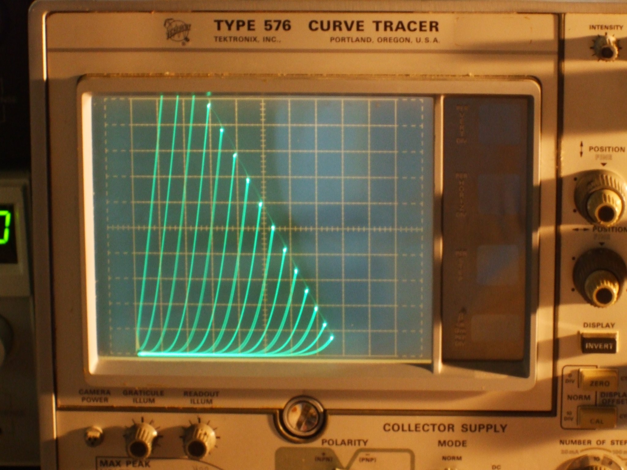

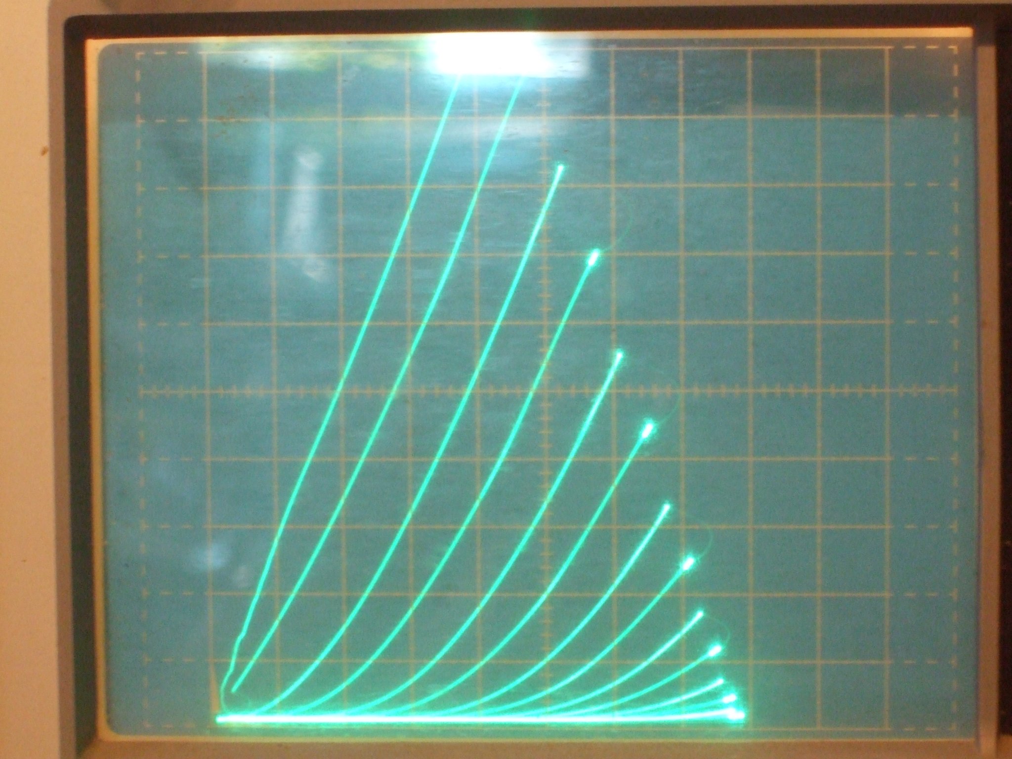

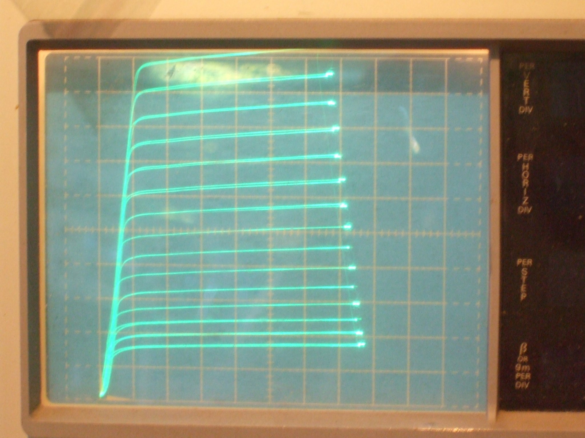

Some curves for the 6J11 tube I promised earlier. Sorry for the delay, kayak trip then a hiking trip got in the way.
All 50V/div Horiz.
1) Sylvania 6J11 pentode, 2 mA/div Vert., 0.1 Vsteps, 110 Vg2
2) Sylvania 6J11 triode mode 5 mA/div Vert., 0.5 Vsteps
I tried a GE 6J11 and it was identical
Then I tried some RCA, GE, and Zenith 6BN11 tubes and they were identical in pentode and triode.

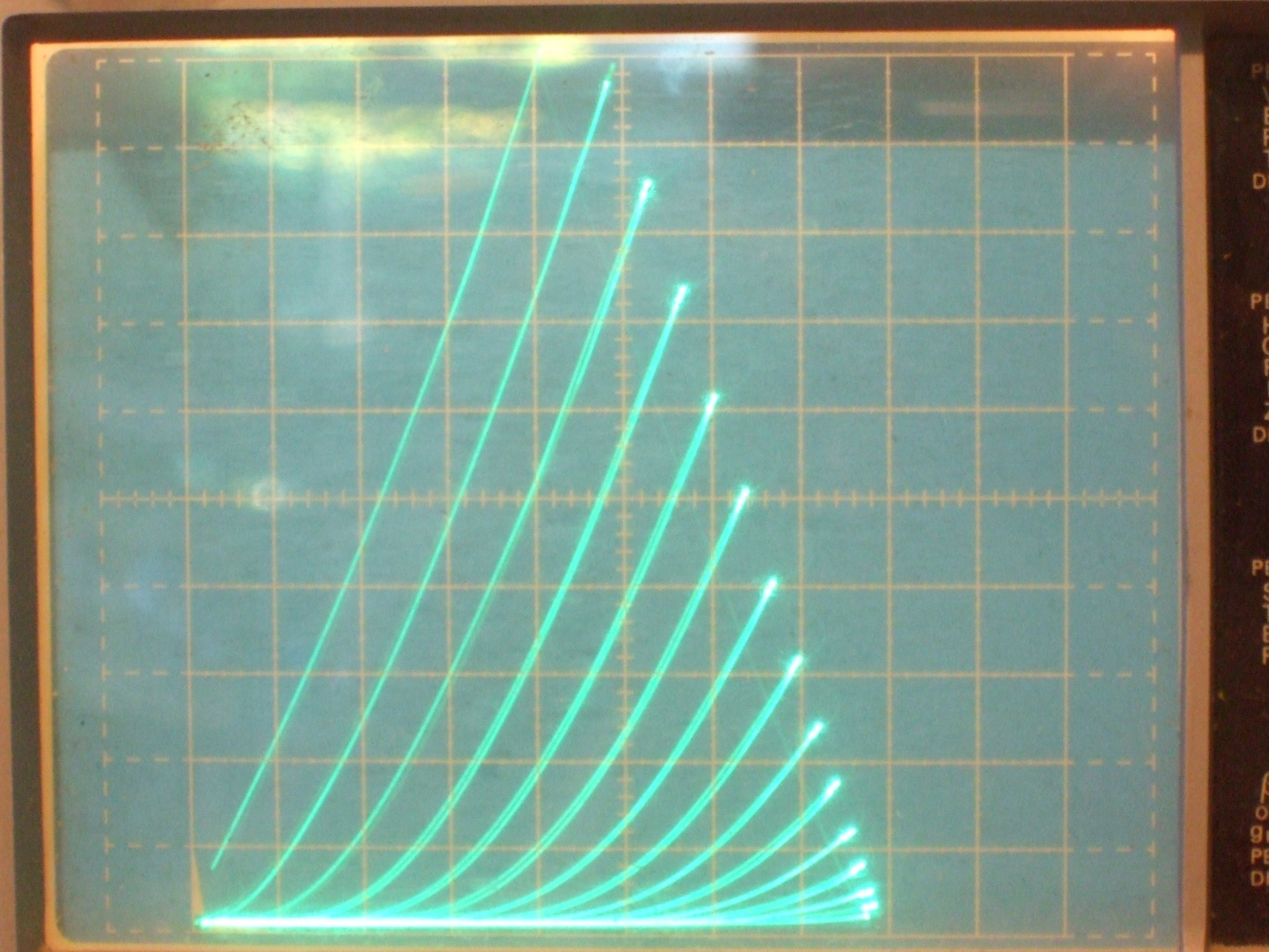

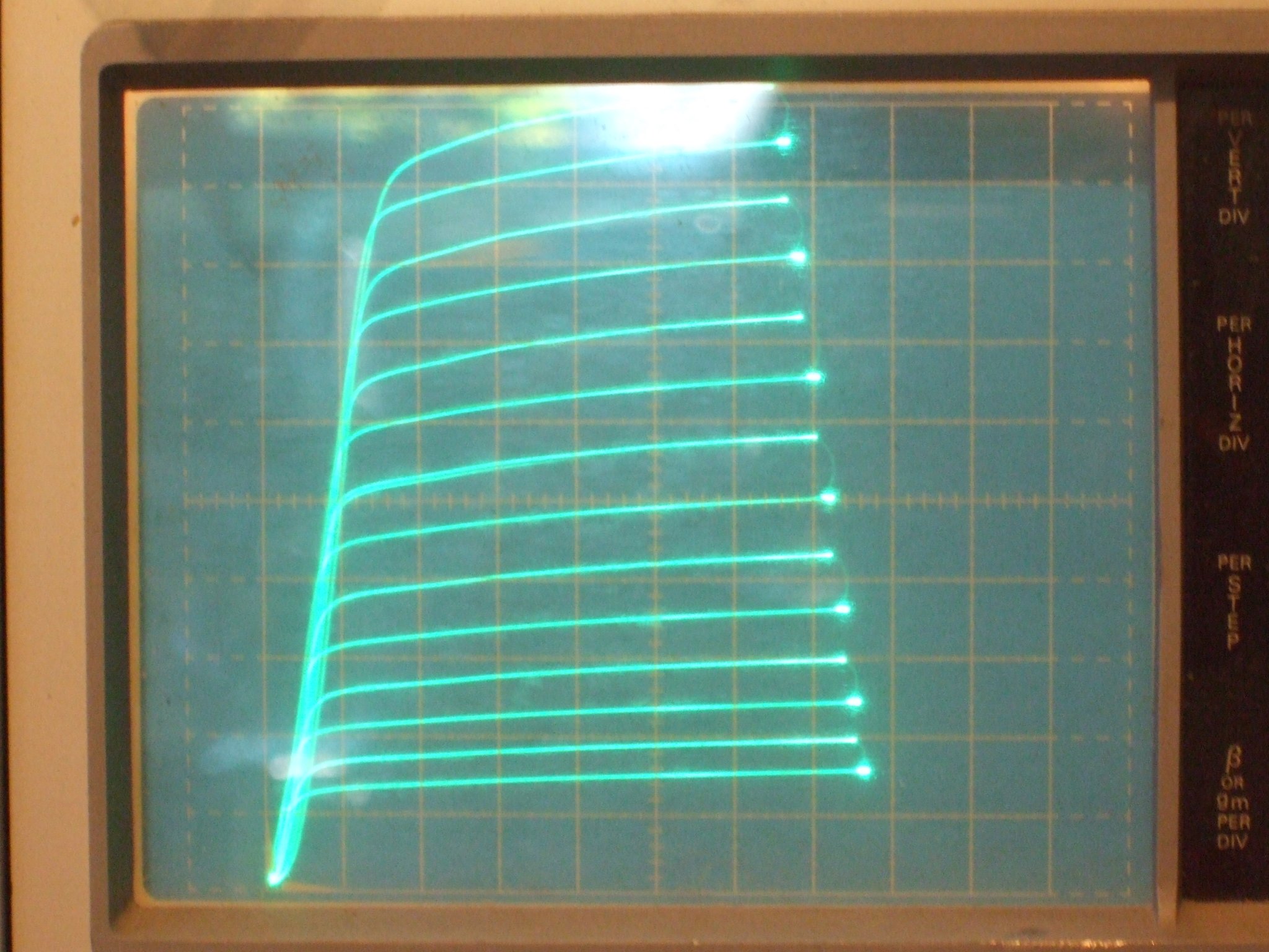

Then an RCA 6EW6:
3) pentode 2 mA/div Vert., 0.1 Vsteps, 80V Vg2
4) triode mode 5 mA/div Vert., 0.5 Vsteps
Pretty close to the other tubes, but takes less Vg2
Well the pentode mode is impressive for these tubes, but the triode mode is not so hot, unless you want to do some 2nd Harmonic cancellations.
5) 6JC6 Westinghouse (Japan) in triode. Impressive. mu around 60. For pentode mode the USA versions are best.
