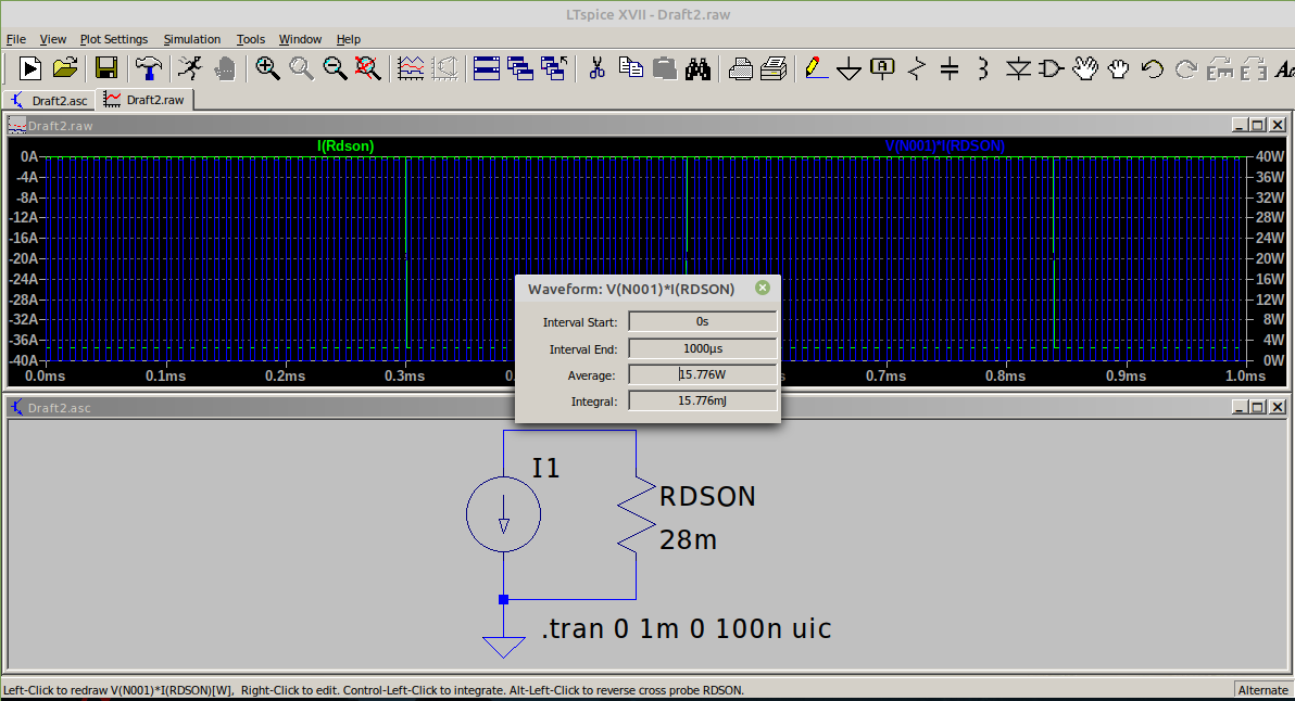

With an IRFZ44 using just the 25C RDSon.. Picture. That's 16 Watts per device and that's before you factor in turn on and turn off losses rise and fall plus capacitive switching losses. Then you get to lump in snubbers to cope with transformer leakage unless you let the devices undergo avalanche breakdown, that's allowed if the device is specified for repetitive operation but the power loss is still there.
It really all looks very nice in a picture but when you look harder things rapidly fall to pieces. My proposal will probably do the same.

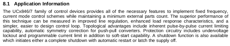

https://www.ti.com/lit/ds/symlink/uc1846.pdf?ts=1591043958190
The magic words are automatic symmetry correction.

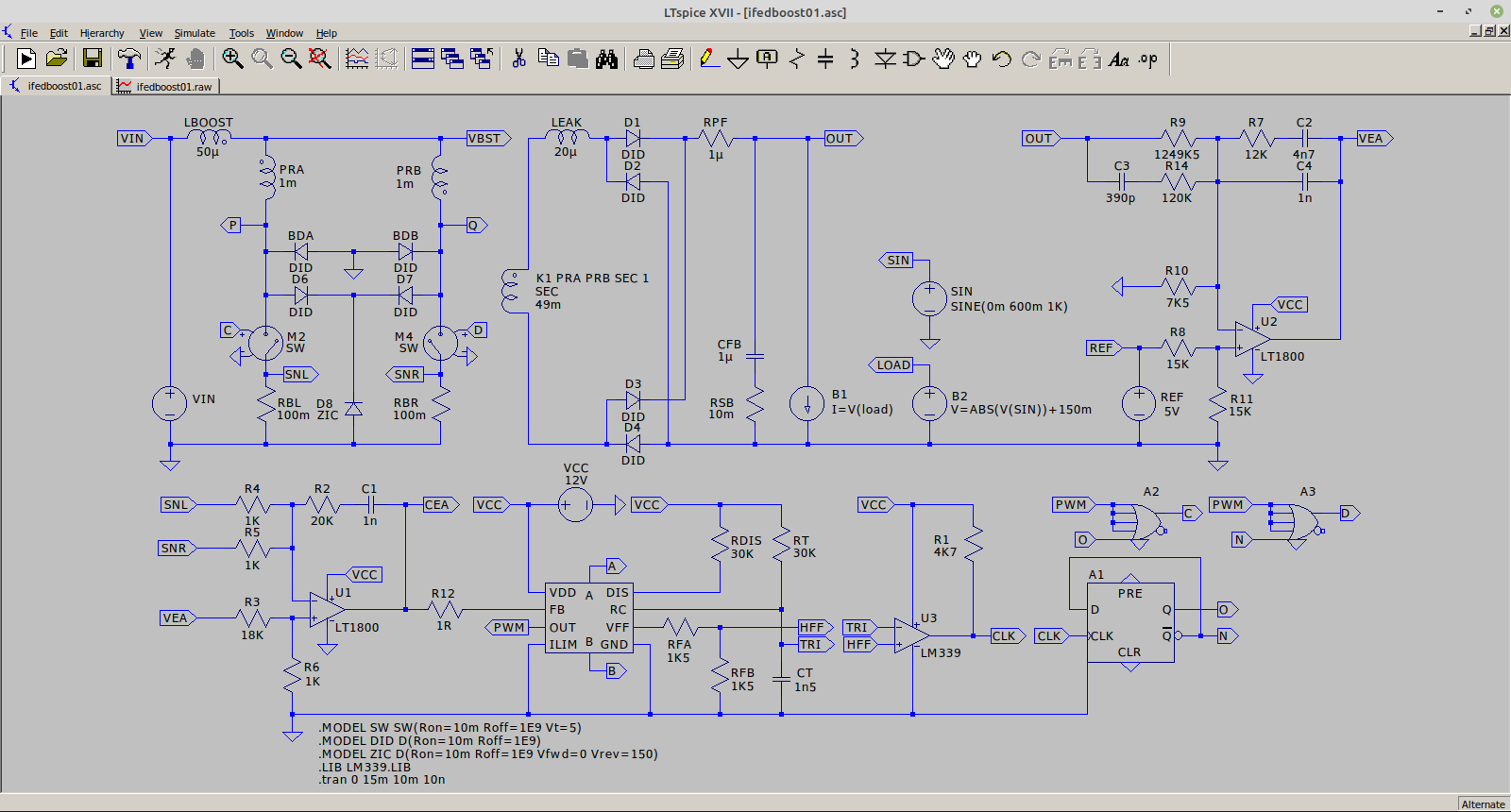

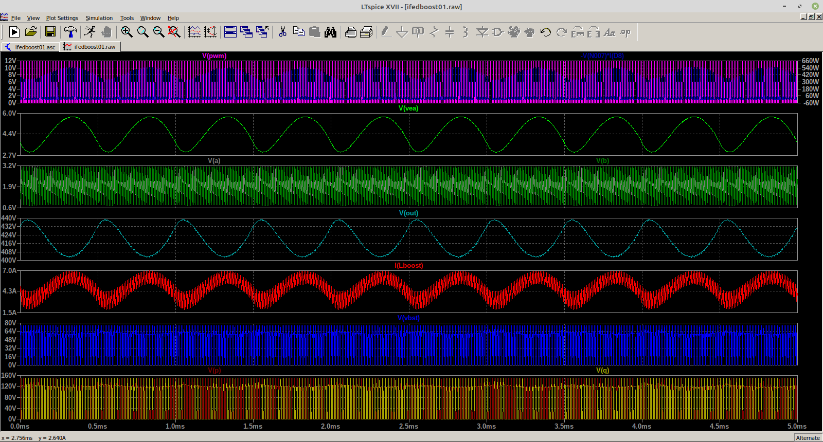

Good morning again. OK, you win... kind of. The topology should work with any input voltage within reason but of course more will be better in terms of overall efficienct. I'll adapt the model for a 48V input and tie down the control circuitry and other bits closer to a final result and see how the numbers run. This does not preclude going offline so that sounds like a win for everyone. I'll post some results later in the day.
An afternoon update. Tubes was right unless Cat disagrees. Without the PFC requirement and using a regulated input things get better in terms of loop bandwidth achievable output ripple and other things.
Offline is still not discounted.
You may have noticed that I am still floating a concept so things can still go horribly wrong. However in going back to the drawing board and looking at things in more detail, refinement cough..
I know have a better idea as to how the thing really works or should work and behave beyond my original thoughts. This is in part why I always bung things in Spice for a reality check.
We end up with a Current Fed Push-Pull Boost convertor and it might be possible to implement it using an SG3525 with some assistance from a few external components. That's tentative.
Latest LTspice .asc file attached. This is from 48V in to 420(ish)V out at about 360W. No voltage feedback as yet. However, you might hate me for it but, you Valve Heads just love your CLC filters so I've bunged one in to get the output ripple down, 90mV p-p
That will affect the voltage loop compensation but we know it's there and subject to analysis.
There are still concerns about added complexity in the transformer, leakage inductance and minimum load but things still look doable.

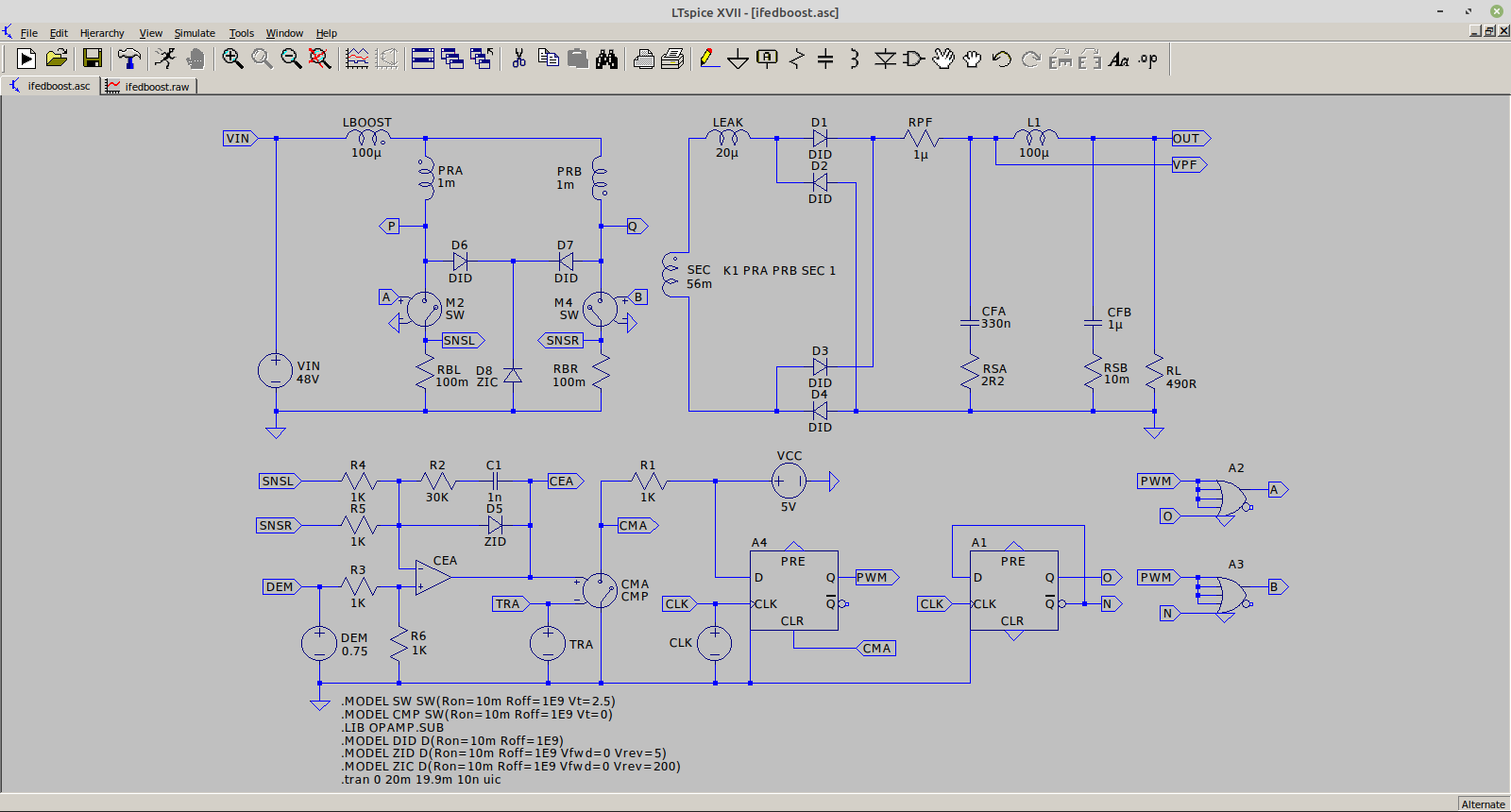

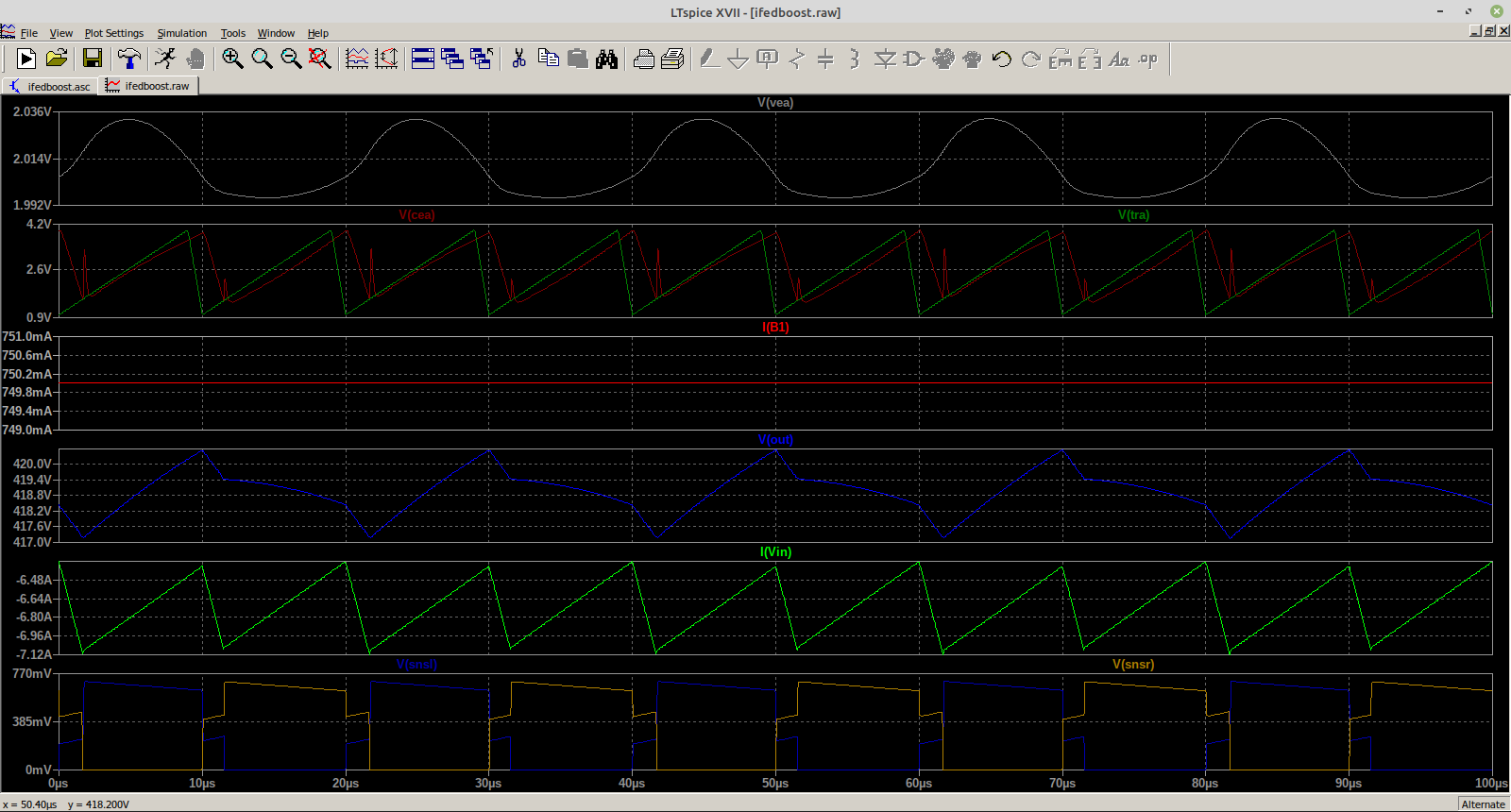

Hi Team. A minor incremental update.

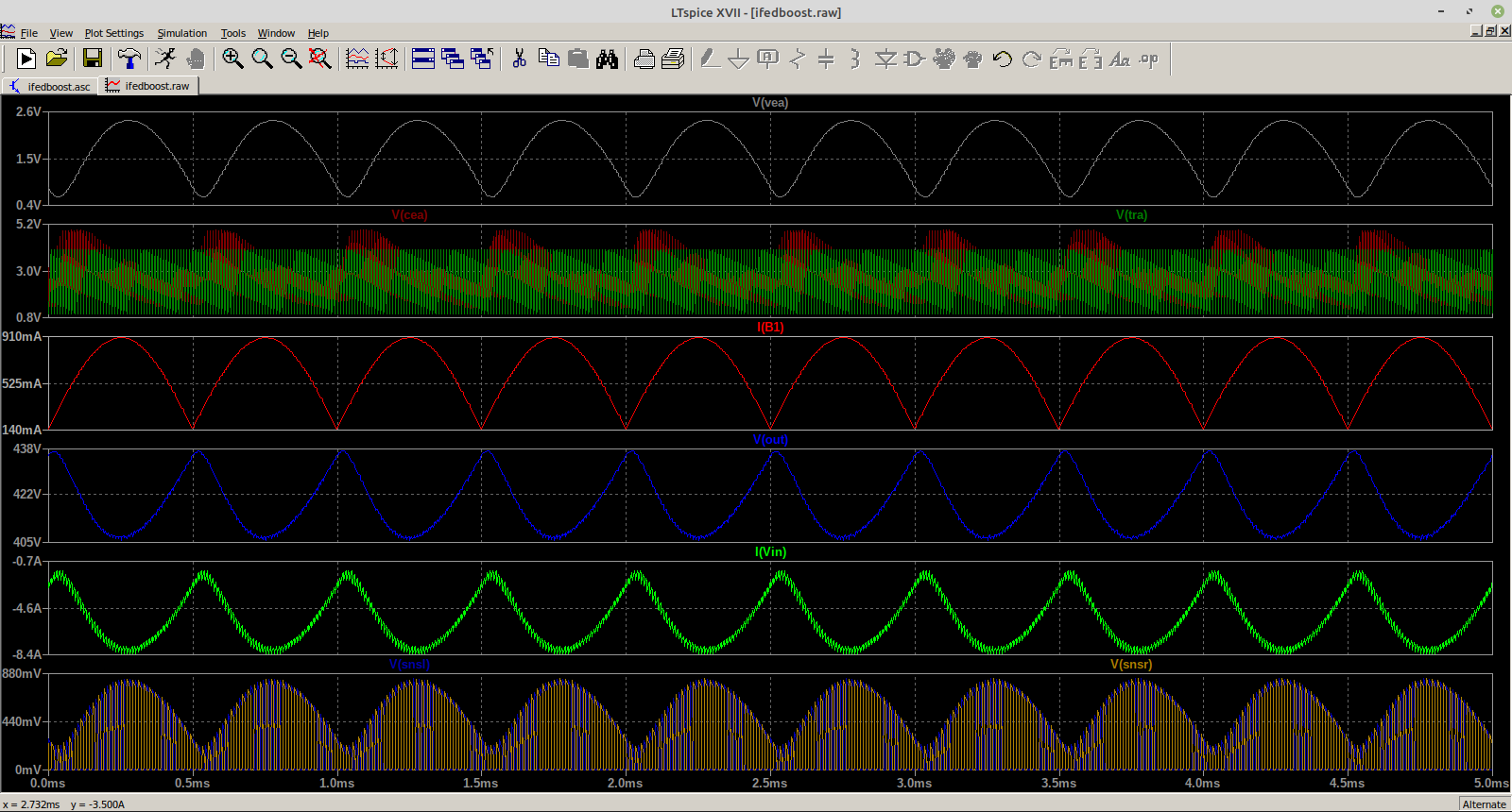

Having gone back and updated the timing of the PWM vs Push-Pull drive waveforms things make more sense and the minimum load requirement may have gone away. This one is without the CLC. Just a C.
No .asc file because I sort of hacked it. I kind of know how these things work so I get to scribble on a bit of paper and tap the calculator. There is some underlying theory to this which I hope to give but this is a sort of cut and try.
You might/should notice that ripple in the VEA, voltage error amplifier, and output voltage is uneven. This to me is indicative of flux walking in the main transformer. Either it will be a real problem that can be dealt with or it will be dealt with.
In respect of transient performance the other picture is the loop tracking a 1KHz demand from 150mA to 750mA. At 420V that's about 63W to 315W. The sky has not fallen in because this is with a 1uF output capacitor. Switch Mode Power Supplies are an interactive pain. The 1uF cap reduces inrush current but we can use a bigger one if we take action elsewhere.
In respect of the transformer. The design is another iterative pain. Rule of thumb is you target 4A/mm^2 as the current density in the windings. Yes proximity and layer effect apply so you will get multifilar windings. I've attached a program I wrote to do this some time ago. It is based on a paper by Dowell posted to me by a librarian from Philips in a former life.
Words from Unitrode.
https://www.ti.com/lit/ml/slup125/slup125.pdf

So now that we have a design thats expected to work could you perhaps take a look at a IC that could do this for us ? I would prefer with minimum external components for obvious reasons but I am open to any solution.
UCC35705/6. Unfortunately there does not seem to be a Spice model available for it so I have had to roll my own which, to your way of thinking means we still have nothing.
Sorry Team. Project cancelled.
Rename .txt to .asy
Rename .txt to .asy
Now with added UCC35705 and a few extra tweaks. The Push-Pull square wave drive has to be synchronised to the PWM. That's done with the LM339 comparator sensing the timing triangle, TRI, on the UCC35705 against half of VFF which sets the ramp peak. That might be subject to further processing.
