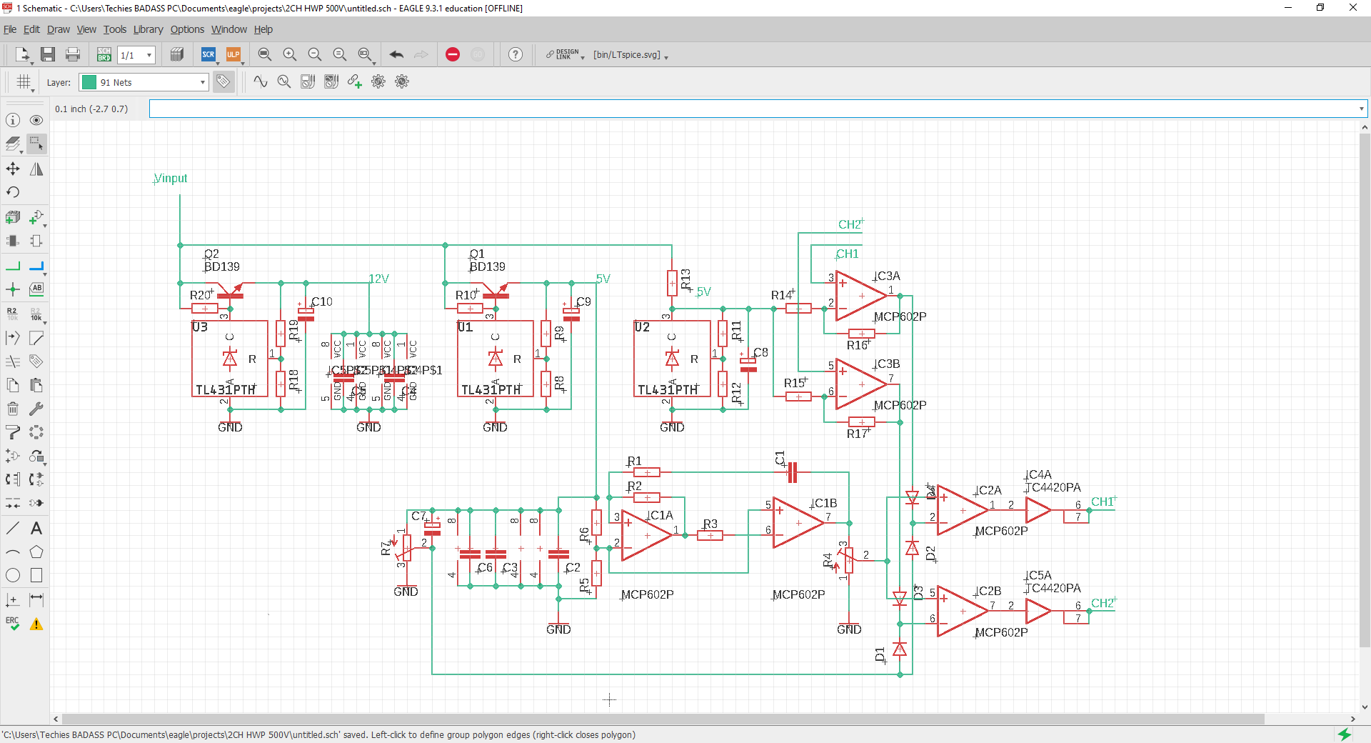

alright been digging the schematic a little bit.
Is there any other less wastefull option instead of the LM339? What other common cheap op amps are possible to use? If not well stick with the LT1800 just asking.
Can I also get component recommendation ? (the D flip flop and the gates A2 and A3)
I assume a simple 5V refference with a TL431 will be sufficient ?

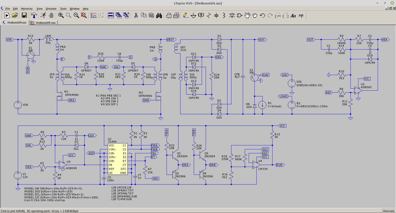

Now with, poorly implemented, inrush current limiting and using a TL494. Yes I hate myself already and yes it was a pain interfacing to it.
No LM339 but this time a single quad op-amp. I'll bear the cost in mind but there are bandwidth and slew rate requirements plus it needs to be rail to rail input and output.

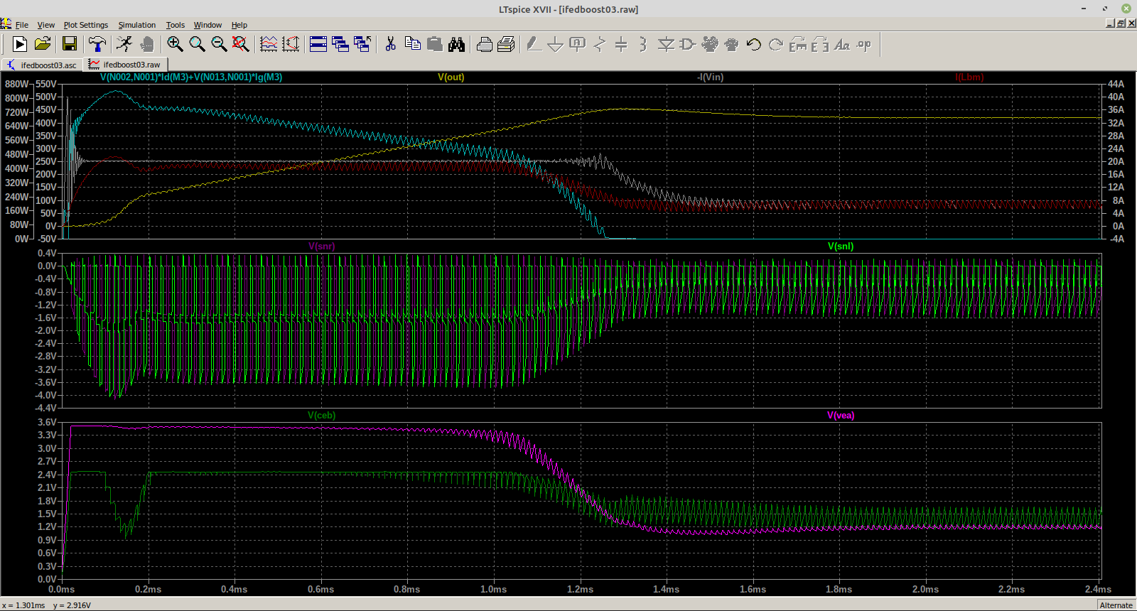

You can worry some more because I have decided to use current transformers. Again, in part, this is error amplifier bandwidth but more importantly power loss in sense resistors.
Picture is start up to 420V @ 315W. Top loss in the limiter, output voltage, input supply and input inductor current. Middle output of current transformers. Bottom output of voltage and current error amplifiers.

Now with flux balance compensation. The problem is that primary side current is determined solely by the boost inductor. Secondary side current is delivered as primary side transformer magnetising current subtracted from the boost inductor current... modified by the turns ratio. If the primary side magnetising current is unbalanced which it will be because it is a push-pull convertor then things rapidly go to pot. You can't use current mode control, peak or otherwise, on the primary side because it is just going to control the boost inductor current unless you come up with a cunning plan. The simpler cunning plan is to monitor secondary side current where the problem really makes its impact known and then take action on the primary side.

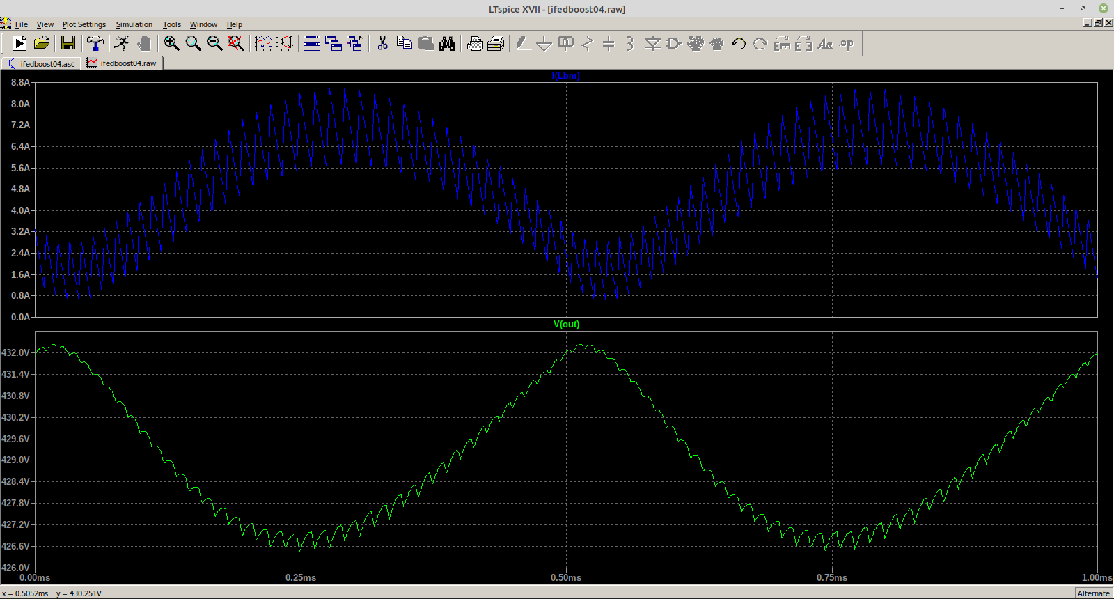

Latest .asc as a .zip plus some words up until the Right Half Plane Zero. This is ifedboost04. Edit the label SNS at the bottom of RT to be GND(global 0) to watch it lose the plot.
