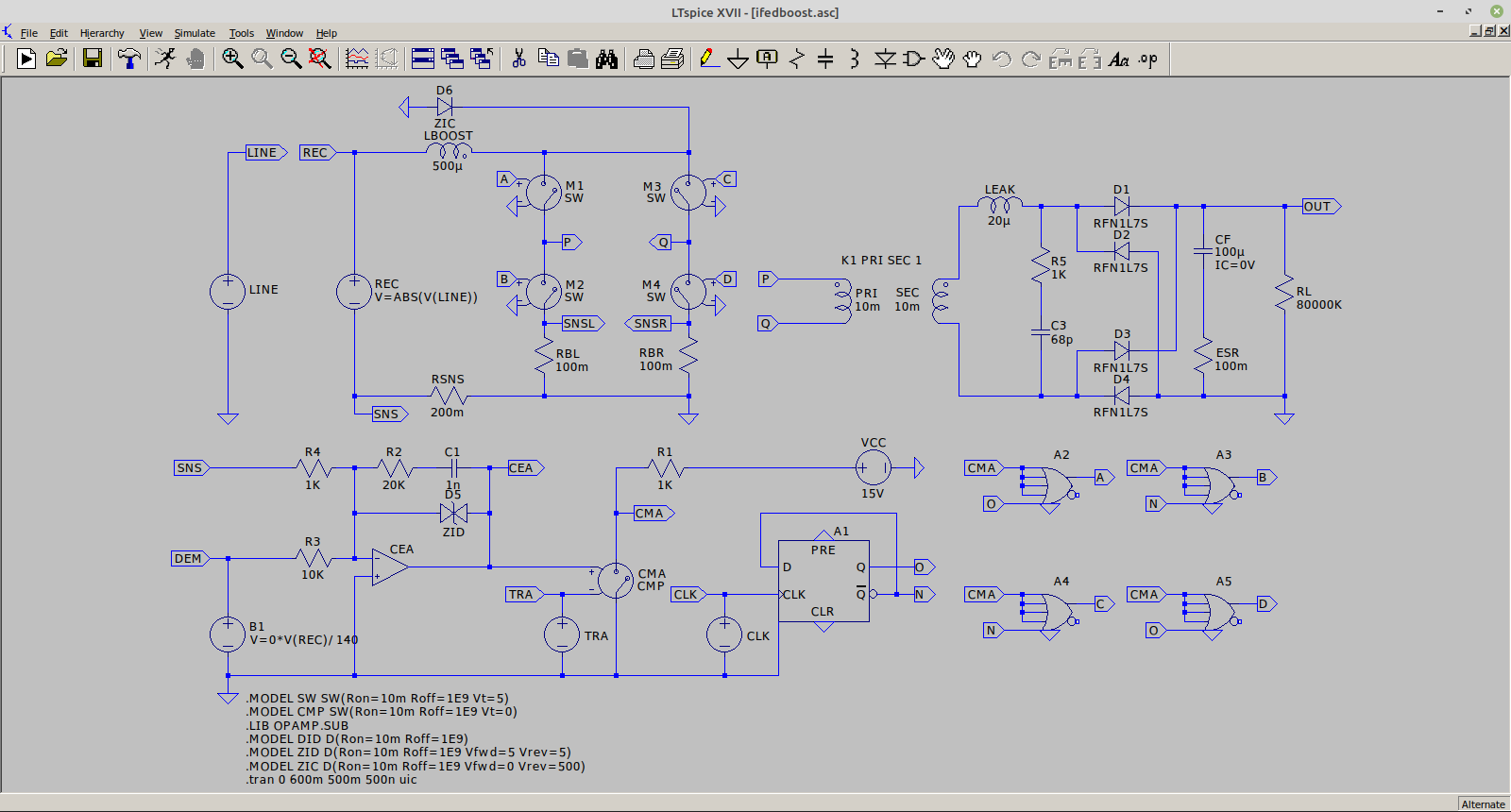

I propose this as a CE certified starting point. Then the user can use there own LV supply, and it is 110/220 compliant. The question then becomes what voltage. I think 12 or 24V is a good point.

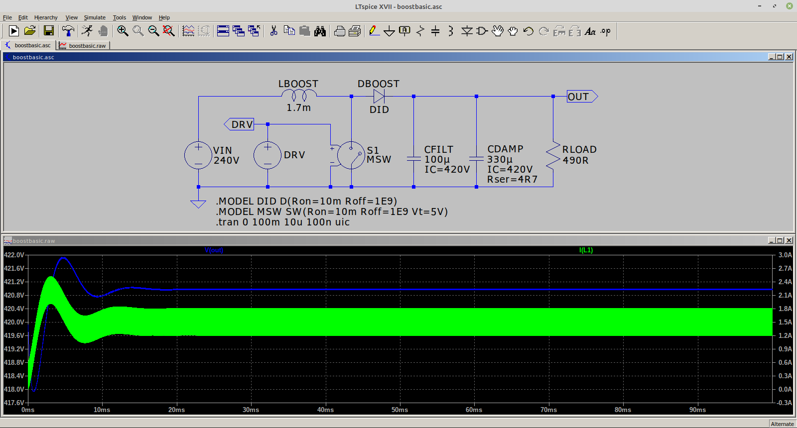

Incoming boring words. Now we start to find out how bad my design decisions have been. In some respects this might seem trivial but...
The previous circuit shows a non-isolated boost convertor. We want to calculate the operating duty cycle. During switch, S1, on time Lboost is set through VIN. During switch off time Lboost is reset through (VOUT - VIN). In a PFC circuit inductor current will transition from discontinuous to continuous operation but we assume continuous operation.
The change in inductor current, dIL, is the voltage applied across it multiplied by the time it is applied divided by the inductance.
dIL = VL.T/L
dILset = VIN.TON/L
dILrset = (VOUT - VIN).TOFF/L
Steady state the average inductor current remains the same.
dILset = dILreset
VIN.TON/L = (VOUT - VIN).TOFF/L
The L's disappear.
VIN.TON = (VOUT - VIN).TOFF
Call TON the operating duty cycle D then TOFF becomes (1 - D). It normalises things to 1 second.
VIN.D = (VOUT - VIN).(1 - D)
VIN.D = VOUT - VOUT.D - VIN + VIN.D
VIN.D + VOUT.D - VIN.D = VOUT - VIN
VOUT.D = VOUT - VIN
D = (VOUT - VIN)/VOUT
The same sort of simple algebra applies to other square wave convertors. Consider the setting and resetting voltages and times, normalise and solve.
In the circuit I have assumed that all of the power ends up in the 420V output. That's another common thing to do. Make the assumption and tidy up later.

Now we need a value for our Boost inductor. Rule of thumb is you operate at 20%-40% ripple current and in this particular case err towards 40%. 360 watts from 240V is an average current of 1.5A so 40% ripple is 0.6A. Since we know TON, VIN and dIL we get to calculate the value of the inductor as being 1.7mH.
It's not hard and fast but rather a starting point. With VIN at 110V average current will be higher, have to account for that when considering saturation, and ripple will be lower. This sort of stuff is always subject to optimisation.
Looking back at the circuit. S1 and DBoost come with .MODEL statements. These are ideal components. CFILT has a value of 100u for no particular reason and, Spice does this thing where it shouts up unexpected results, I've added CDAMP with an ESR of 4R7, sort of SQRT(LBoost/CFilt). The circuit is open loop so there is an undamped resonance between LBOOST and CFILT. CDAMP should not be necessary in the end result.
If you right click on CDAMP you will see the setting for the ESR. The other setting for both capacitors is an Initial Condition, IC, that sets the start up voltage to 420V for both of them. You have to CTRL Right Click to see those. Right click on the x to set/clear whether they are displayed.
The IC statements go hand in hand with the .tran analysis statement which has uic, Use Initial Conditions, tagged onto it. Generally speaking with SMPS circuits you always set that otherwise it goes off and tries to find a DC operating point for an hour before losing the plot and giving up.
dIL = VL.T/L
dILset = VIN.TON/L
dILset = dILreset
The L's disappear.
VOUT.D = VOUT - VIN
Tubes wants,
420V @ 0.5A = 210W
-50V @ 0.05A = 2.5W
10V @ 9A = 90W
Tubes is the customer so is right but... what's the 10V @ 9A for? I kind of guess heaters but showing my ignorance they are 6.3V/12.6V. Feel free not to tell.
Anyway that's more or less 300W. Now let's hurt ourselves and say the overall efficiency of the supply is going to be 80% but hope to do better. That makes the design power 360W.
Tubes wants operation from 90V to 270V AC which is the standard type of stuff for 110VAC and 240VAC line voltages. In the circuit I have picked 240V as a DC VIN. With VOUT at 420V that gives us our operating duty cycle as 42.8%. If you right click on the voltage source labelled DRV you will see it is set to give a 100KHz signal, 10uS period, with a 4.286uS on time.
