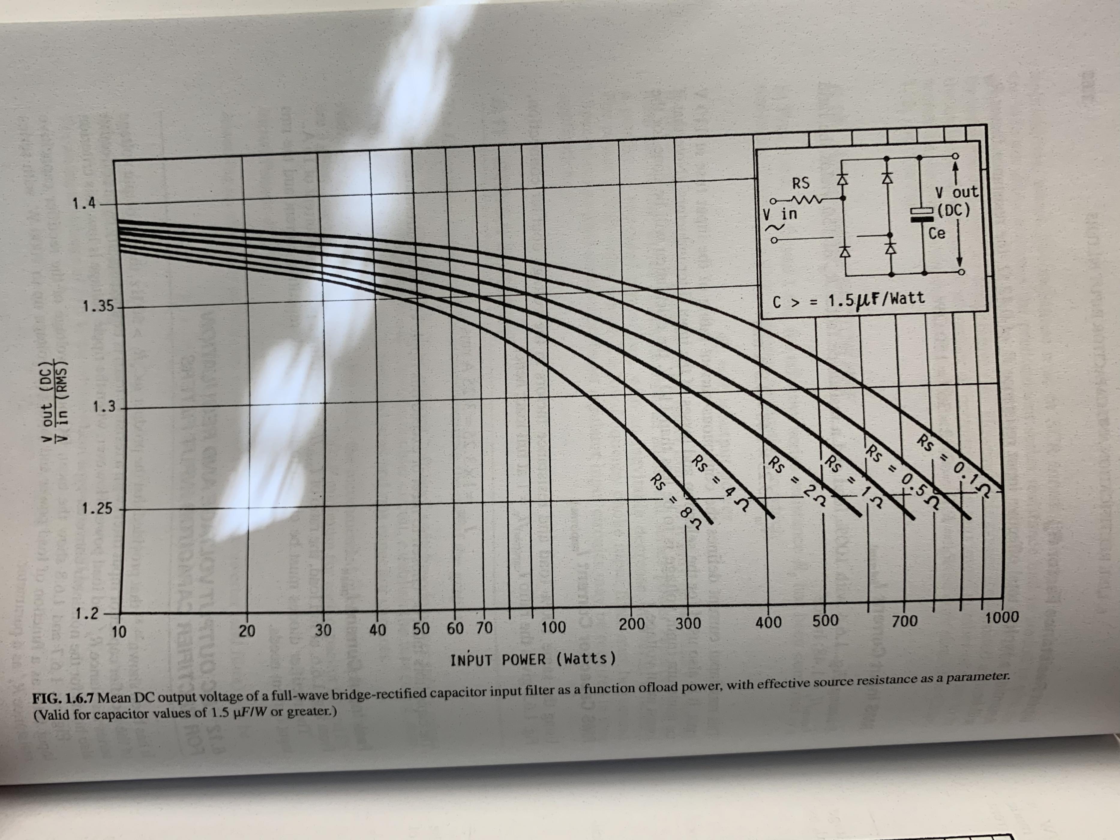

So here is a question. For those of you who make mains powered SMPS, how do I calculate the mains side capacitor bank capacitance.
Peak current 2.5A
Voltage on the filter caps = 120VDC-380VDC
Switching frequency = 100kHz
I have absolutely no clue how to get this value. I will also build a proper mains input (noise filter and all that)
Peak current 2.5A
The amount you will need depends on what you want for the ripple (both voltage and RMS current) on DC link to be and how much reserve energy is needed for regulation, transients and holdup time. A guess a good rule of thumb would be a minimum of 1.5uF/W, if you are using a full wave bridge rectifier and single supply.

Thank you very much sir.
With more than enough reserve ill go with 150uF roughly. Using two 56uF 450V capacitors and two 10uF 450V low ESR cap. That should take care of it.
