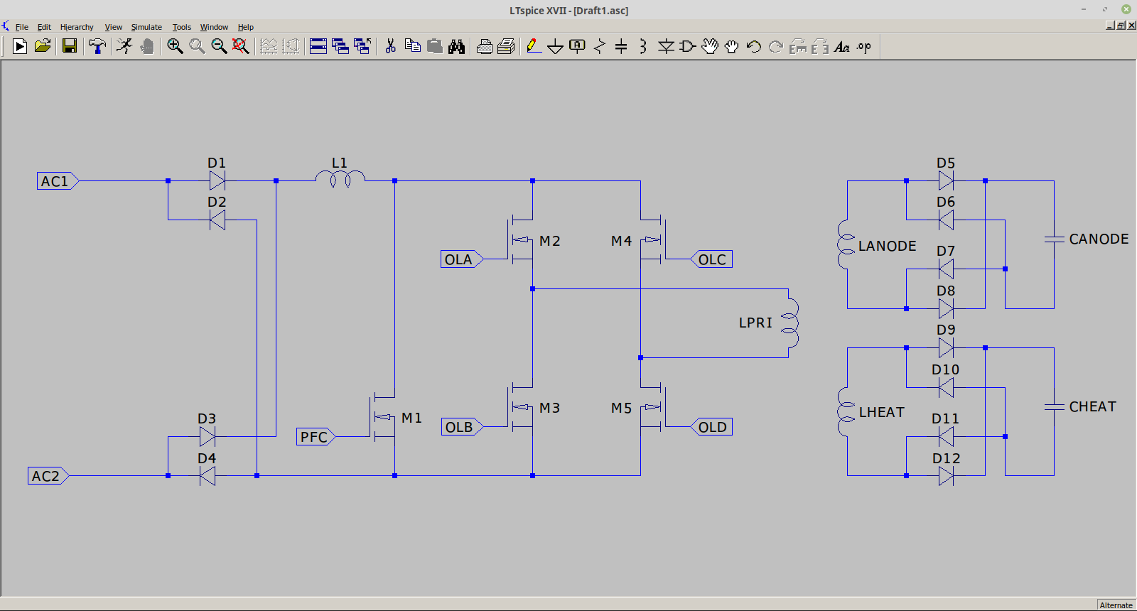

CatererpliarSK, post #4 indicates the level of development of your step-up dc/dc. Post #13 indicates your assessment of why you don't believe your converter would be useful for your target 100W B+ output capability.
Your 70% efficiency performance indicates that you may have chosen an incompatible topology for starters, as well as there may be some switch and transformer related choices that could be improved on.
One similar isolated converter had efficiency of circa 92% at 40W output, indicating the power conversion path with an appropriate topology and parts is unlikely to be a roadblock that would force a need to change to a mains input converter to get to the 100W target.

Again. The switching frequency of that one comercial suply is too low. And I dont believe that it is capacle of 150W constant. Neither I believe it has its noise performance any good.
Its a flyback topology, just like any switching supply that boosts the voltage from such a low to such a high voltage. Mine works on the same principal.
I have re read post 13 and I cant see where would I have said that it wont be usefull. I dont know what is your problem constantly whinining about some chinese supplies that are for 12V. All I see is the low effort to make the output clean. Also I want to make it mains powered because nobody in their right mind who is serious about tube amplifiers is going to power it entirely with 12V. Also the mains version is suposed to be smaller, way smaller.
Im blown away by the fact that you say "one similar isolated converter" when you have not even seen the schematic of mine nor its layout or functional diagram and you immediately treat it like its copied.
The main reason why I said that I dont believe that my PSU will be useless is because poeple have that constant stigma about switching power supplies, but i hope one day, it will be treated better than just a Nixie power supply or magic eye power supply.

Those Chinese supplies the Trobbins mentioned are perfectly fine. I use them for phono! There is no noise on the audio from the power supply. It's good for 150W continuous if you use a fan and run it in open air. Inside a 75c box with no ventilation, it's good for about 40W. The coil is the weak point IMHO. I ran one hot enough to melt it. Only one failed out of 10 I've bought, and that was destructive testing to see what it was actually capable of.
I guess I'm not in my right mind then. I have built a 100WPC amp powered from 12V ATX that powered one of these: 500W 12VDC transfer 18VAC & 0-220v-380v inverter module | eBay which is a very good supply for the record. I would like a supply just like this but powered from 120VAC instead of 12VDC
Bonus is you can run it from a car battery for 30 minutes or so 😛
My problem with 12V ATX as I said is it's large format. The case needs to be 4 inches tall, my amps are usually 2 inch high. Also, a fanless ATX supply is expensive. Who wants a fan in an audio system?
This is why a small format, dumb switch mode supply at 50-100kHz makes sense to me. By dumb I mean there is no feedback, it's open loop like a linear supply. Rectify 120V, switch it into a transformer with MOSFETs or IGBTs, and rectify the secondary. Use with an RC timed circuit to drive the switches, or base it on a 2 pin crystal. No IC.

The real point if after all those filters all you end up is very little power no regulation and a huge PCB or area used up by the filter. My supply has a regulated output thats kept stable, no doublers, straight from the switching transformer. But I see nobody cares, everyone keeps telling me but the chinese supply even tho it has nowhere near as many featres as mine.

Those shitty Chinese supplies all run from 12V. I'd be interested in a supply like that that ran from mains instead of 12V. You said the only difference is the coil. I say the entire front end of the supply needs to be changed if it's to run from mains. A 55V MOSFET obviously will work fine for 12V but not 300V...
And FWIW, a simple C filter after that "shitty" Chinese board is good enough for a phono amp... No CLCRCRCRCRCRCRC ******** here.

I explained in one of mine previous posts about the switching transistor. I see you read very few of what I wrote, shows me how much does one actually care. It specifically was about why I could not use a regular MOSFET and why I had to go with a overrated part. The original.MOSFET (IRLZ44) Is powerful enough but the body diode snubs all the reverse voltage that is induced by the colabsing magnetic field loading the transformer and transferring less energy to the secondary and heating the transistor, that is why I'm not worried about the front end because I use a G30N60 (30A 600V IGBT, I'd say that's enough for both mains and 12V operation.) The only issue it had was how to power the controller since with mains and not having anymore windings for the chip to be powered from the only left things are capacitive dividers and that ain't good for the powerfactor. Neither the longevity of the device because capacitors do fail in such applications. Saying that it is 100% universal I would have still designed a specific board for mains version because the 12V has problems and is unsuitable for mains operation. But decision has been made to halt the development of the PSU and I will put aside my entire vacuum tube project for an unknown time.
Maybe your English has misinterpreted that when a poster refers to another smps, they are doing that as a comparison, and a way to interpret or illicit some additional details from you to better appreciate what you are proposing - given that no schematic and detailed design has been forthcoming.

I just stumbled over this thread right now, and I totally like the idea of a flexible and high-quality SMPS that can be used in a variety of tube power amplifiers. Show us a schematic so that we can actually discuss your design.
