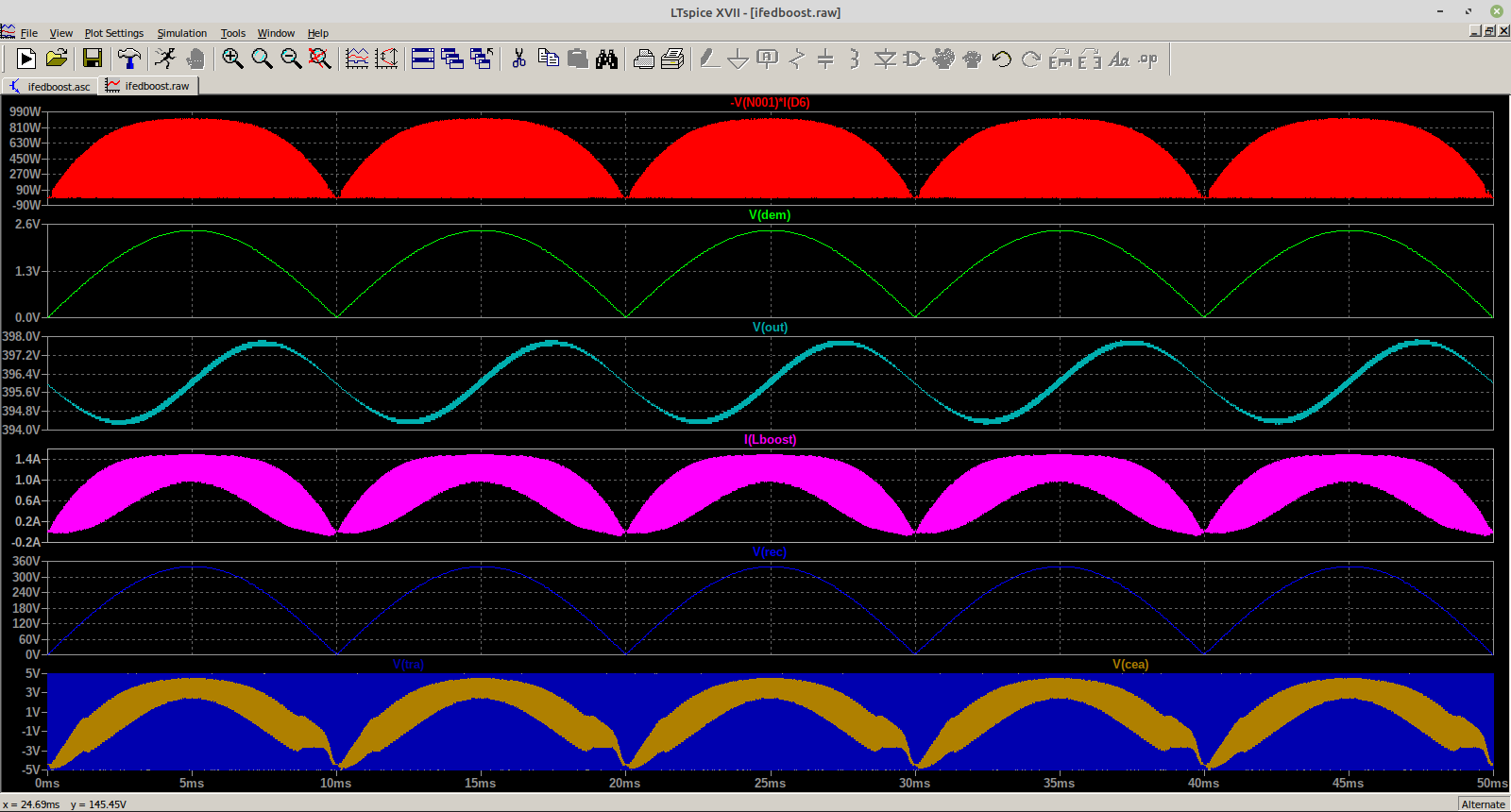

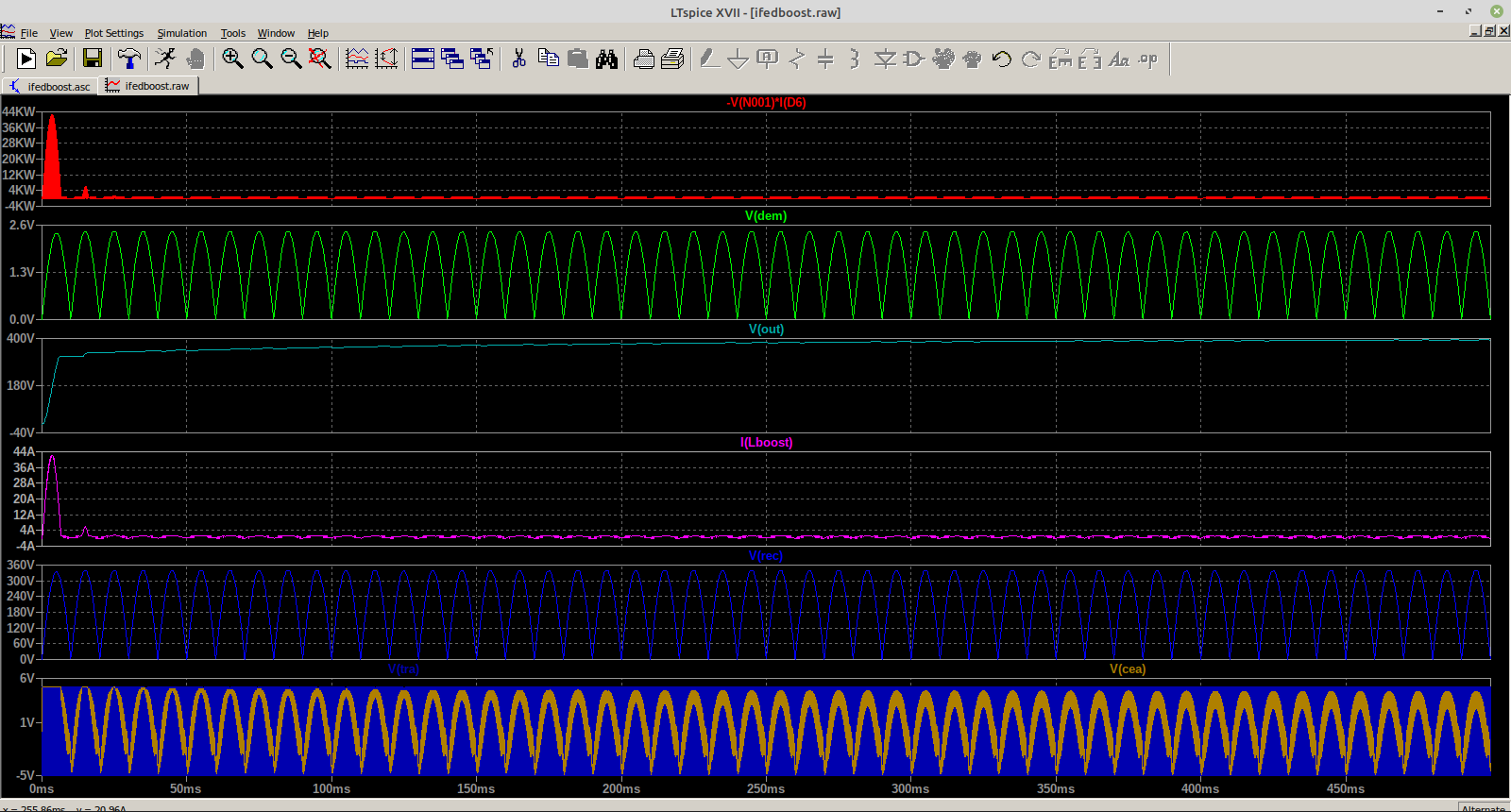

A simple tentative LTSpice model.
LINE is the AC mains, 340V peak to peak. REC turns it into a full wave rectified voltage. LBOOST is the boost inductor. M1-M4 is the bridge. RSNS in the return to REC effectively measures the boost/input line current as SNS.
SNS is fed to a current error amplifier, CEA. Compensation is standard slope matching. Demand signal DEM is set to follow the rectified line voltage, REC. This gives you the power factor correction. Ultimately that would involve voltage feedback and the other things commonly available in a PFC IC but for the moment it is set to give about 200W output.
Basic Bridge drive signals are non-overlapping O/N from the D-Type. The PWM signal via the OR gates under control of the CEA to force overlap and charge the boost inductor.
PRI/SEC are the main 1:1 transformer. Inductances are representative of magnetising inductance. Leakage inductance is included. Full bridge rectification on the secondary into the filter capacitor and load with a bit of snubbing.
D6 clamps overvoltage on the bridge switches that results from the leakage inductance. It is one of the sources of losses.
First picture is start up to 500mS. There is inrush current and that is common to what is found in a standard boost used for PFC. Some form of soft start might be required but if start up is timed/controlled it might be reasonable to look at device transient thermal impedances.
Second picture is after start up is over. It's not strictly in regulation but with bare PFC such as this you will get sinusoidal ripple at some level on the output and the loop bandwidth will be limited. With a Class A load it will be what it is. With a Class B load it will be higher.
