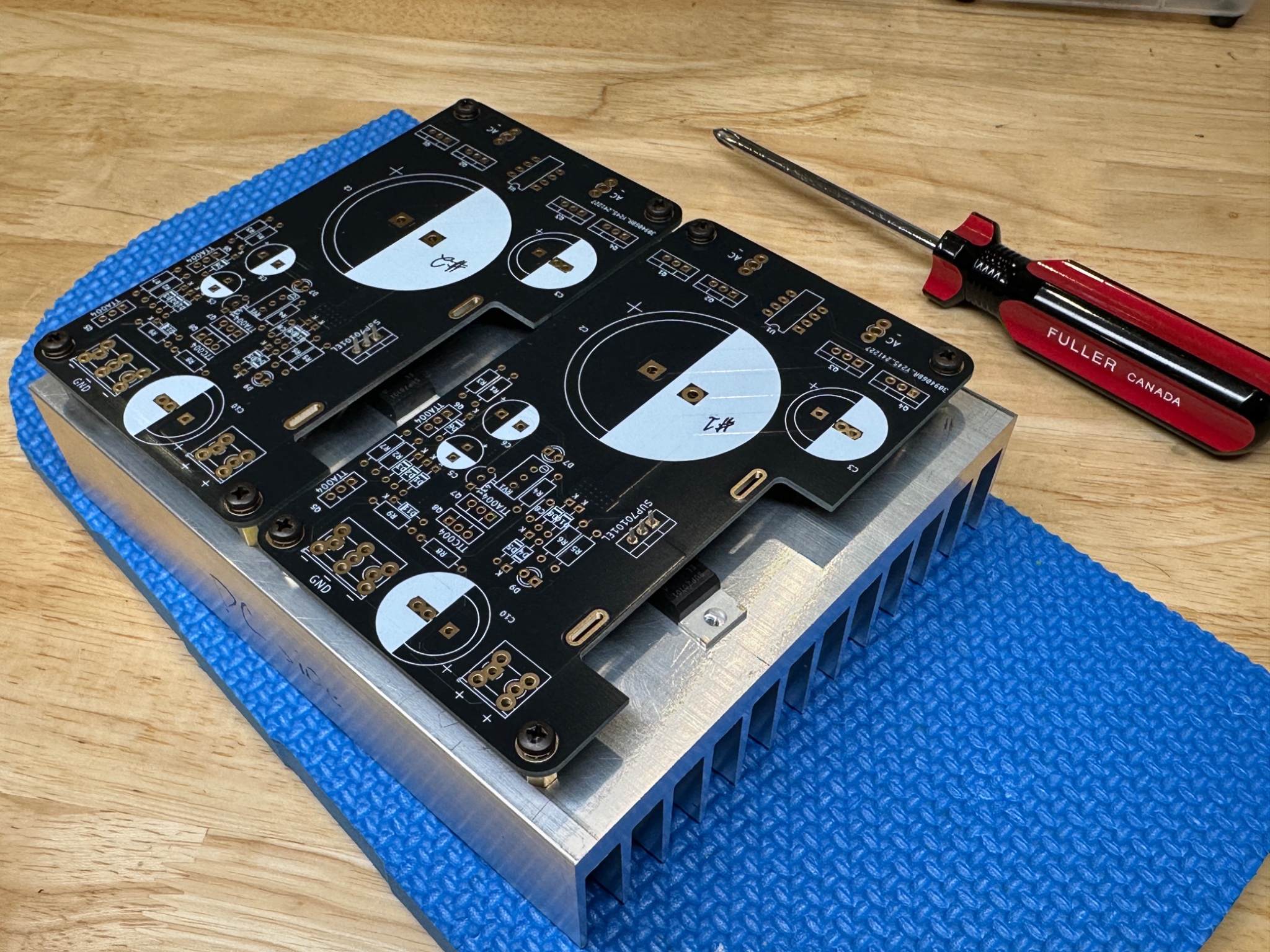

If anyone in the USA would like to try out @tombo56 R25 boards, I ordered a bunch just before the de minimus rule dissapeared for packages from China.
Boards are 2mm PCB, 2oz Outer copper, white silkscreen, HASL.
Since folks outside the US can still order these direct from JLCPCB, that's they best option still due to high international shipping cost. I'm hoping to help out folks in the US who just missed the opportunity to sneak in a PCB order before the May 2, 2025 deadline kicked in. I posted them up in the swap meet.

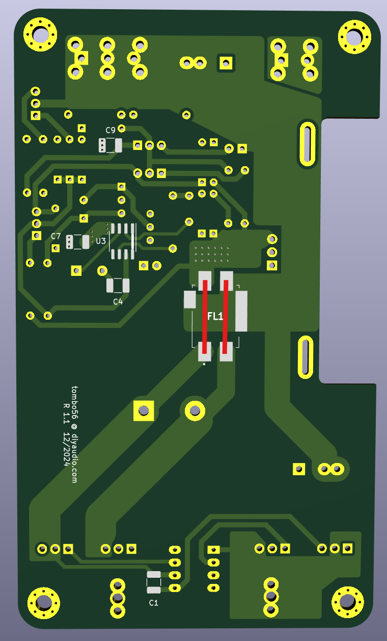

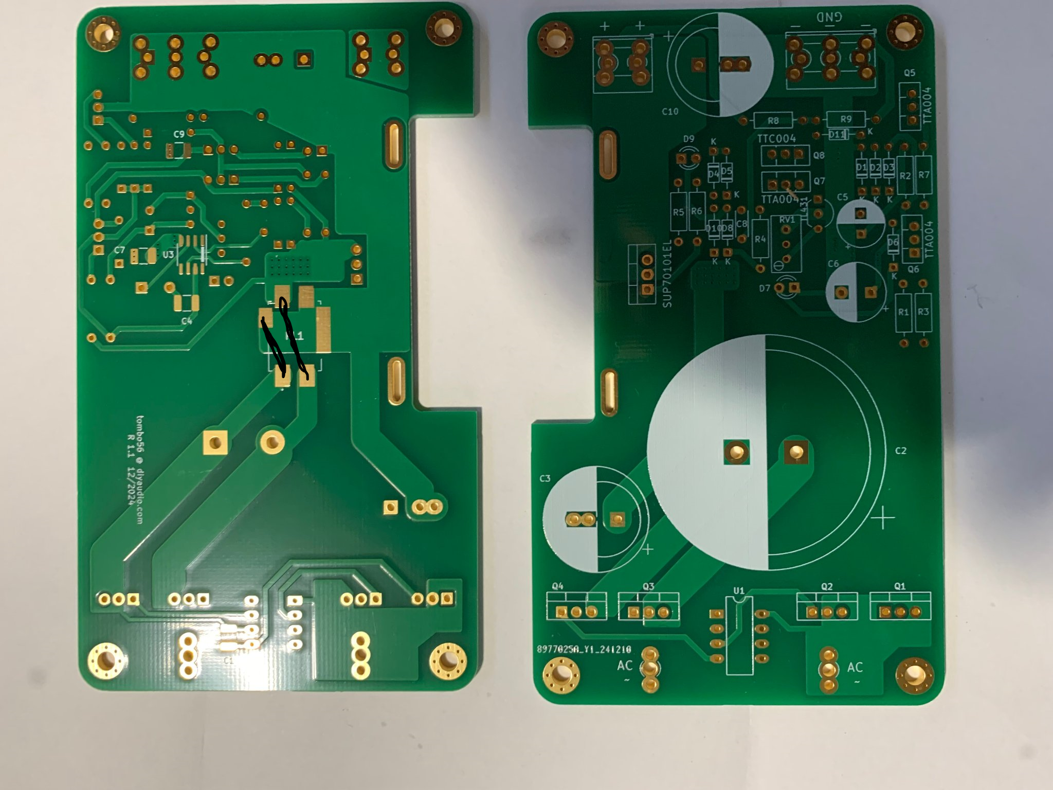

Just solder two jumpers:If not using the RF filter(waiting for delivery) would I just use jumpers like in the below pic?
Thank you, Oops I mixed up positive and negative in my original post as member Jean-Paul kindly pointed out 🙂
No not just crossing but also full short AFAIK. Anyway, it would have been a disappointing experience. If not yet experienced enough just keep exactly to the BOM without any deviations/interpretations and triple check everything before thinking of powering it.
Maybe show it with pictures here before that.
Very sensible advice for anyone with less experience.If not yet experienced enough just keep exactly to the BOM without any deviations/interpretations and triple check everything before thinking of powering it.
However, gsrchrisu has already assembled four perfectly working R21 modules. 🙂
