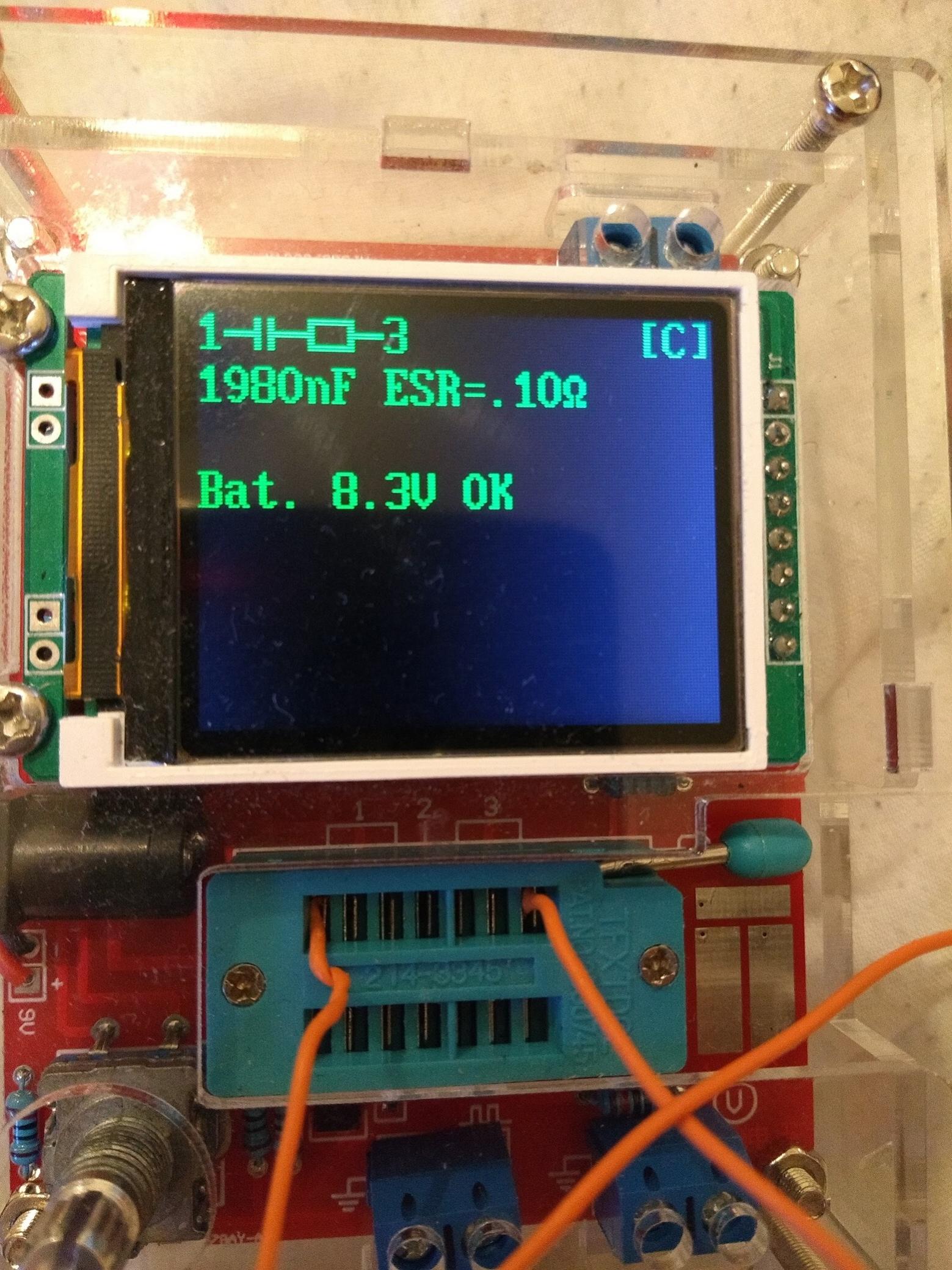

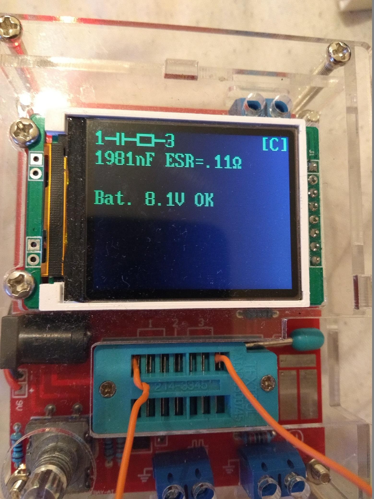

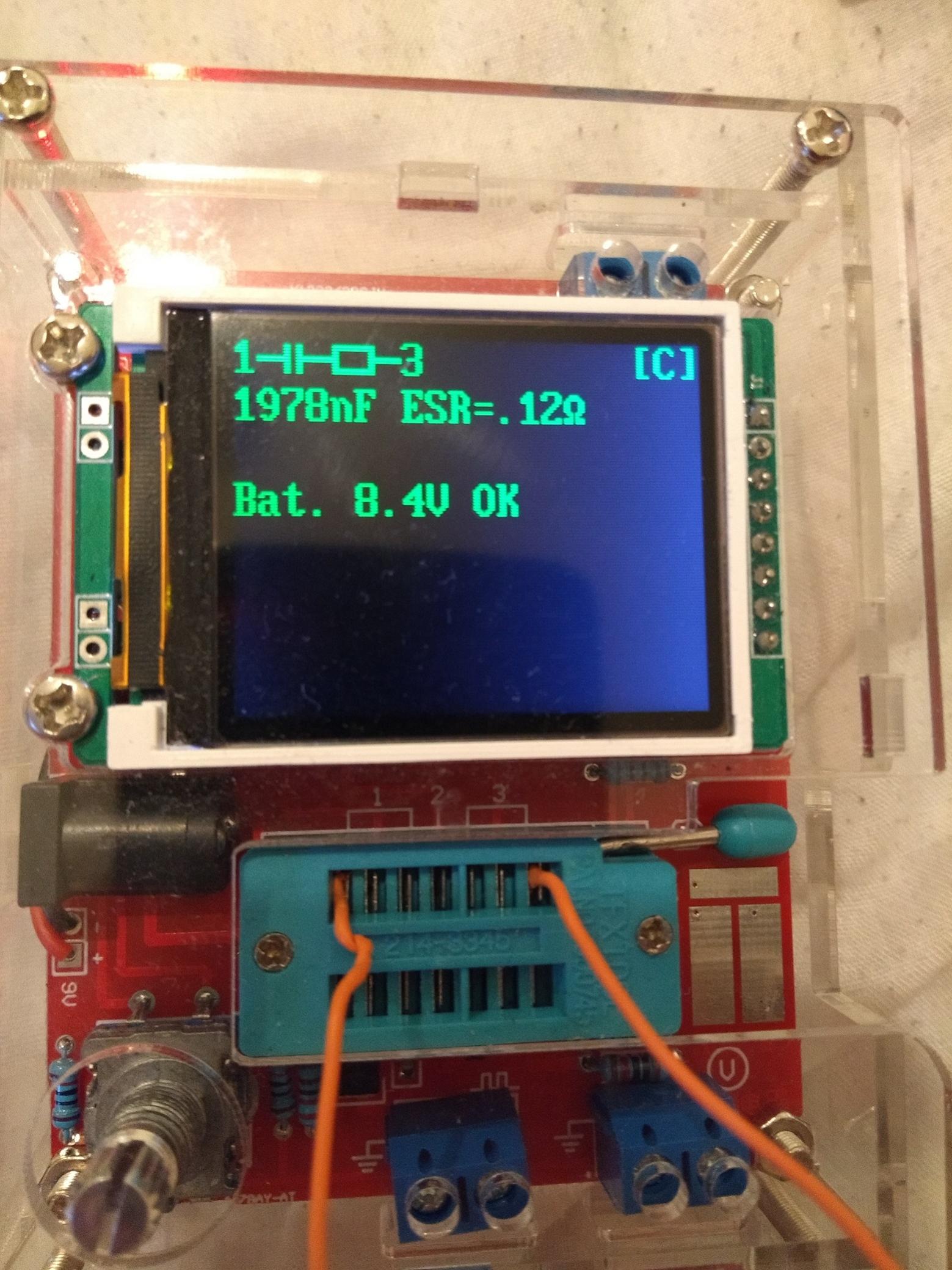

IF any of the C202, C203 or LC203 capacitors has 'gone', then their reduced impedance would very likely result in the 16 V (or lower…) that you observe with your meter.
________________________________________
WAIT… I just had an ah-hah! thought.
See those Zener gate-protection diodes, for the MOSFETs? The VZENER working voltage for the 1N4744 is only 15 volts. Hey… 15 is close to 16! Ah… and now it becomes abundantly clear.
Either C203 or LC203 has shorted out. OR the load on that channel is presesnting a short. In any case, the 15 volt gate-proection Zener is firing, and raising the ground-potential (of a short) to +15 to +16 volts.
This in turn, being quite low impedance presents at the pin you've been measuring as 16 V.
This has to be it, I think. Sure, a MOSFET could be damaged, or something. But ultimately the coincidence of the VZ Zener protection diodes and the measured value, indicates a short.

C202
