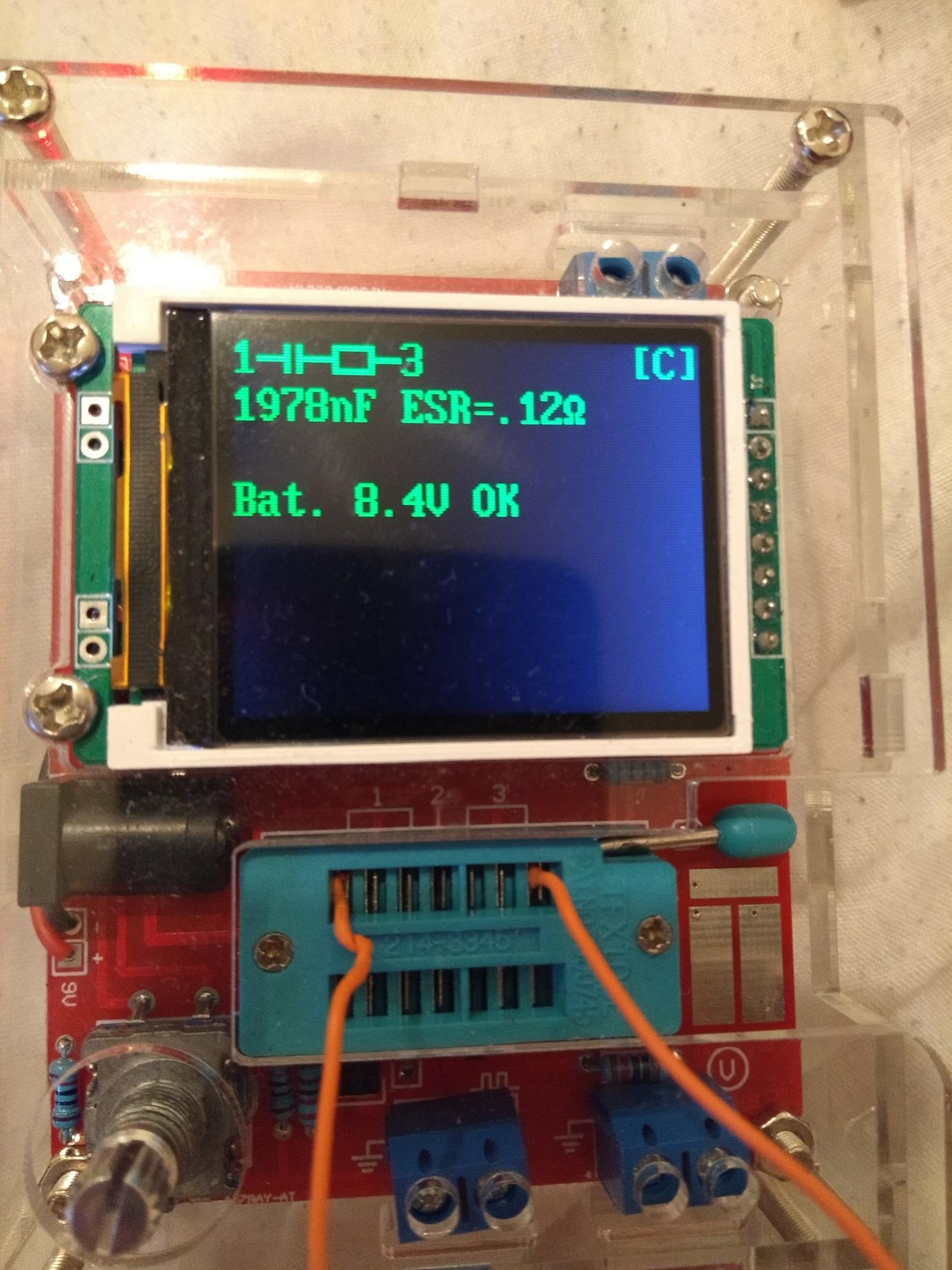

I have a pretty decent meter and all the caps measured about the same. They are expensive type capacitors but if that will certainly fix the problem then it might be worth the investment!
So your suggesting its not any of the resistors or diodes?
reason i asked you to float one end of the caps is to see how the circuit reacted without them in circuit...prefferably float the end that is not connected to ground...

Those Solen caps are like $10/3pcs.
You can even save half of that money and buy those red Audiophiler MKP caps, which are just as good, if not better. They're longer by 5mm though (2.2uF ones), but would probably fit just fine.
Thanks. I'm in UK and I have seen those Audiophiler caps. I just want to gather enough information before spending more money to isolate the problem. Last thing I want it to spend money on new caps and resistors which may not be much then then for it to not work again!
