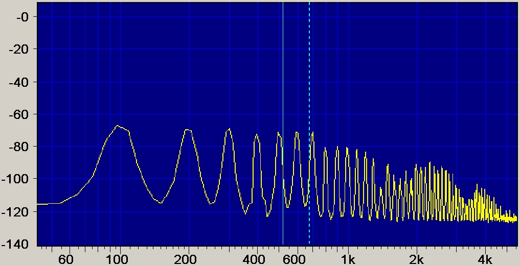

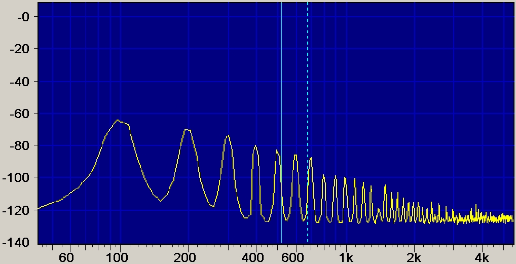

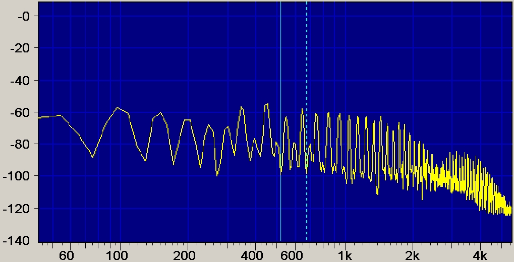

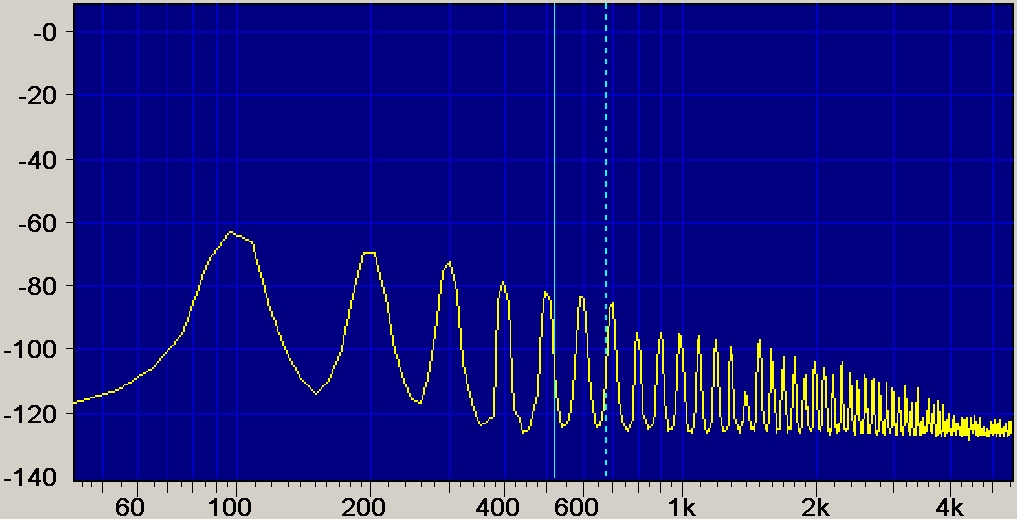

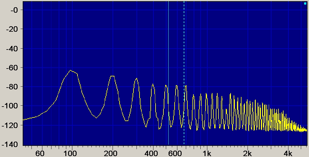

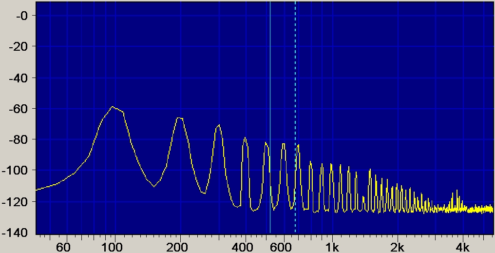

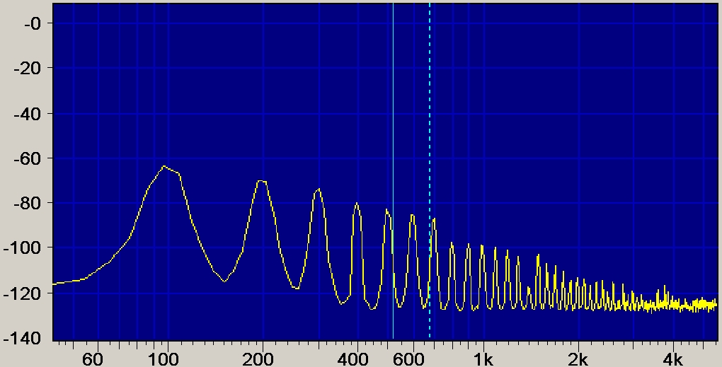

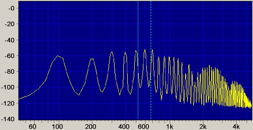

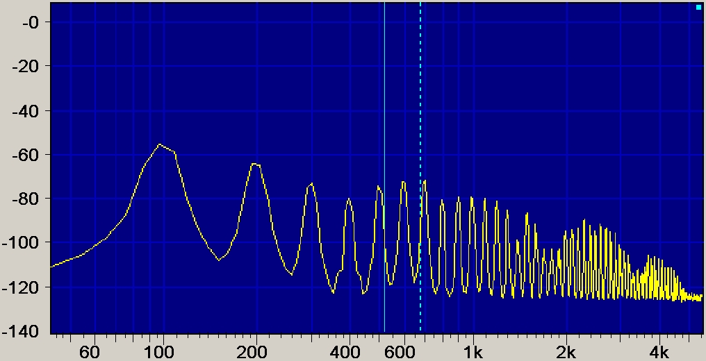

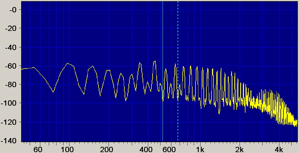

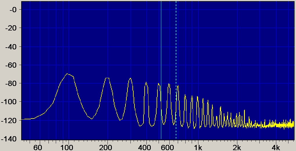

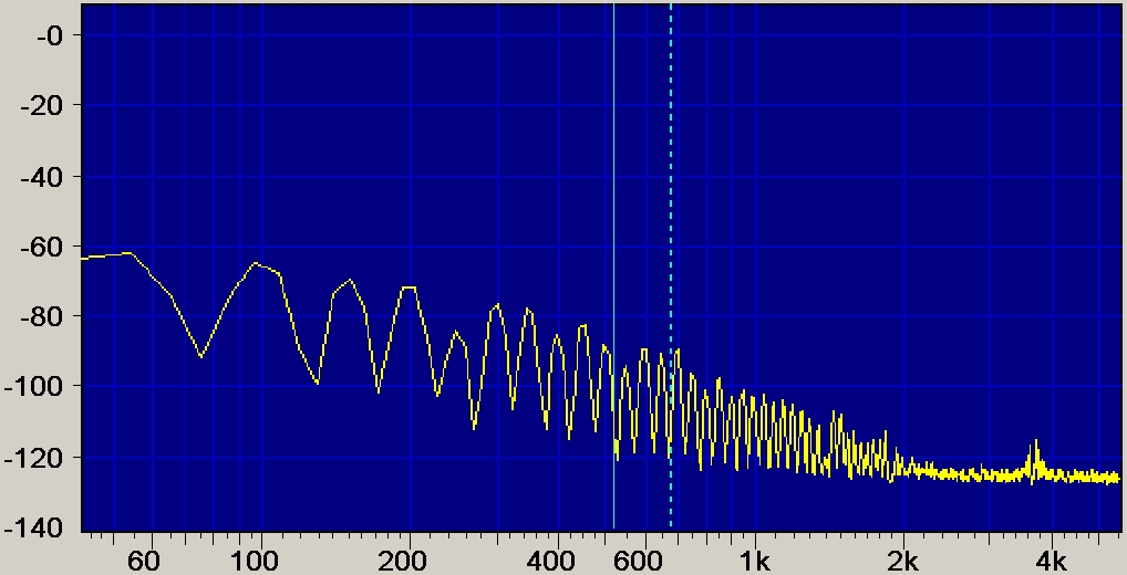

There is a huge difference between a transformer with secondary with central tap using a single rectifier and a transformer with secondary with separate coils using two rectifiers.
In the first case, the charge pulses of the capacitors flow through the cable to the central tap, generating pollution at the amplifier reference.
In the second case, the charge pulses of the capacitors do not pollute the reference, if the cooper layout is properly designed (star connection).
I have done a thorough work on this.
Multisim 14, LabView tools and Daqarta functions were used to visualize the advantages. Filter asymmetries were analyzed as well as asymmetries of voltages between secondary windings.

Diego! Amazing! Sadly I am limited by Google translate and I can see none of the circuits.
Could you please re-post here the dual-rectifier circuit that you found to be quietest, so that it can be shared more widely?

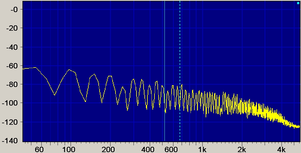

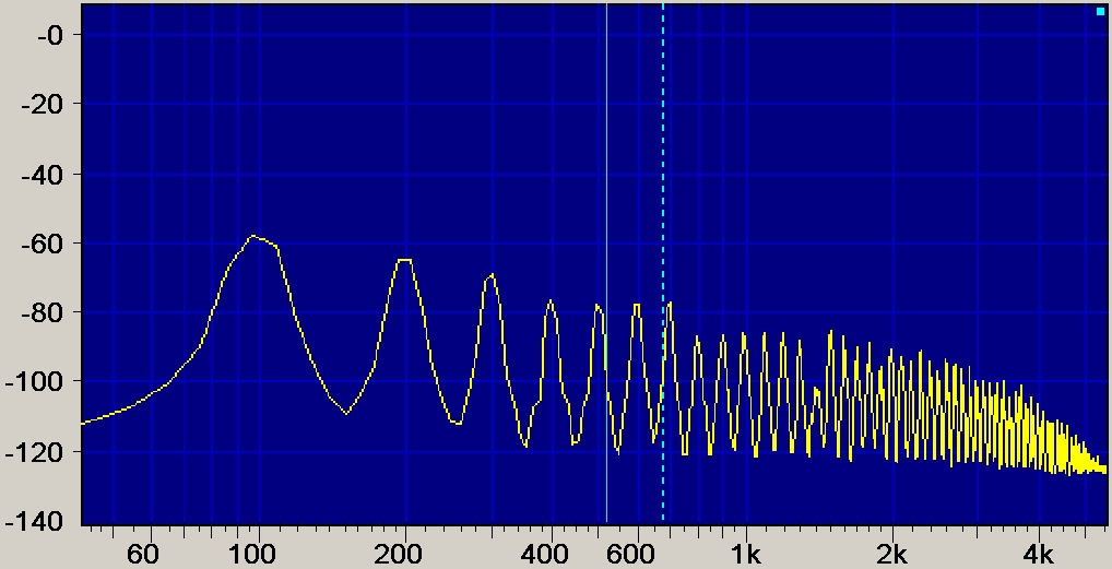

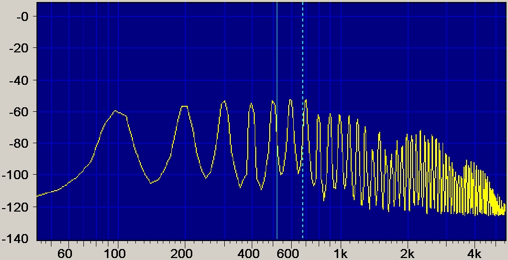

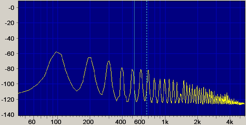

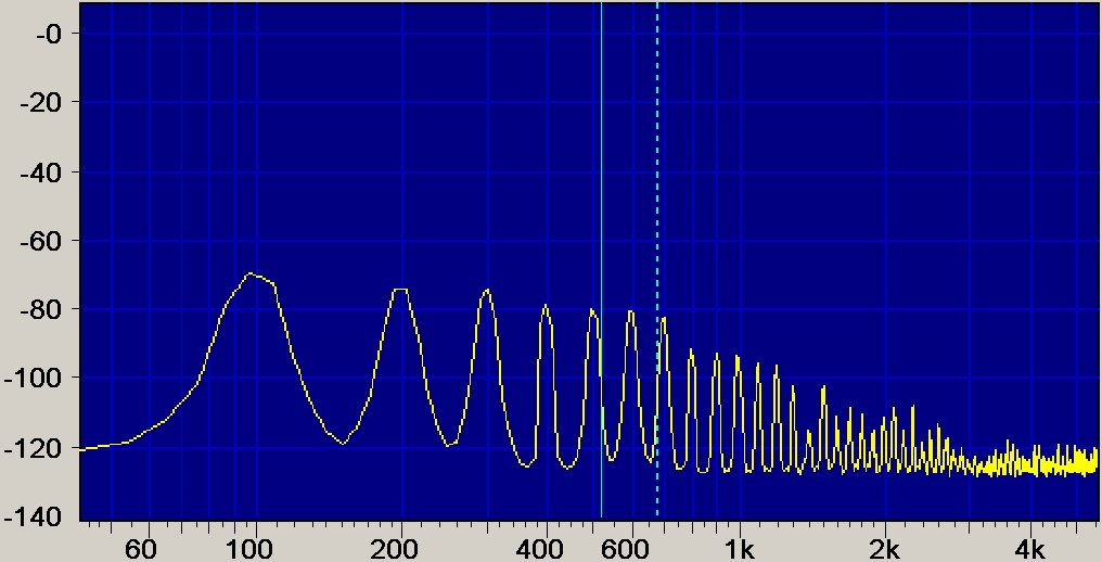

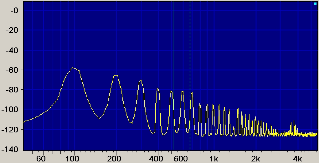

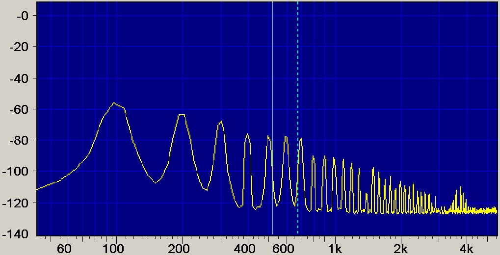

If you give me a little time, I could readapt that work to English. In that work, there are links to .wav files of how you would hear disturbances in a simple test amplifier.
There are also links of the spectrum images of these noises.
As soon as I can, I'll upload it.
Regards
Regards
PD: unzip "Diferencias entre fuentes de alimentación.zip" and open "Silencio2.doc". Read carefully. Open audio file and play the .wav files in the indicated sequence. Later, open image file in the indicates sequence.

Diego, unless you at least compare one of the simulation outcomes with a real measurement then all your sim results are just that - sim results - with no verification.
There is also a lot to be gained in experience and appreciation of parasitic values by setting up a real, but simple circuit, and then tuning a simulation to get good correlation between waveform/spectrum results.
Once a simple circuit is well simulated, then any supplementary results based on, for example, parasitic value changes, can be easily simulated (as some changes can be onerous to insert without changing other aspects) and with a level of confidence that what they show is valid.
