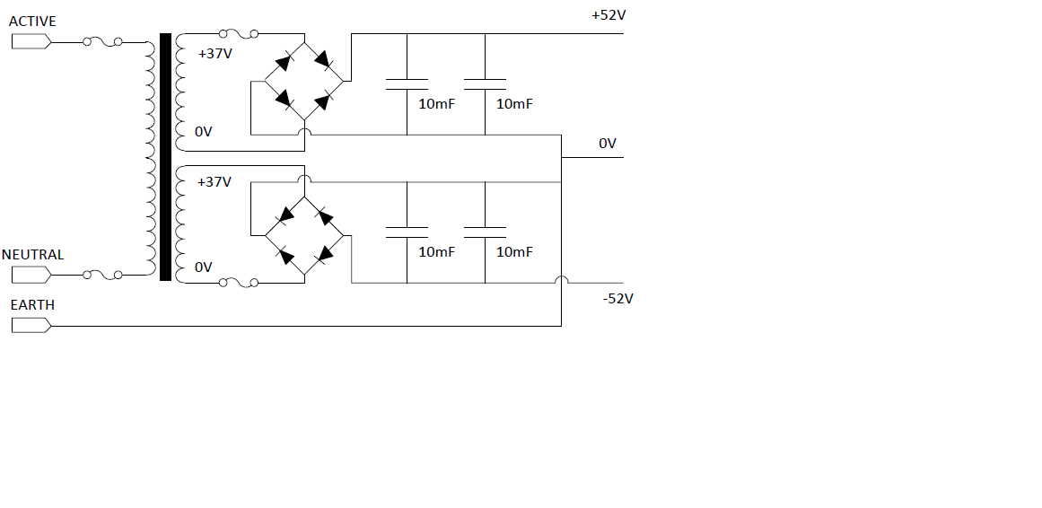

Hi Andrew & other knowledgeable folks,
Did I fix the problem? Are the attached circuits correct?
Thx! Pops.

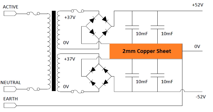

I planned to use a 2mm copper bus plate to link all 8 capacitors (from both channels) to GND as shown for one channel in the attached png file.

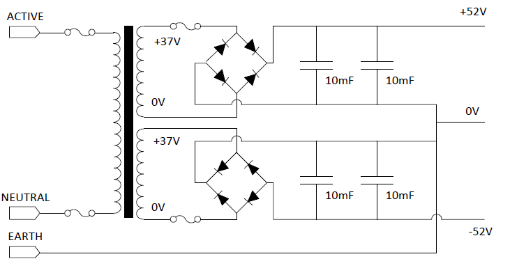

See plan attached (showing only single bridge per channnel). If dual-bridge configuration is better, then I need to find space for 4x integrated bridges on the bus-plate, which also serves as heatsink.
For symmetry I assumed a single GND connection would be in the centre of the bus-plate between the rectifiers (which are electrically isolated). From previous comments, it sounds like the rectifier 0V reference connection should be made at the other end of the bus - away from the Earth/GND. Or is the relative location of the rectifier & Earth/GND connection to such a lump of copper quite insensitive?
Thanks in advance. Pops.
The rectifier connections are not for the purpose of establishing a reference voltage, but for the purpose of providing a path for charging current.popchops said:From previous comments, it sounds like the rectifier 0V reference connection should be made at the other end of the bus - away from the Earth/GND.
Only if you can find superconducting copper. All other copper has resistance, so develops voltage when current flows.popchops said:Or is the relative location of the rectifier & Earth/GND connection to such a lump of copper quite insensitive?

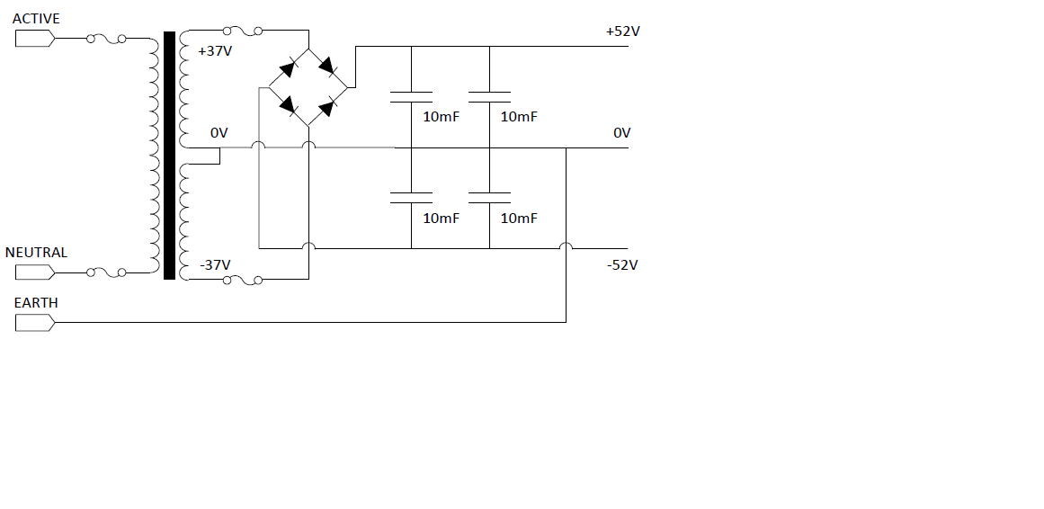

In my circuit, the charging loop for both + and - rail involves the 0V line. Is this correct or is this a mistake in the dual-bridge config? This is the question.
I can see that in the single rectifier config, the charging loop goes from pos rail to neg rail and back to the rectifier without touching GND (?). This cannot be so for the dual bridge where each pos/neg rail is isolated with separate rectifier. Where is the current return? 0V? Need to minimise resistance here with a bus bar to get maximum filtering effect hence the copper.
The 0V line is what emerges from the PSU at the clean end. Within the PSU you have charging pulses so what you call the '0V line' will not be at 0V with respect to the clean end. It probably does not matter too much whether you have a single '0V' bus or two joined at the clean end. If I were using two bridges I would probably use two '0V' lines.popchops said:In my circuit, the charging loop for both + and - rail involves the 0V line. Is this correct or is this a mistake in the dual-bridge config? This is the question.
In the single bridge version, the CT connection carries charging pulses too whenever the two polarities take different currents - which will be almost always.I can see that in the single rectifier config, the charging loop goes from pos rail to neg rail and back to the rectifier without touching GND (?). This cannot be so for the dual bridge where each pos/neg rail is isolated with separate rectifier. Where is the current return? 0V? Need to minimise resistance here with a bus bar to get maximum filtering effect hence the copper.
No need to minimise resistance (within reason). Much more important to connect things in the right order. Wire or normal PCB trace is fine.

popchops, does your toroid PT have two separable wires coming from the secondary CT, or is the CT just one external wire with no way to internally separate (standard core transformers would typically bring the two internal winding wires to an exposed terminal, where it may be possible to separate them).
If you had two 'CT' wires available, then you could use a single bridge, and gain better charging current separation, by taking each separate CT wire directly to its related capacitor pad, as that would then effectively isolate those highest charging current pulses to just the first filter cap, and not to the common 0V ground plane that you are likely to use.

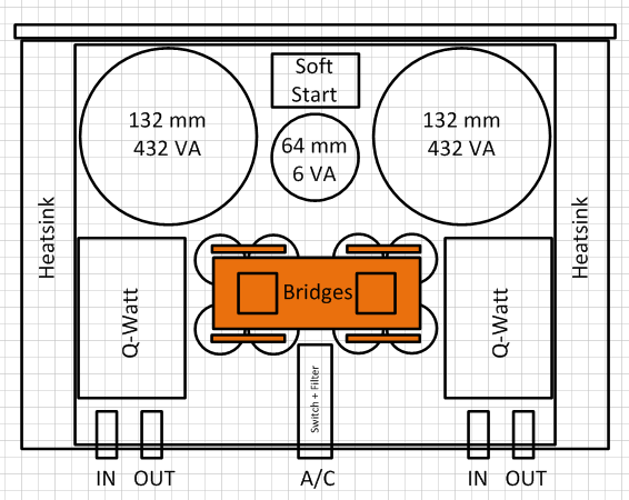

Hmmm I planned that each transformer would have 2x primary wires (0-240V) and four secondary wires (2x 0-37V). What is PT/CT?
I can't visualise what you mean. Are you just suggesting to ditch the copper ground plane? I'm open to that idea. Will definitely save space. Do you really mean 1 bridge per transformer?
Please please... take a moment to sketch what you are proposing. Sounds like it's worth understanding.

Hi Pops, two mono amps in one chassis. It is all in the detail. Build two mono amps, each with its own transformer and power supply. Connect each amp GND to the chassis using a ground loop breaker and connect PE to chassis.
Hi Mark! Yep I have one and a half Elektor Q-Watts. You say connect to chassis... is it correct that all GND connections should converge in one place? Is this star grounding? Is a ground loop breaker just a pair of diodes babk to back with a small capacitor parallel?
Please sketch if you have 5 mins... for me and all the other noobs. Cheers!

I hardwire the rectifier circuit. The transformer to rectifier to first smoothing capacitor is the current charging circuit. That circuit passes charging current for ~10% duty cycle and must of necessity pass current peaks that exceed 6times the rms current seen at the load. If we add on a second stage of smoothing, then the current flows on a slightly longer duty cycle and the peaks are a bit lower when only 10milli-ohms of wire resistance intervene. More resistance (thinner wire) stretches the duty cycle and lowers the peak current.I can't visualise what you mean. Are you just suggesting to ditch the copper ground plane? I'm open to that idea. Will definitely save space. Do you really mean 1 bridge per transformer?
for a dual secondary I suggest you charge each smoothing cap bank from it's own rectifier. Then combine the outputs of multiple banks at the end most remote from the transformer.Please please... take a moment to sketch what you are proposing. Sounds like it's worth understanding.

I disagree.Hi Mark! Yep I have one and a half Elektor Q-Watts. You say connect to chassis... is it correct that all GND connections should converge in one place? Is this star grounding?
The star ground (I use the phrase Main Audio Ground (MAG)) is where all the separate circuits that need a common voltage reference converge. This star should not be part of other two wire circuit interconnections.
Resolve ALL the intermodule two wire interconnections first. Keep the current in one circuit SEPARATE from the current in other circuits.
When all the intermodule two wire connection are complete, then return to your schematic and find which voltage referencing connections are missing. Add in those missing connections.
The Main audio Ground is part of the audio system and is required to allow the amplifier to work. The amplifier does not need an enclosure/chassis to operate.Is a ground loop breaker just a pair of diodes babk to back with a small capacitor parallel?

One '0V' line connects the positive bridge to the negative ends of the positive supply caps; the other connects the other bridge to the positive ends of the negative supply caps. These two lines join at the PSU output. This arrangement keeps charging pulses for one polarity out of the PSU ground bus for the other polarity. Not a great advantage, but does no harm.popchops said:How can you use two 0V lines? Each mono amp only needs -V, 0 and +V.
Rectifier - reservoir cap - any other caps - PSU output - chassis (if appropriate)What is the right order?
