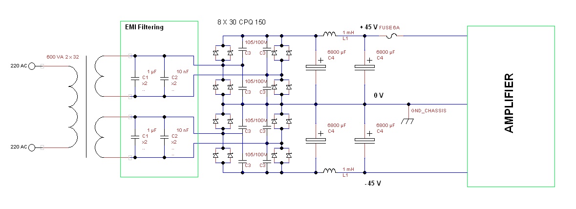

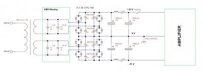

I found a guy who winds transformers to order. I have not yet ordered the main pair because I want to get one half of the PS up and running with an ancient ILP dual 35V toroid that I have. Then, when I have measured the losses I will know exactly what AC voltage I need. Probably closer to 40V. This way I can tolerate higher rectification losses if I settle on the dual bridge config. Also need to be sure I get sufficient magin below 63V cap rating... aiming for 57V DC, no load, at 250V supply.
I hardwire the rectifier circuit. The transformer to rectifier to first smoothing capacitor is the current charging circuit. That circuit passes charging current for ~10% duty cycle and must of necessity pass current peaks that exceed 6times the rms current seen at the load. If we add on a second stage of smoothing, then the current flows on a slightly longer duty cycle and the peaks are a bit lower
Very helpful. Initially I will hardwire with 0.8mm wire. This leaves more floor area for 4x rectifiers. I need max 2A RMS on each supply rail. Each screw-terminal cap (Vishay 101) can handle 8.1A ripple at 85deg (2 per rail).
Thanks. Do you think my last dual rectifier circuit is good to go? Hardwired, with dual '0V' lines joined at the output prior to 0V earth connection.

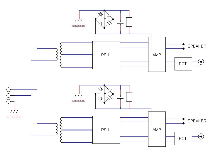

Hi Mark! Yep I have one and a half Elektor Q-Watts. You say connect to chassis... is it correct that all GND connections should converge in one place? Is this star grounding? Is a ground loop breaker just a pair of diodes babk to back with a small capacitor parallel?
Please sketch if you have 5 mins... for me and all the other noobs. Cheers!
Star grounding is where you connect all grounds (read returns) to a single point. It really is impossible to do without having long leads or traces which is in many cases not good.

Where we have multiple channels inside the enclosure, then we find that making these multiple Safety connections can create current loops around which interference can circulate. For these we may obtain better interference performance by using a Disconnecting Network (DN) in the wire link to the enclosure. This DN must be able to pass Fault Current. This is the part that requires a Power Diode in both directions to conduct the Fault Current.
The Diode must survive longer than it takes for the mains fuse to rupture and the arc to extinguish. This is a very onerous condition.

I find I use 4 to 6 bridge rectifiers in each stereo amplifier. Two for the DNs and two or four for the AC to DC rectification.
Yes, I do this to reduce the size of the ground loop. Some even advice grounding the inputs. The problem here is that the thin traces between input and the power connection of the amp may not withstand the high current in the case of a transformer failure.
I connect plus and minus grounds at the amp. See the four leads between PSU and Amp. You don't need to copy this part. Your amp PCB is probably not designed to get best out of such a layout.
Should I have a 10A quick blow fuse on the PS output? Does that take care of the problem? I planned to put slow-blow fuses on the secondary outputs from the transformer (in addition to low current slo-blo on the primary side).
What location / type is best?

remove C3, all of them.
change C2 from a solo capacitor, to a snubber with C+R.
keep C1.
If you want effective EMI filtering of the mains supply interference, then place that at the mains side of the transformer.
C2 is a Wima mp3 x2 10nF 250V. What R should I add?
Will place that filter on the mains side. Will there be any real benefit from placing the filter on both side of the Transformer?
Also if I place that on e mains side should I rather use a 400v cap or 250 will be sufficient. I have an average of 230 in my mains.
