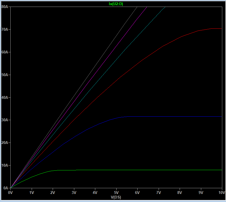

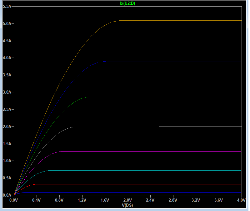

Joined 2009
It doesn't look all that triode-like to me
Also not very physically real, looks like level 1 model with no Vds modulation of drain current at all. Doesn't even remotely match the DS which shows almost pure triode behavior below 5V Vds.
Indeed, replicating the datasheet Fig. 2 conditions, with Vgs stepped from 2V to -8V yields dissimilar curves. Maybe I am doing something wrong as the manufacturer's spice model seems quite detailed.
At least, for once reality seems better than simulation , and this raises my hopes again!
Another problem with the DS is that it shows curves going to 40A and 10V = 400W like it was no problem.
I don't think this a problem as the datasheet does not claim that this is continuously dissipated power. I would think that 40A and higher are within the pulsed capabilities of the device. SOA is also stated.
I see nothing wrong with the datasheet.
