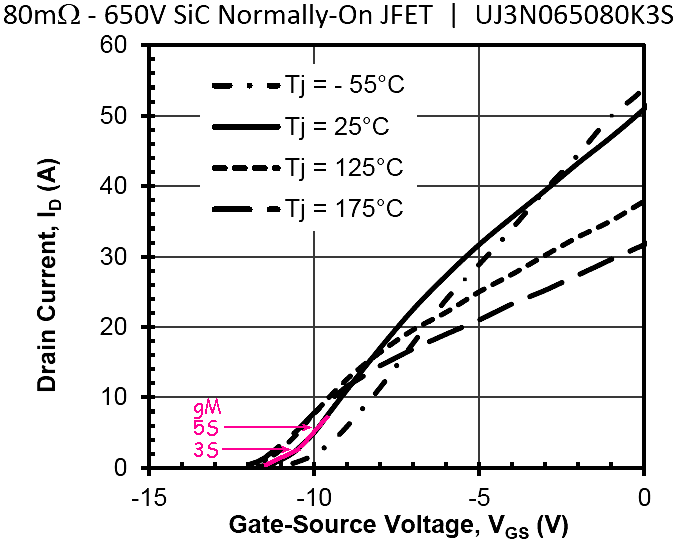

yeah ..... but we are always looking what's transfer characteristic like in 20-30Vdc and ~2Adc region...
Yes; actually the 0.1A-2.5A zone for class B to class A, with peaks to 5A or 10A.
https://www.mouser.com/datasheet/2/827/UNITED_SILICON-10-03-2018-UJ3N065080K3S-1487513.pdf
Vto (for 20mA!) is -6V to -14V! Whereas in a MOSFET amp we must drive the upper gate ~~5V above the upper supply rail, for these depletion devices we must drive the upper gate a dozen volts *below* the lower supply rail. We may sometimes overlook the 5V offset of a MOSFET; this dozen-Volt offset kinda demands boosted rails for the driver.
The large negative bias for linear zone "does remind us" of vacuum tubes. But the likely signal swing is very much less than a tube. The transconductance looks like 3S to 5S, a tube would be like 0.005S.
We always like to run power amps as "Cathode Followers" if we can swing the drive. 3S of gM is like 0.3 Ohms which promises good gain and linearity into 8 Ohm loads. But the over-the-rails gate swing is awkward.
The gate capacitance does not look that brutal to me. Many MOSFETs are similar. Many BJTs effectively have large base capacitance due to hFE fall-off above the audio band. There is a fundamental limit here and I think many recent devices approach that limit, in their several ways.

80mΩ - 650V SiC Normally-On JFET
https://www.mouser.es/datasheet/2/827/UNITED_SILICON-10-03-2018-UJ3N065080K3S-1487513.pdf
They're definitely not depletion MOSFETs.
As for "normally on" being risky, I'm not sure I see why. People already use small JFETs to drive other power devices. And somebody correct me if I'm wrong, but don't those things conduct less the hotter they get?

Just received four of these from Mouser. I am thinking of going for a ciclotron. As has been mentioned, an extra, or possibly two supplies are indeed required for the bias, and these must ramp up before the bridge voltages.
Using the manufacturers' spice model, open-loop damping factor calculates around 10 for the 2x24V rails ciclotron, biased at 2.5A or therabouts. I wonder if this will be any good driving conventional two-way medium to lowish sensitivity speakers, such as my proacs, limited to moderate levels of course.

Spice simulated SIT vs MOSFET: 0-1
Details:
Devices: UJ3N065080K3S vs IRFP240
Spice models: SIT: UnitedSIC provided / MOSFET: LTSpice standard
Iq: 2.5A both
Topology: Common-drain ciclotron
Load: 8 Ohms resistive
Rails: 24V x2
Po = 5.5W & 20W (two tests)
Results:
The mosfet circuit wins due to lower harmonic power, by 5dB to 15dB depending on harmonic, all the way from the 2nd to the 19th.
Only in the lower power test does the SIT win only at the higher harmonics. In the higher power test, MOS is better throughout.
But, let us not despair as HD is not easy to model in spice. I guess it is measurement time.

The UJ3N065080K3S is a SIC JFET, not a SIT.Spice simulated SIT vs MOSFET: 0-1
Details:
Maybe not the same device category name, but according to wikipedia "The SIT is a type of JFET with a short channel length."
Plus the Semisouth SJDP120R085, widely regarded as a SIT in this forum, is termed "Trench Silicon Carbide Power JFET" in the datasheet, plus its transfer characteristics are wickedly close to those of the UnitedSIC's device.
Those here who have delved into such devices can perhaps comment on similarities and differences. Me, I am happy with the UJ3N06580 transfer characteristics
