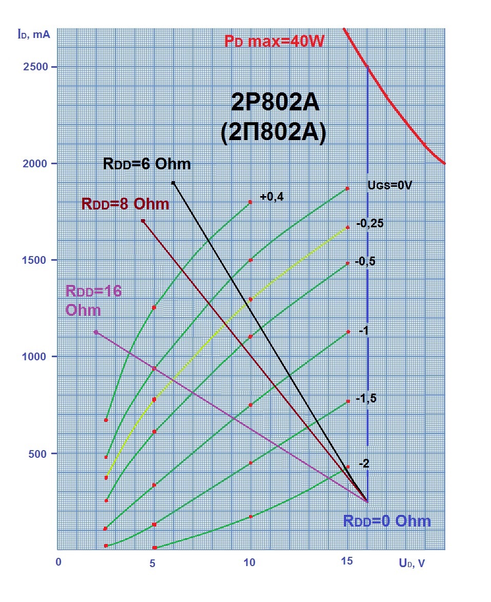

...The main idea was to run them in the resistive region where they were very linear.
In the resistive part of the usual JFET have a narrow working area. Which is inconvenient.
This zone is the transition from triode to pentode output characteristics. It is much better to use JFET - SIT in the same transition zone. From triode to pentode.
This will lead to the best interaction of the amplifier with the complex nature of the load. The attachment is an example of such a solution.
Pentods "liked" loads an of magnitude below their internal resistance. Triodes - on the contrary. The best will be the "ultra - linear" inclusion.
