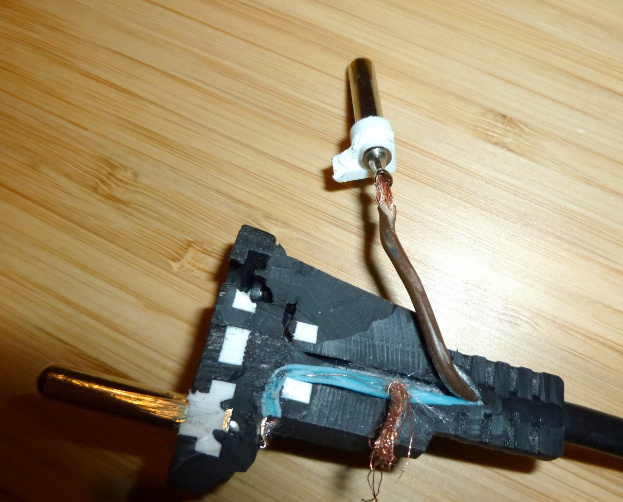

These cords are an affordable upgrade to the normal black IEC cords that audio companies include with their equipment. I like the clear plugs so that you can see how the wire is bonded to the prongs. I hope that we can all agree that low resistance in a power cord is a requirement of a good cord. In the normal free black cords the wire is just placed across the prongs and the only thing holding it there is the force of the molded black plastic.
I’m in total disbelief that someone with allegedly technical background can repeat such marketing BS. What is the reason you are flooding thread with marketing links instead of qualified opinion or performed measurements?
Wires are crimped to connector prongs!
How would a wire just placed on the prong, allow 16A current and conform with regulations?
Moulded power cords are not necessarily the work of the devil. 😈
The moulding process involves a great deal of pressure to force material into a mould cavity, and is said to mechanically attach the connectors to the cables in a way that ensures strength.
Regardless of price, power cords used in the UK must conform to British Standard BS 1363, and an approved mark must be moulded into the 13 amp mains plug.
I have cut plus open and seen what is inside that is how. I have also had plugs on high current equipment like a vacuum get hot and then cut the plugs off and installed a aftermarket plug from the hardware store with screws that hold the wire and the plug was now cool. This is first hand by me, not marketing!I’m in total disbelief that someone with allegedly technical background can repeat such marketing BS. What is the reason you are flooding thread with marketing links instead of qualified opinion or performed measurements?
Why not cut another plug open and let the rest of us see what you saw?
The power cords to which you refer are "free" after all.
But, no, you'll simply tell us to do it for ourselves! 😉

I don’t have to be told. 😛But, no, you'll simply tell us to do it for ourselves! 😉
You’ll excuse rough cut but I was in no mood for artistically better.
It is clearly visible that wire is crimped.
Now, your pictures please or it didn’t happen. 🙂I have cut plus open and seen what is inside that is how.
True. A proper crimp is gas tight. A test is to try to pull the wire out of the crimp. The wire should break before it can be pulled out of the crimp.Wires are crimped to connector prongs...
Now, its also true that crimped dissimilar metals, particularly in the presence of surface contamination, can potentially generate excess noise and or exhibit nonlinearity.
Apples and oranges, I cut open American plugs. I have seen so many USA plastic plugs overheat, I just throw then away so I do not have any to show you. Screw clamp plugs are great! Glad you are happy with your stock power cords.I don’t have to be told. 😛
Stock power cables in EU are much better than what’s on the picture. That was a free one coming along with some very low power electric appliance.
After seeing your picture tombo56 I believe that EU cords are better than USA cords. Thanks for cutting that one open and posting the picture of it.
