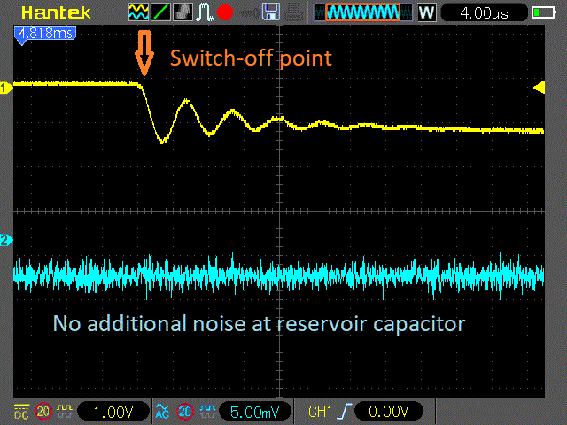

I have doubts about need for snubbers. Yes, ringing is there. However, I have a hard time to find any additional noise caused by rectifiers, even at first reservoir capacitor. Here is an example with PS used previously in this thread. It has fast rectifiers, in fact MOSFETs and LT4320 control circuit, 15V output and 2A load.
With no snubber, ringing frequency is about 167 kHz and about 1 Vpp. However, nothing is visible at first PS capacitor. Ringing appears after rectifier diodes switch-off, isolating primary from rest of the PS, so any noise can enter only through small rectifier diode junction capacitance, and it is absorbed by first reservoir capacitor. MOSFETs used here have larger parasitic capacitance than plain diodes.
I have PS circuits with properly adjusted snubbers, using Quasimodo, but I start to ask myself is there any real benefit.

How much of that ringing is electromagnetically coupled to the audio circuitry? In other words, not by conduction from the terminals of the reservoir capacitor. I think you'd need to use a current probe to measure that.
But, if you're happy saving the pennies that snubbers cost, go for it!
Maybe it could be put it this way: If you try snubbers does it help the sound at all? If not, then maybe you don't need them, or maybe you have bigger problems to work on first. No offense intended, of course. Its just that sometimes Murphy can get you 🙂

Apparently, nothing. There isn’t much energy in that ringing.How much of that ringing is electromagnetically coupled to the audio circuitry? In other words, not by conduction from the terminals of the reservoir capacitor. I think you'd need to use a current probe to measure that.

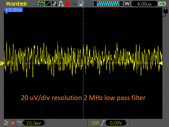

Here is output of amplifier attached to that PS. 60 dB/1 MHz bandwidth LNA was used in front of oscilloscope, so it is 20 uV/div resolution.

It’s not a matter of saving but a legitimate question.
As I suggested, I think you may need to use a current probe on the wiring of the amplifier section proper. It sure could be that your amplifier embodiment doesn't have anything bad coupled to it. If that's the case, great job, and let us know your secret!Apparently, nothing. There isn’t much energy in that ringing.
