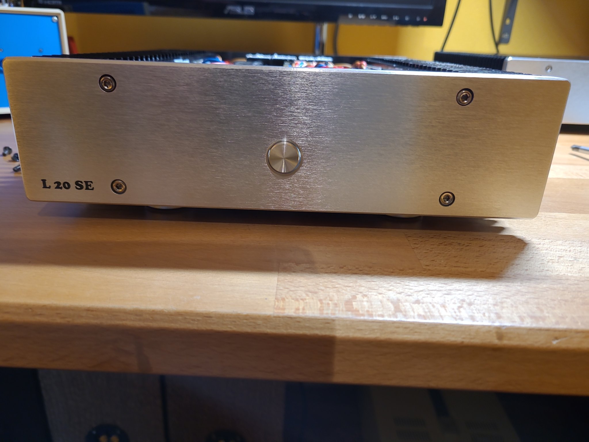

Later i can take a piture of my old L20SE.

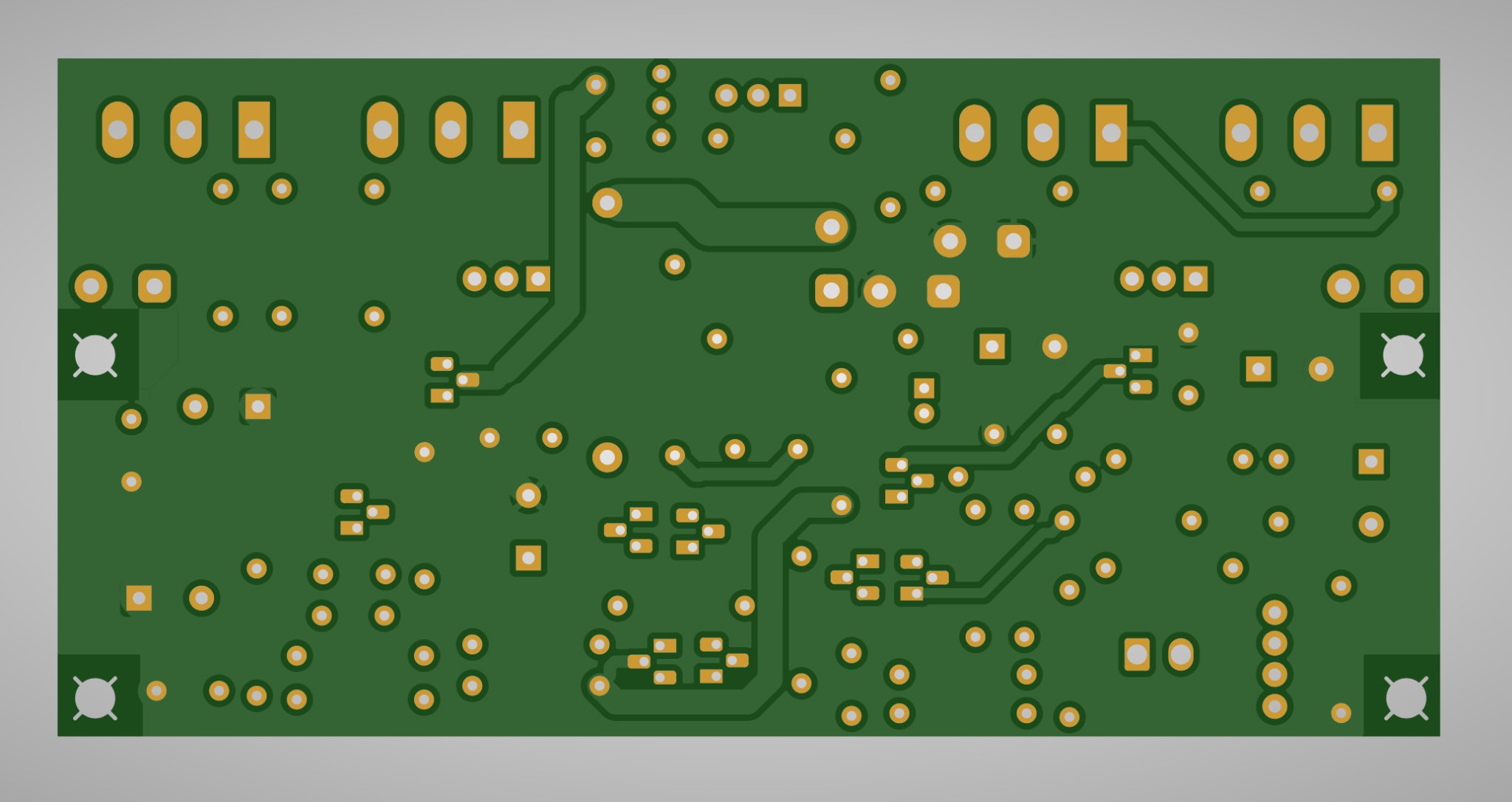

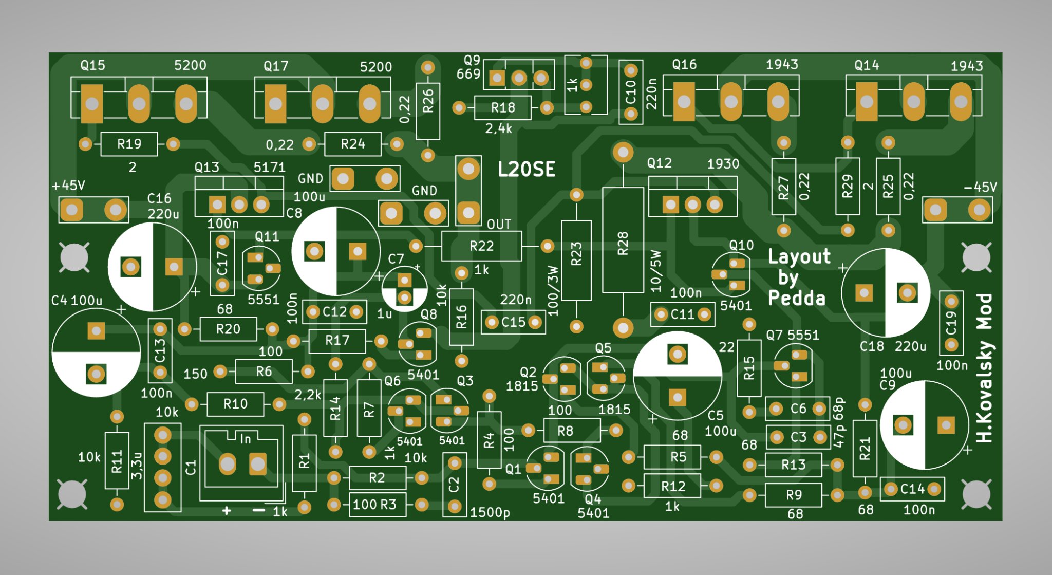

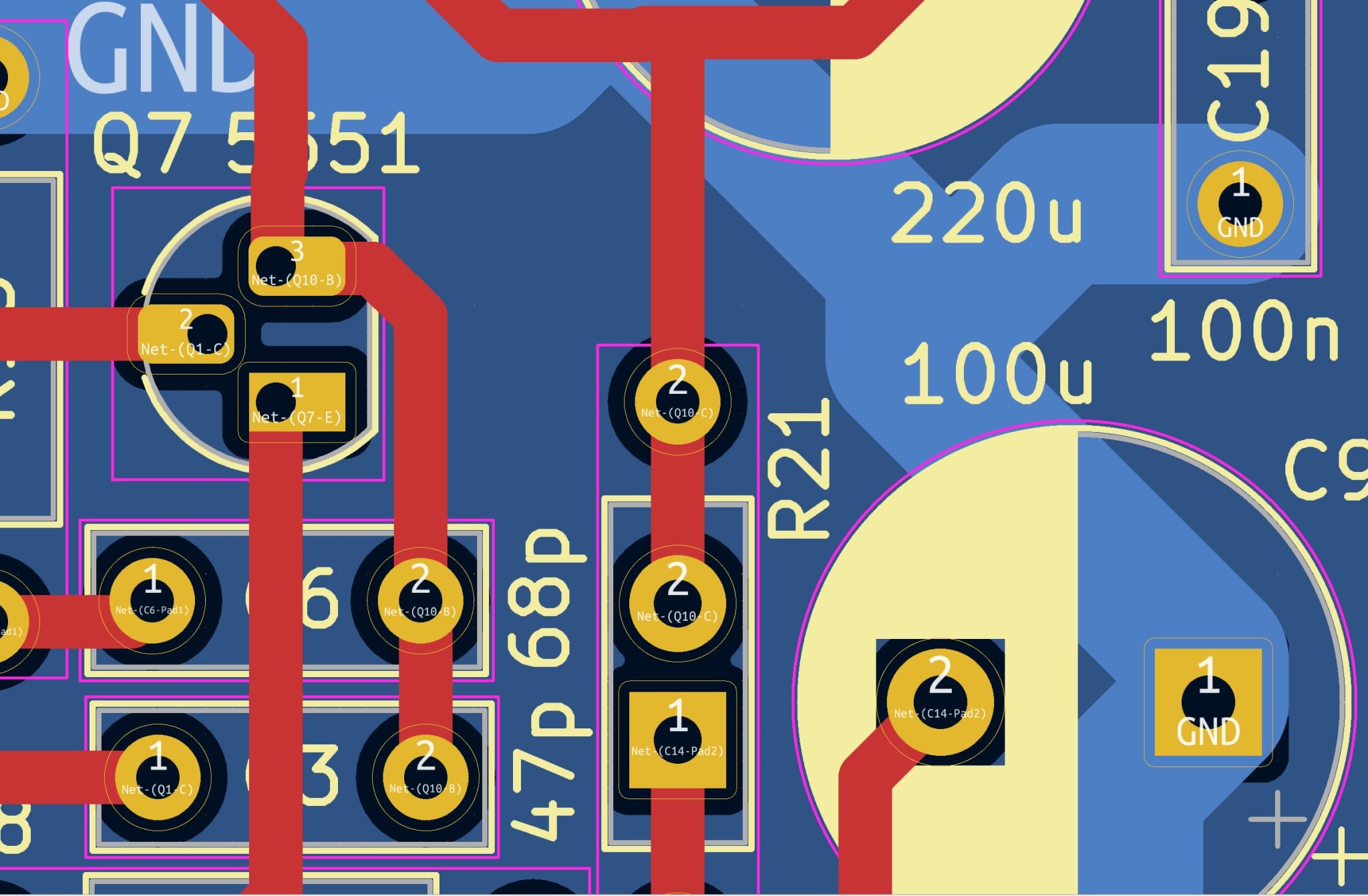

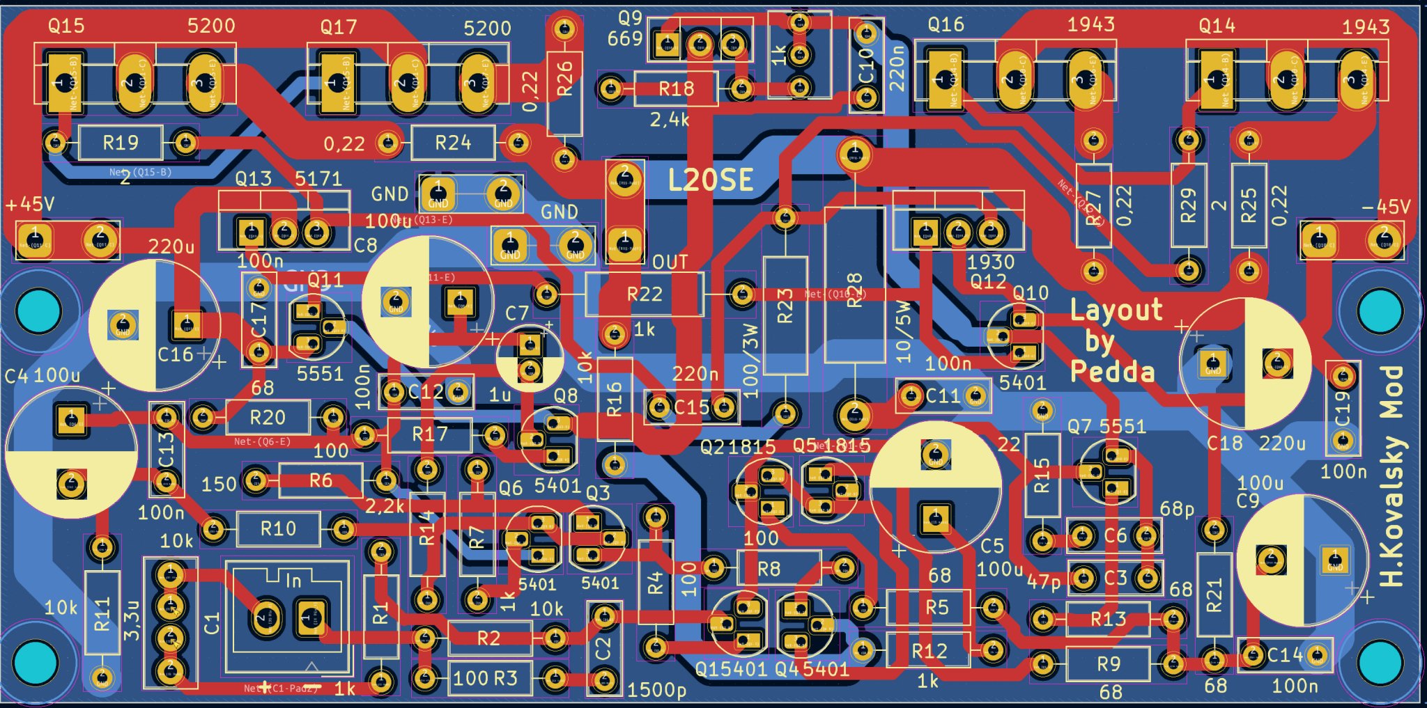

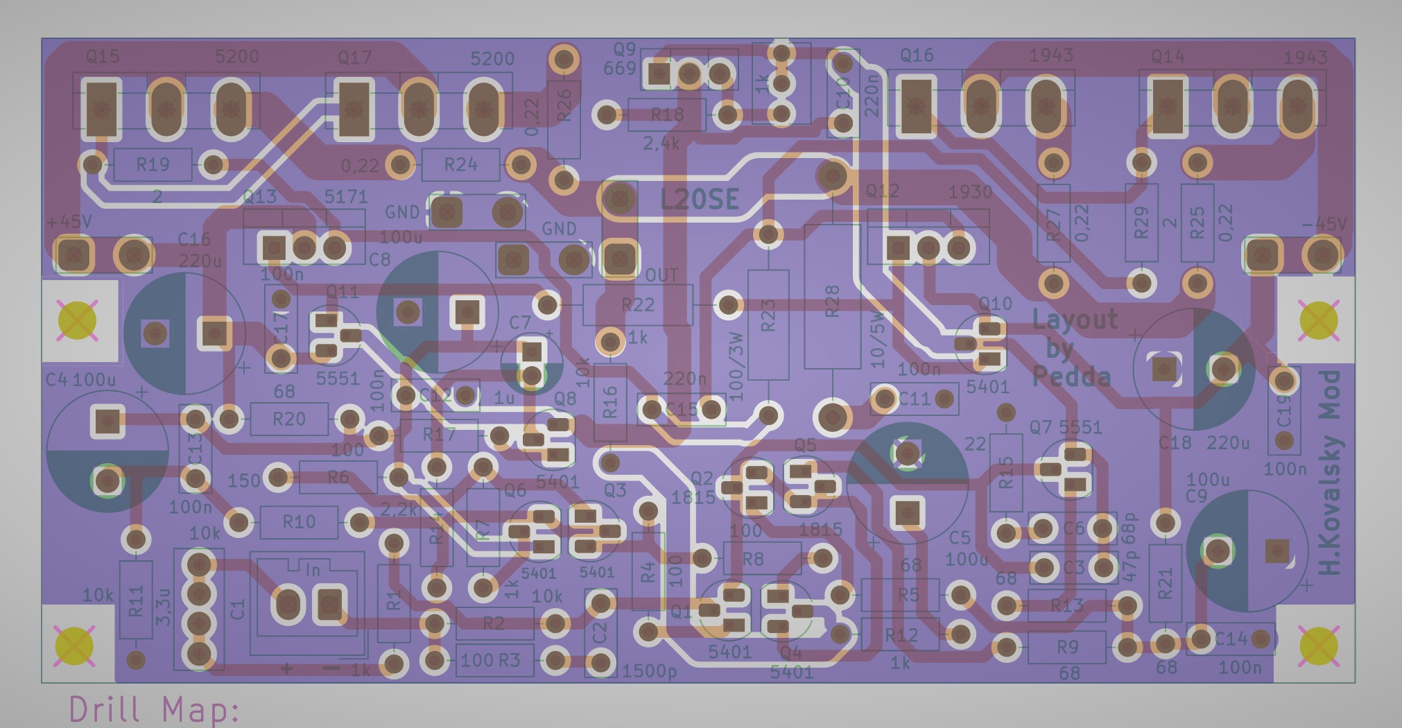

I made a little (last) change. Transistor Q8 and capacitor C7 have moved a bit. The connection to the bias transistor 669 get shorter. Some resistors have moved a little bit to get space to make the changes possible. Give me more days and i will find more to change... 🙂 (no only a joke)
Hennady, thanks for your look. I will make the gerber zip file and give a notice.

Upload zip file for testing..ok...pictures of test
You can get it now sending a pm to me. I have to wait until the kits arrive. Measurement in my amp is not easy enough. Perhaps the holes does not fit exactly to the old ones on the original pcb. If you never built a L20SE before it does not matter.
No guarantee, own risk. I have made the pcb as good as i could...

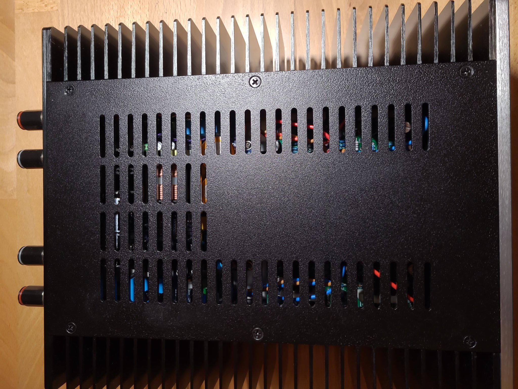

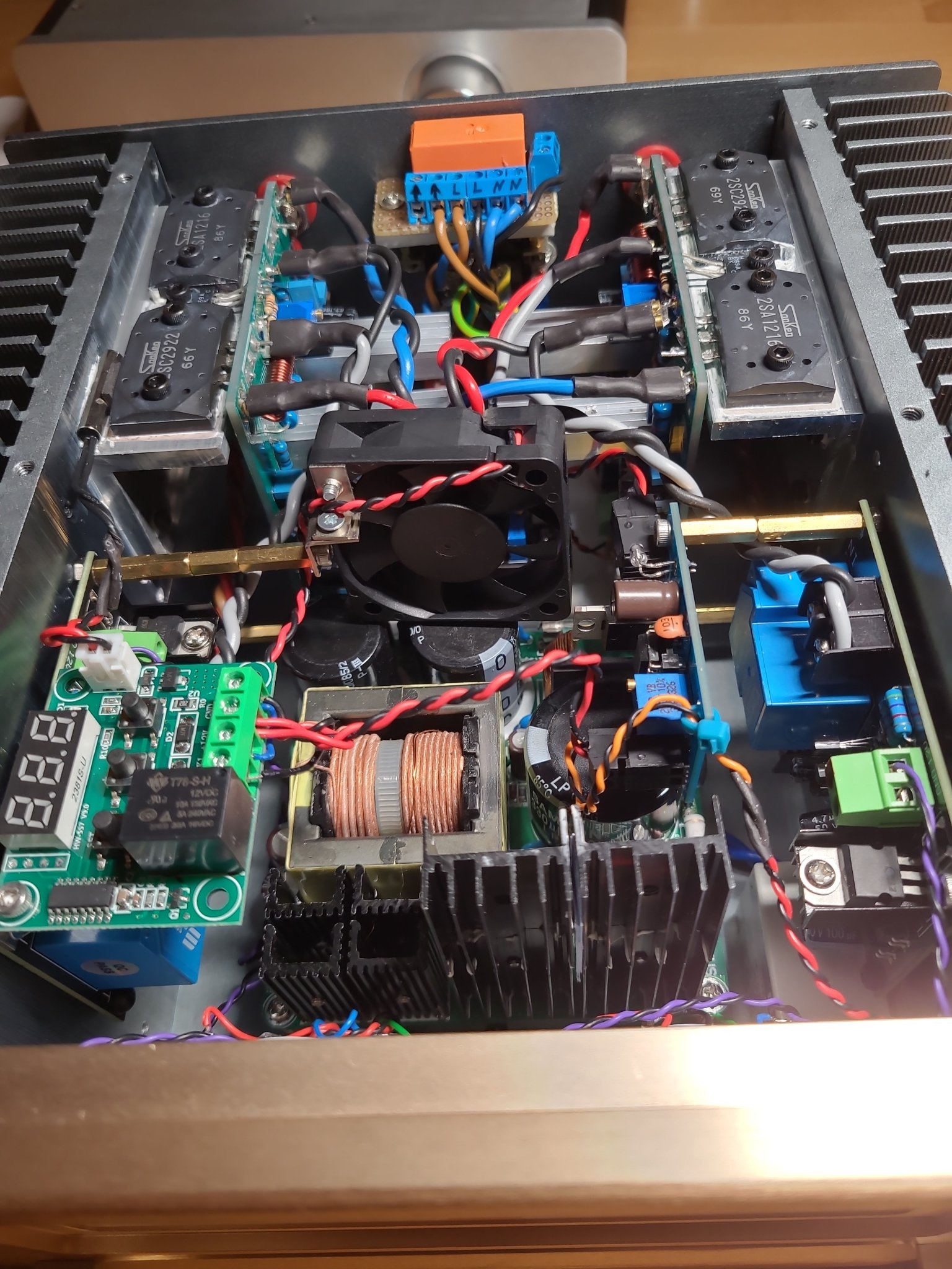

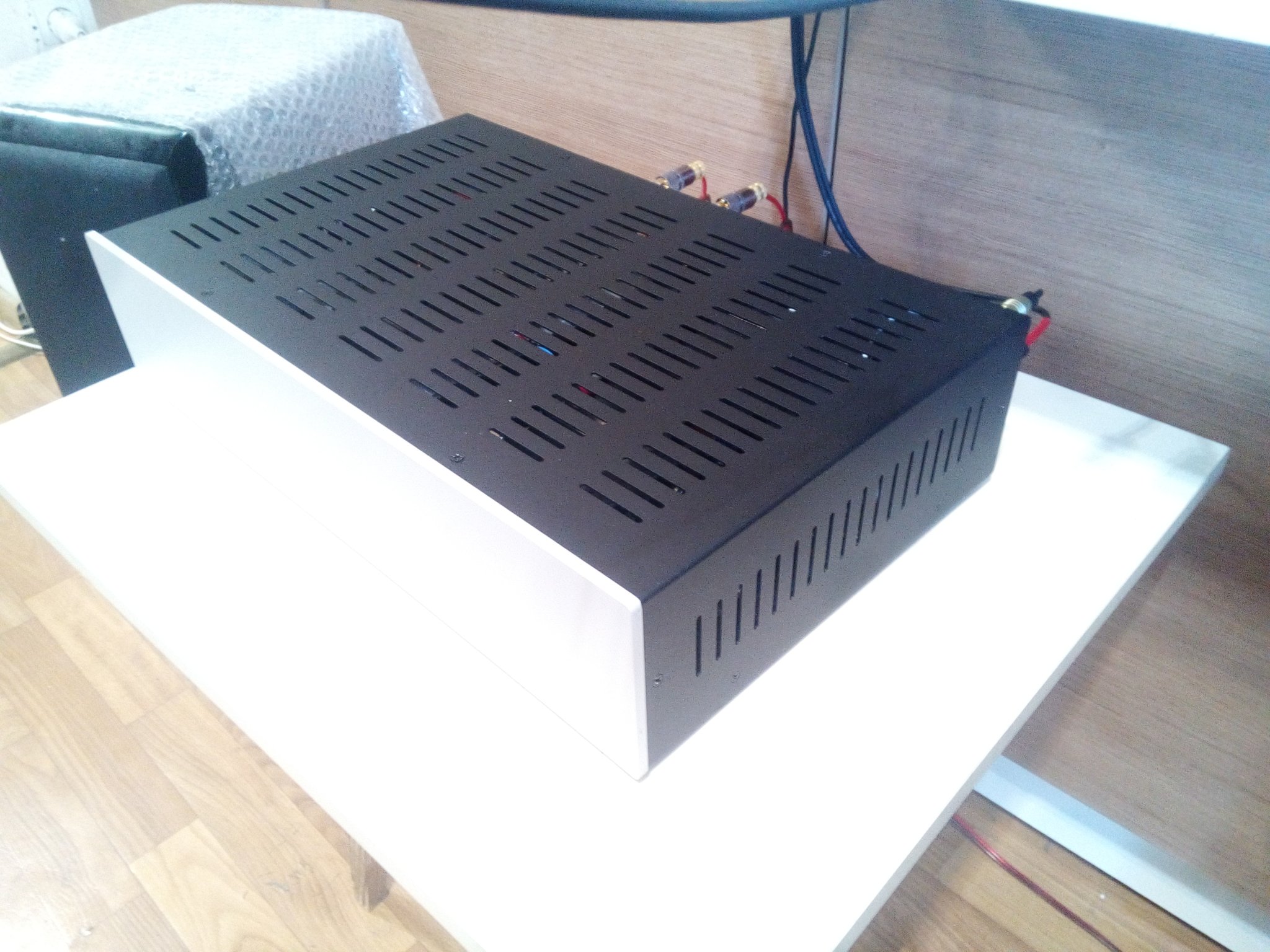

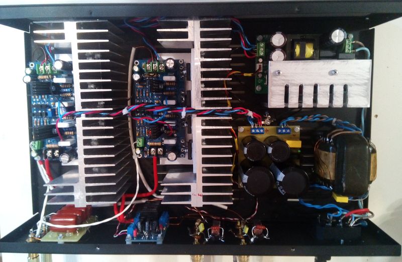

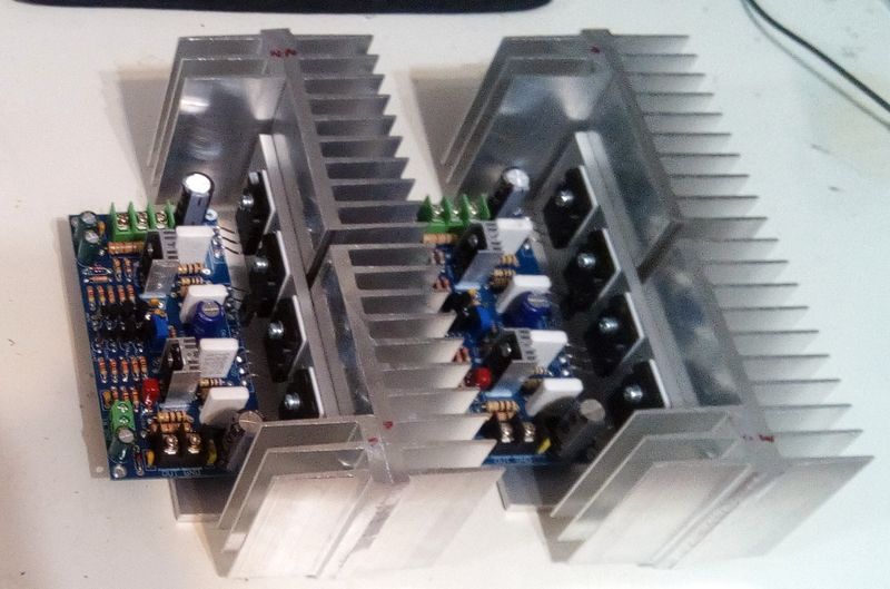

Pictures of my older L20SE

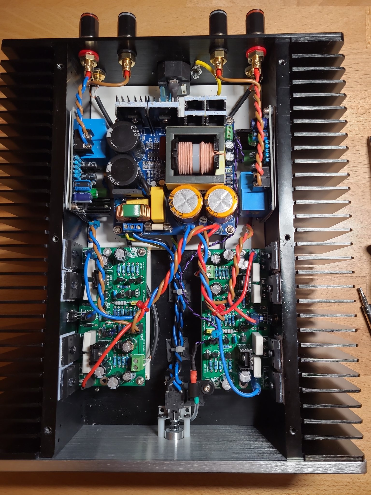

If I may, a few comments on the design.
* when using a switching power supply, it is necessary to ground both the mains supply and the output.
*RCA input terminals must be located nearby in the housing so as not to create a grounding loop between separated inputs,
*in the case of one power supply for two channels, resistors in the input wire need 10 ohm resistors to break the circuit, while at the input terminals GND must be grounded to the case in order to separate the contour gnd of external interconnect wires.
*It is advisable to additionally cover the pulse unit inside the housing with a shielding sheet and reduce the dissipation area of the HF transformer.

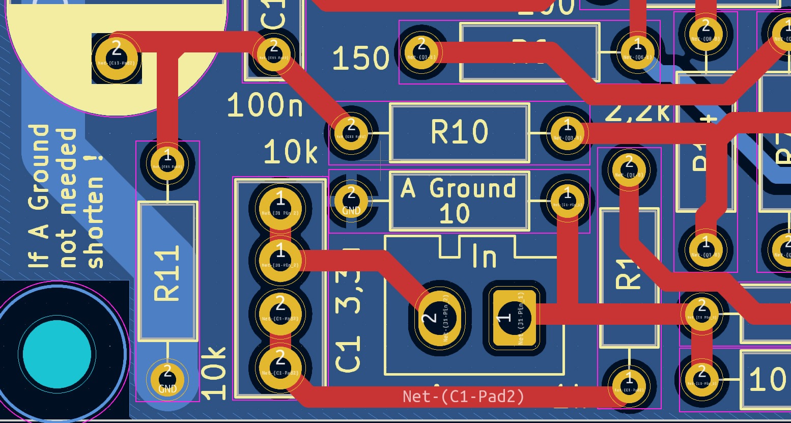

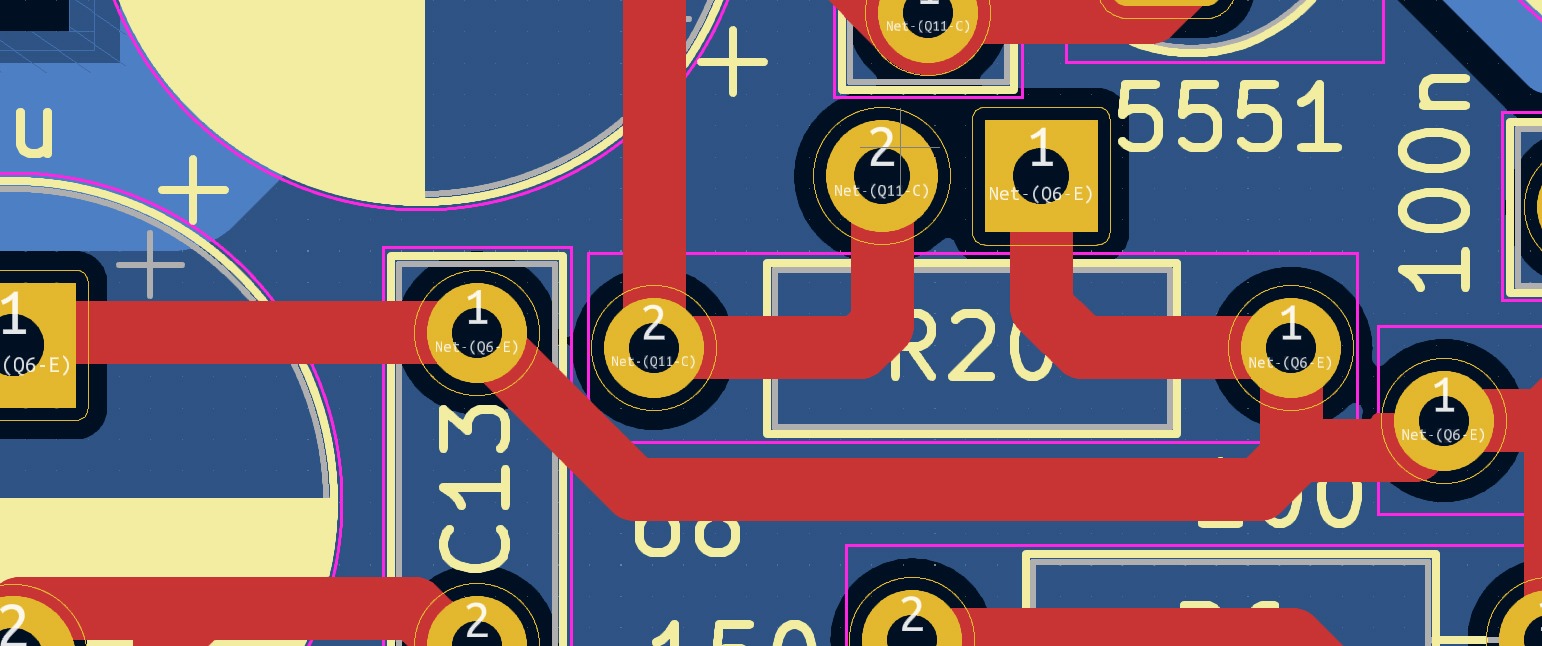

I had found a mistake on my pcb and fixed it. There was no input ground anymore because i deleted A Ground without putting a new Ground to the input. On the fixed pcb is an A Ground and a mark. "If A Ground is not needed short it". Everybody can choose now to use A Ground or even not...

All my amps running with SMPS without grounding exept the 0 voltage. Both pcbs and the negative speakeroutput have the same potential. RCA wiring is short as possible, away from AC voltage. Pcbs are away from AC. Rca is isolated to the housing, speakerterminals too... some little rules i know.

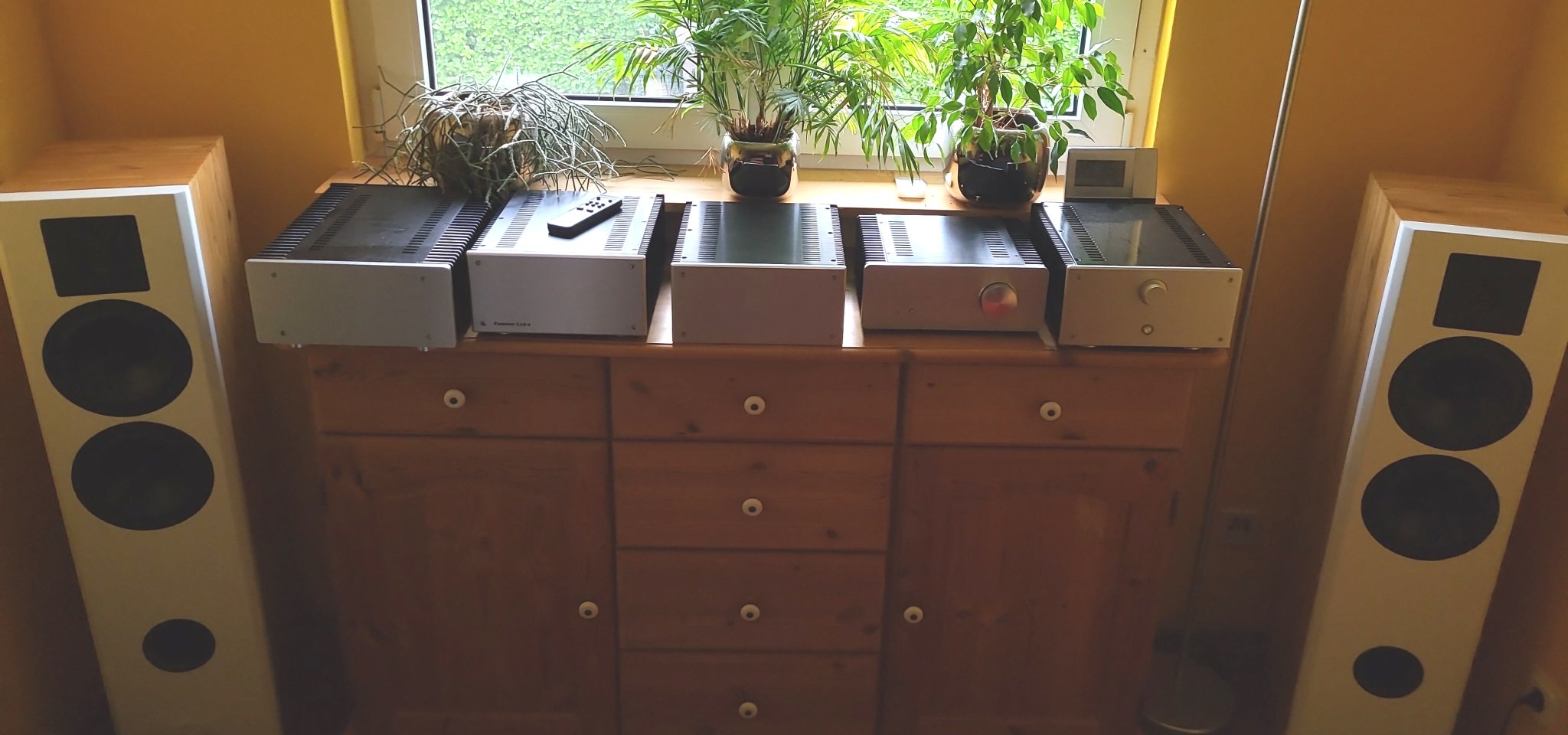

Reactions: Hennady Kovalsky

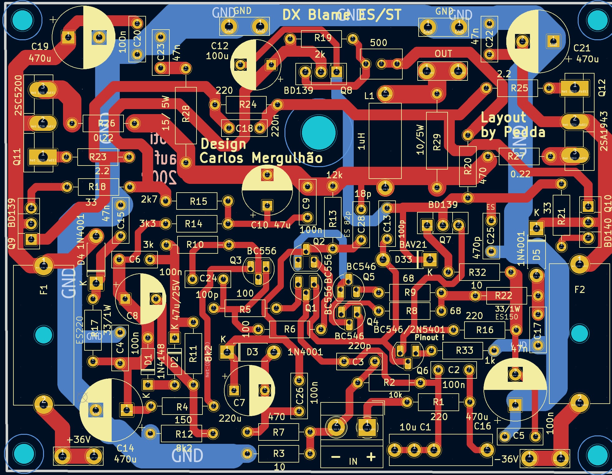

I have another project to complete. I want to build the Blame ST, designed by DestroyerX, Carlos, here in the forum years ago. The MKII Supercharged is very interesting too.
Similar to Apex FX8 and FH9 pcbs i designed a pcb for the Blame Amp. I hope it works...Pcbs are on their way, remaining at customs...
